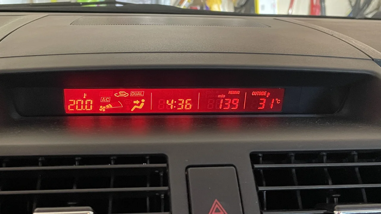

My Mazda CX-9 came from factory with a non-text capable LCD display like this:
When the car has this kind of display, the RP4 adaptor will only allow to adjust the time and the display information like: range, average consumption etc. but not other things.
A text capable display is needed to access the other functions, the most important, being to be able to control amp gain and fader levels.

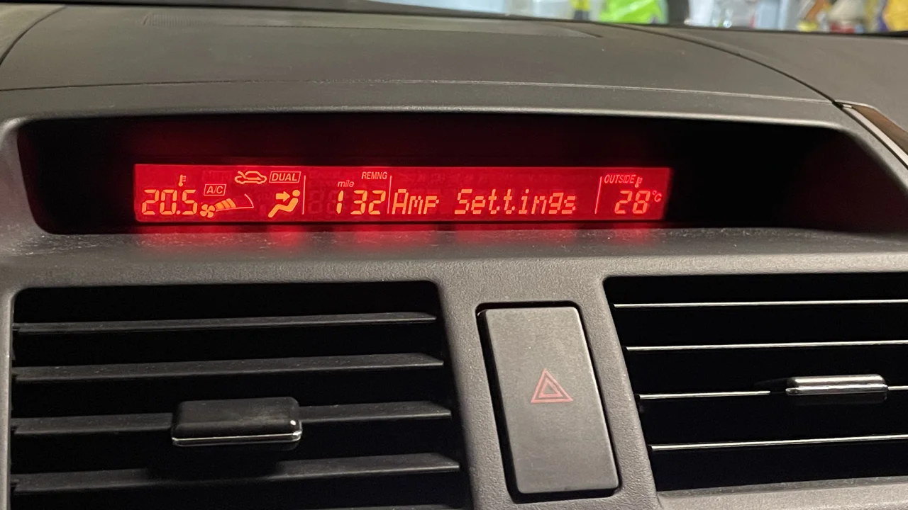

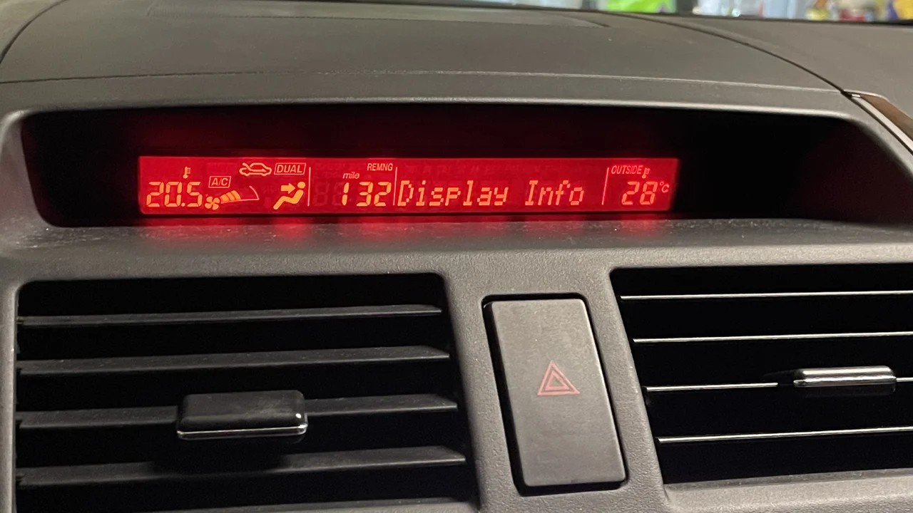

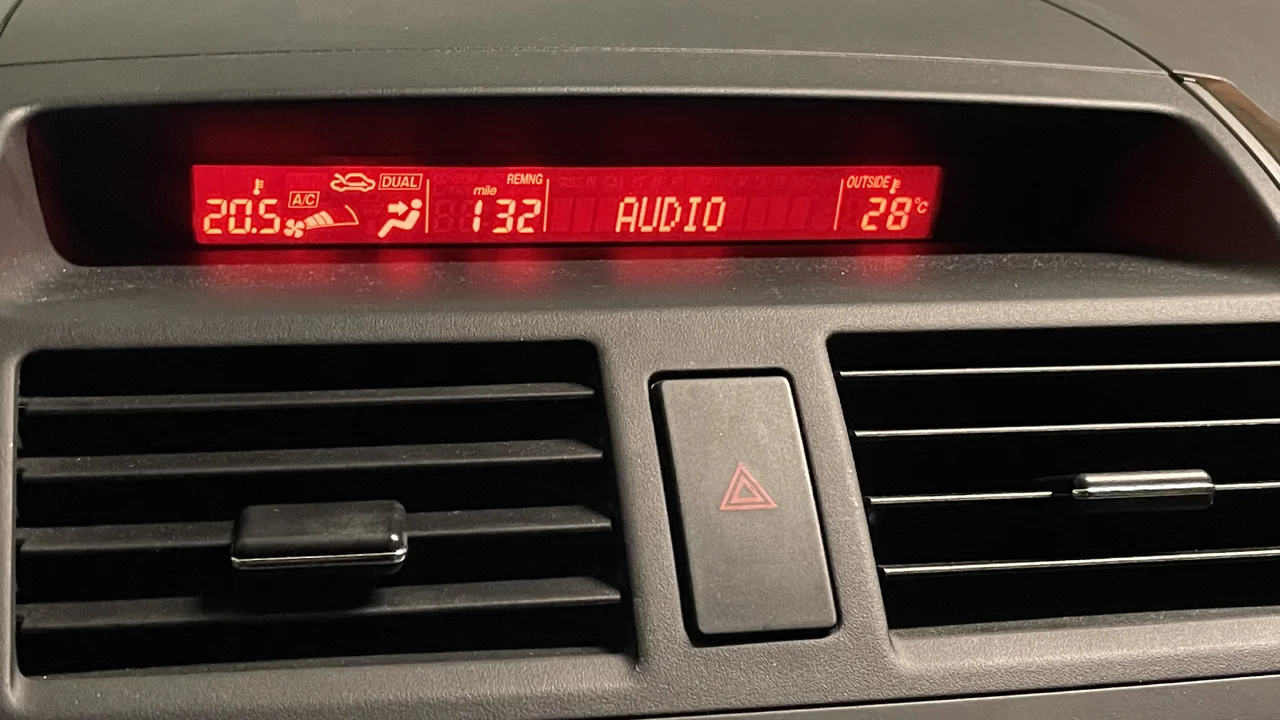

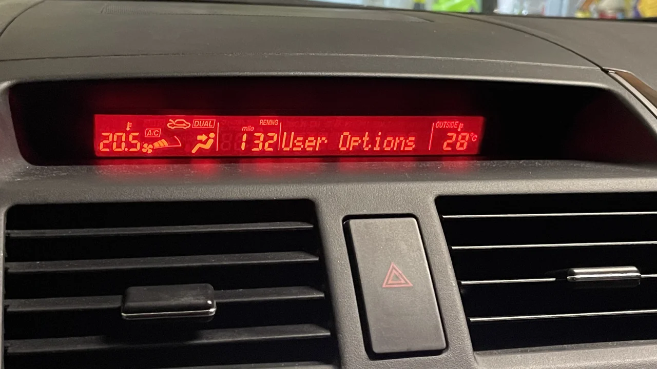

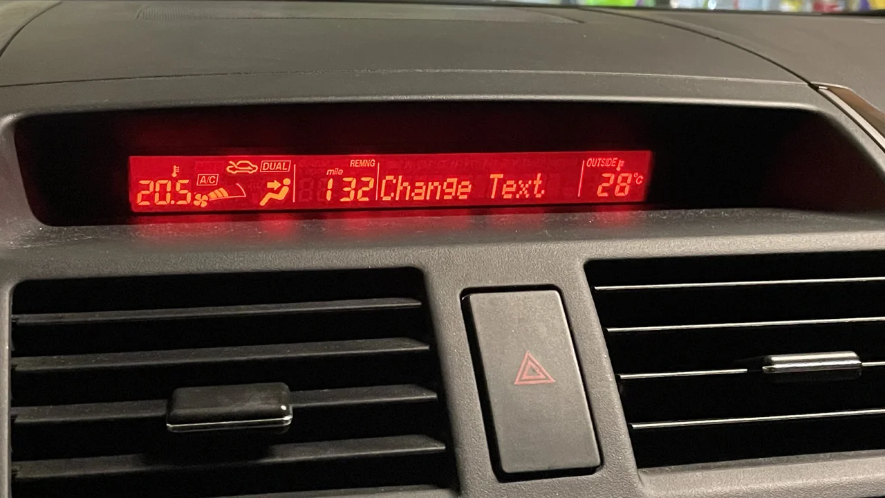

So, just for testing purposes, i managed to get a center display lcd from a 2007 CX-9 with bose and navigation that have the text display area and replaced my original info display with it. It's easy since all these parts have the same shape and same connector for all years and it doesn't require any modifications.
Just swapped the new LCD info display and turned the car on...
AND IT WORKED!
Now have access to all the options the PAC RP4-MZ11 has and I can adjust the amp levels, the text displayed, user options like SWC text, and so on.
The climate and temperature indicators work like always, and the part that shows the remaing range now alternates between displaying dring information or the clock.
It's worth noting that my car is a 2012 year model, and this LCD display came from a 2007 CX-9 and it worked just like that. I can't tell if all info displays from later models would also work but it's worth giving it a try if you're in a similar situation to mine.
