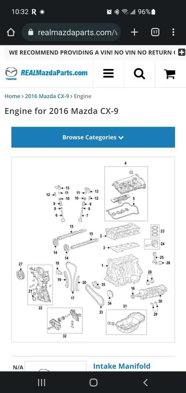

Just the head + gasket alone are $700. With valvetrain, I'd imagine it'll be close to $1000. It's still a long way from the $1700 unless that includes labor.

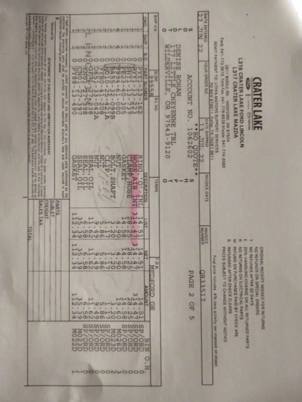

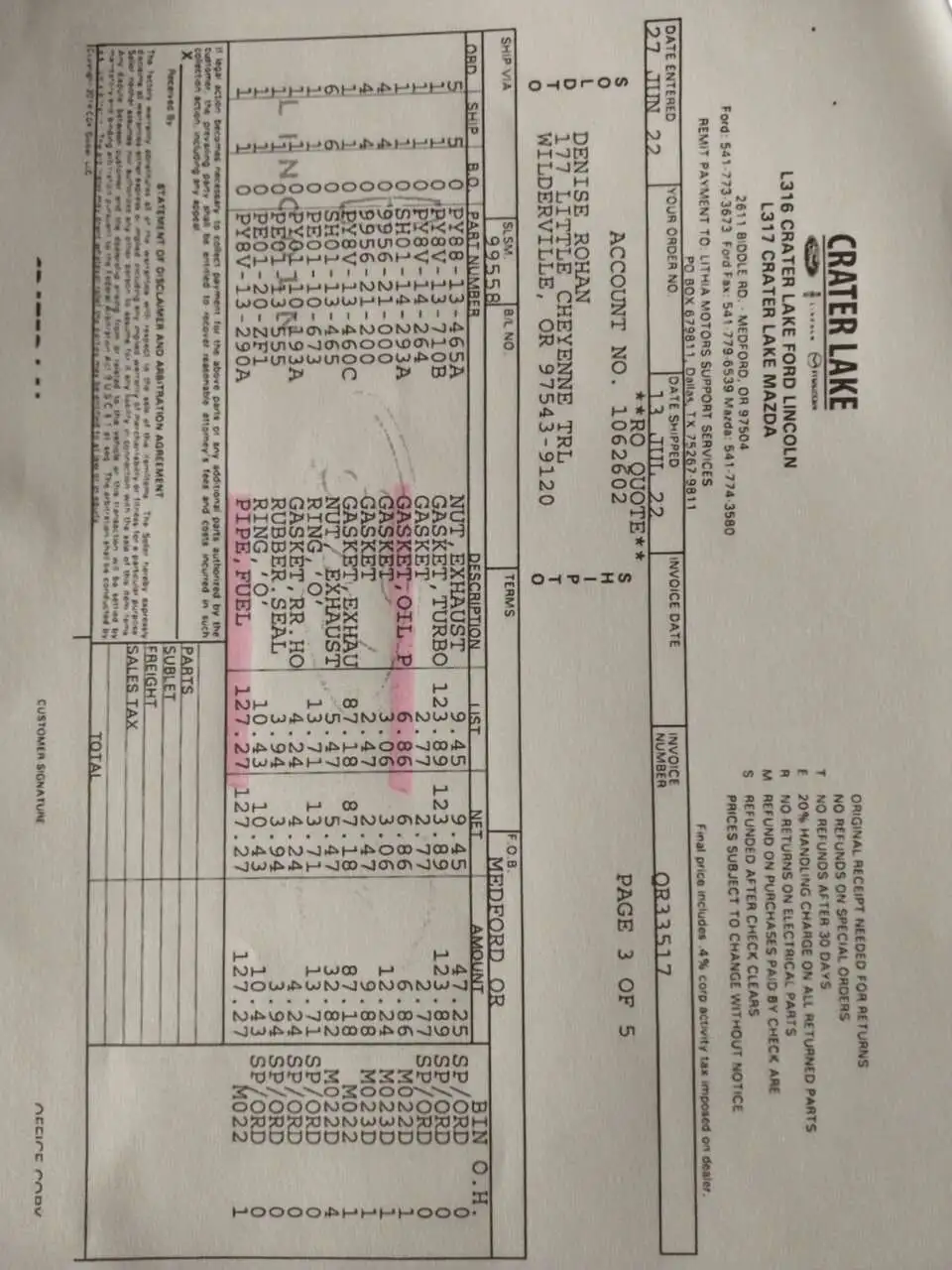

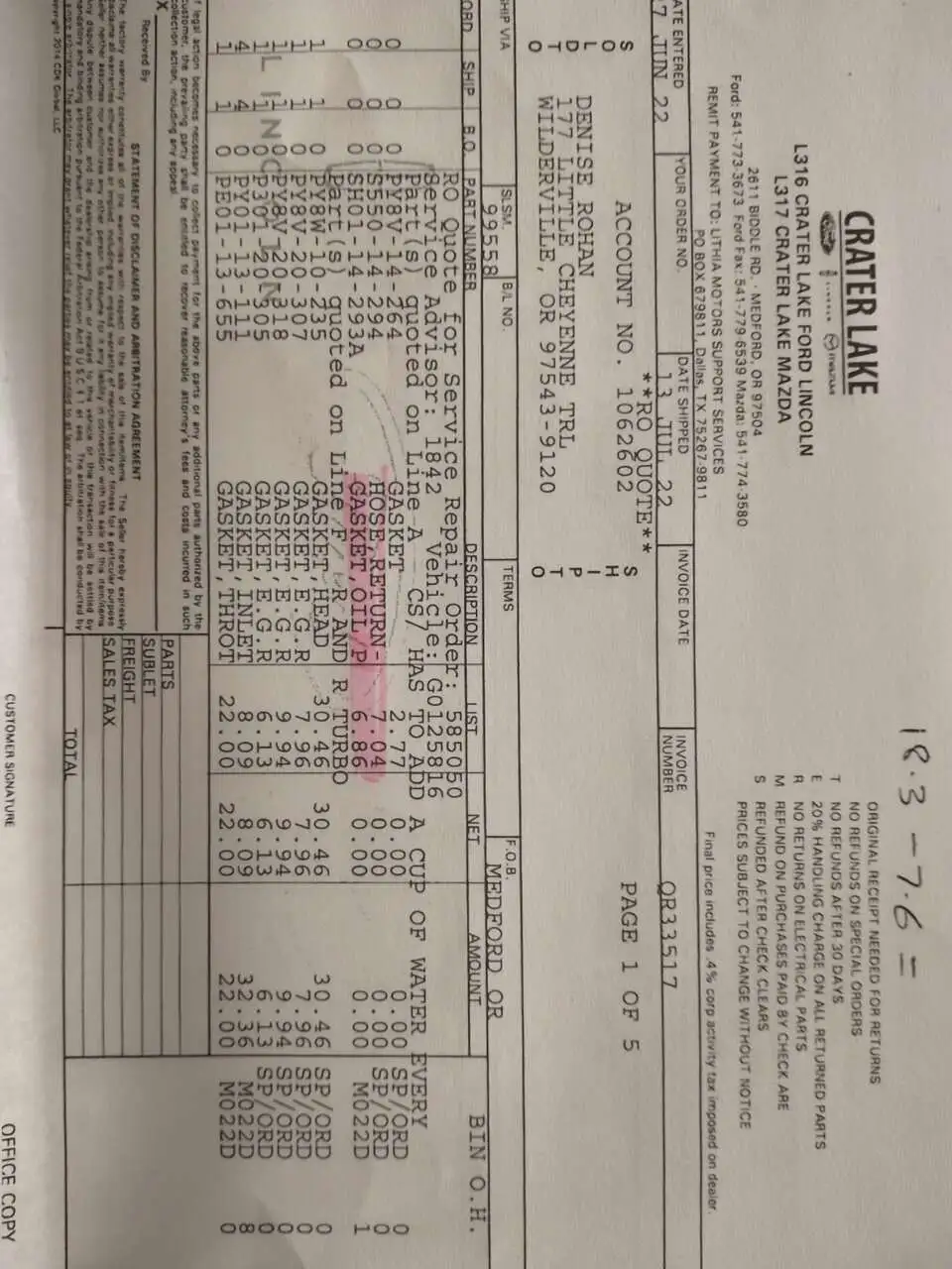

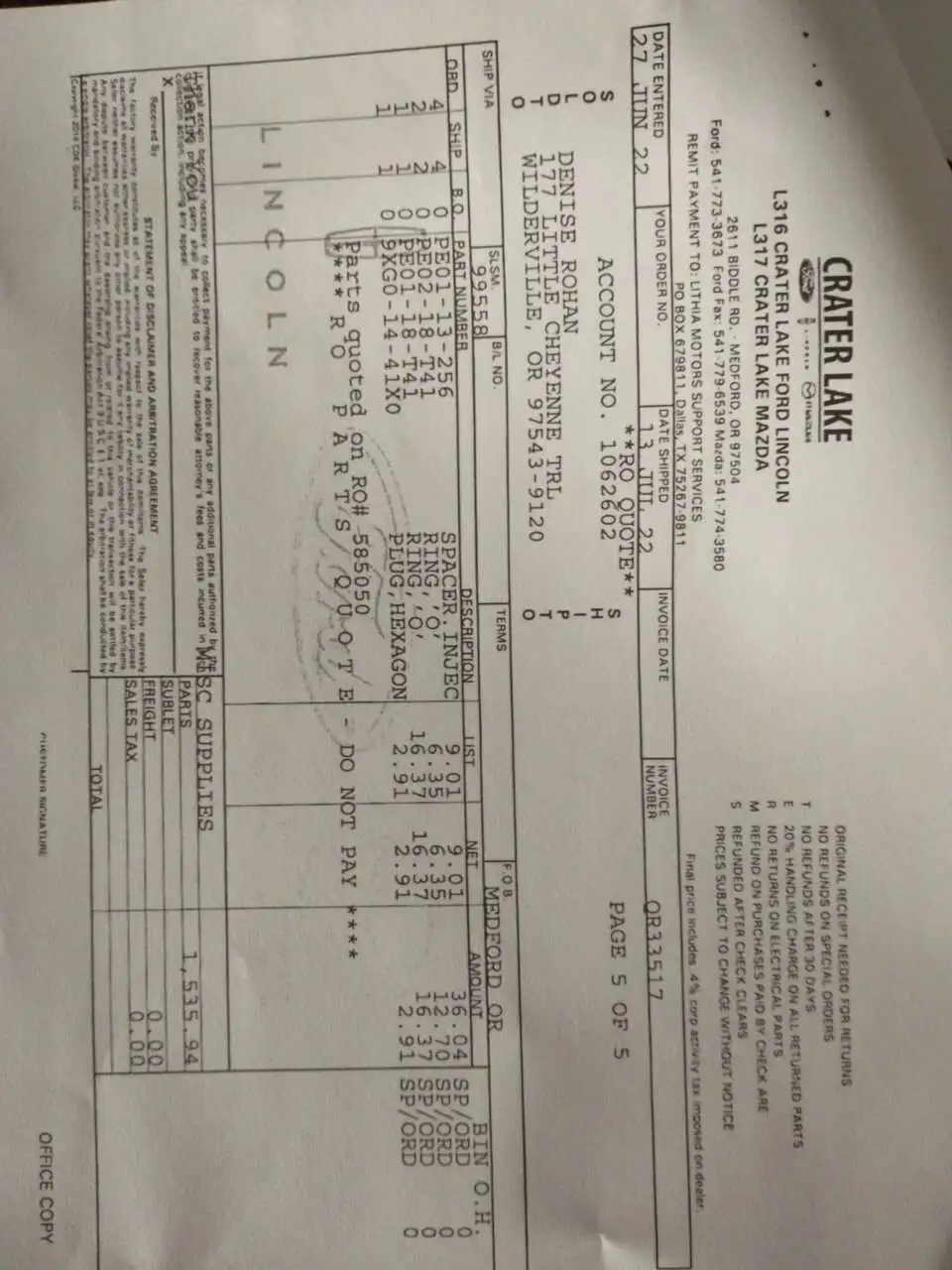

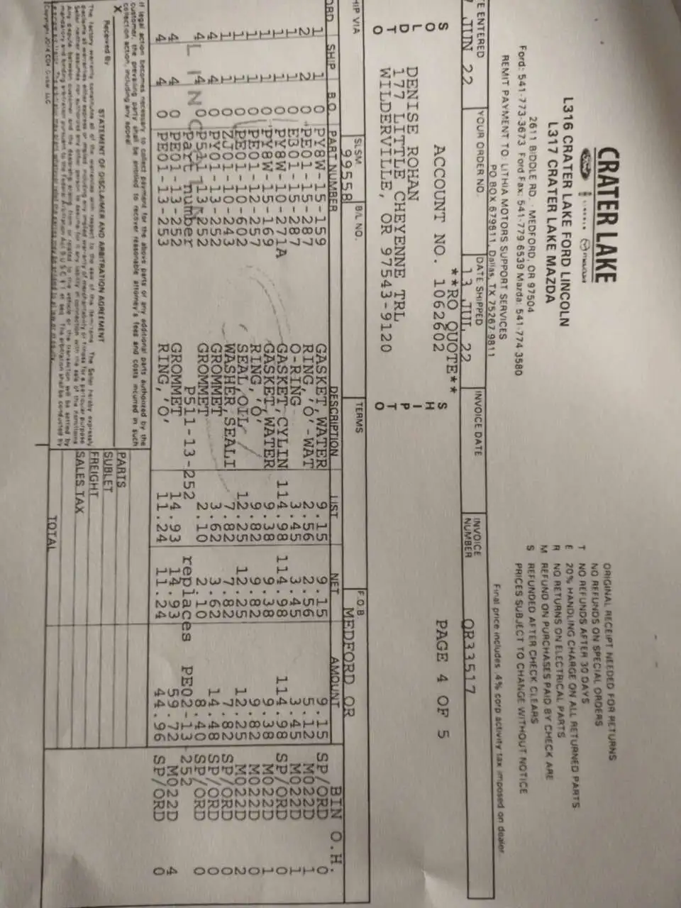

As of right now I'm being told around $5,100 to replace head gasket. This really feels absurd. I have 5 pages of parts that they gave me. Not all of it sounds necessary to me
Here are the 5 pages of parts for $1,500 to repair head gasket quoted at $5,100

In looking at that list, they are proposing to replace almost every plastic or rubber part that they will have to remove to get to the cylinder head. All the gaskets, seals, and o-rings listed are reasonable to replace because trying to reuse 5 year old rubber gaskets and seals is a recipe for disaster. They will likely not seal the second time around. They are also wanting to replace all the exhaust fasteners which isn't unreasonable as those can rust badly.
The prices for the items is eye watering - the $30 head gasket needs $1470 of supporting parts. Wow.
Is it $5100 total because of labor?
Might want to edit your personal info out of those. I agree with @jal142 as well. Sounds like a lot of parts, but all could be deteriorated or otherwise unusable. $3600 in labor seems very high though
Yes. $189hr for 18.8hrs.
So a few things
Thank you for posting your estimate.
Many nondealer independent Service shops are getting 200 per hour average in some states.
Dealership do often look for every possible part that can and, may and should be replaced during a head R&R.
Based on a quick look at the OPs area and surrounding dealership nothing is out of line.
I would suggest feeling better about the estimate from the dealership is to contact a few service shops and get a comparing estimate for the same work. But do not show them the dealerships estimate until after they give your theirs. Then you will either see the independent shop think ...well ya maybe that may need to be replaced as well but we wont know until we do the service. And you may also have a barging chip to get a better estimate from the service shop. Just make sure you completely understand what they will and will not cover for a warranty. You might also get from your dealership that wrote the estimate what their warranty is as well.
Bottom line if you were to have it done in my shop the cost would be less but I generally add to the parts based on my cost rather then reduce from a retail. This is always a plus to get return business. Parts are generally the same as a local auto parts store selling them to you or many times less then what you would pay for them It all depends on my cost.
The 18.89 hours for the work may be negotiable. Looking at the flat rate guide it seems a little high. I might add that if you have any kind of repour with the dealership or shop they may go the difference between retail and warranty labor rates and times? This is also another area that sometime I will do the difference to help out a regular customer. Many independent shops in the US use programs like ALLData for service information and labor times.
Last point I want to make... don't assume and try to cut corners on parts you think may not need to be replaced. If you don't completely trust the shop for their recommendation than go to another shop. Should you decide and it will be noted not to replace a recommend part and something happens it could effect the warranty. In most states shops must keep all the parts replaced and let the customer decide if they want them or not. The exception is on core charged parts. This means if suspect in any way that a shop padded the work contracted you can take legal action.
