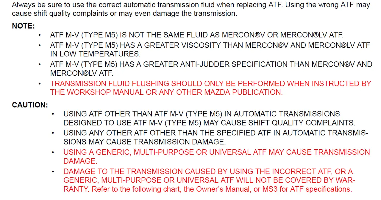

I've read some really bad takes but this has got to be the worst. Wow. If that's true, just throw some $3 Type F in there and call it a day.
Oh wait, this whole TSB thing that Mazda put out that specifically says to not use multi-grade ATF, and to only use type M5. Just ignore that, amirite? Because obviously a keyboard warrior on the Internet is far, far smarter than the Engineers who designed our transmissions.
Upvote 0
