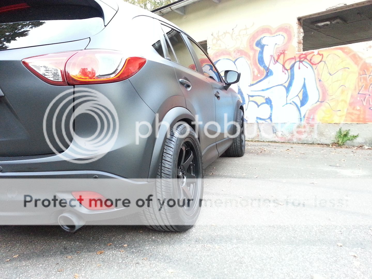

Hi guys. Just a quick questions to those who knows. Does the OEM CX9 rims 20x8.5 with 255/50 tires fit on the CX-5? If so, any issues? I have the 2016 CX9 and got 22s on it and looking into buying the CX-5 for day to day city driving.
Yes. Bigger setups have been run. At one time I had 255/55/20 with a 20x8.5 et 40 wheel
