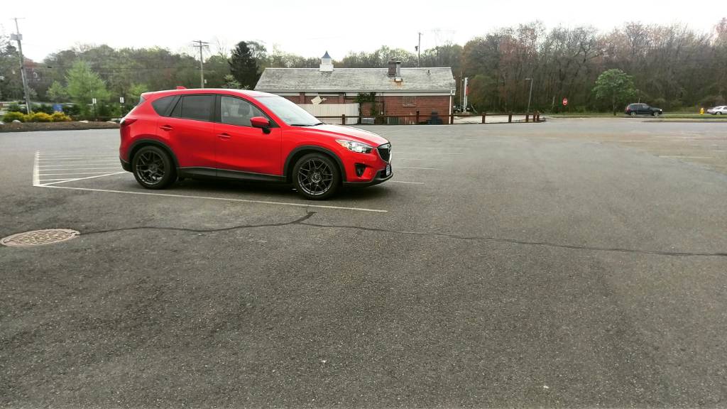

Currently running a 275/40-19 on a 19x9.5
.. Lowered on Megan racing coil-overs .. 3" ..😃
Although considering taking off the coil-overs.. Doing just a h&r spring.. & maybe a 275/55 tire...
