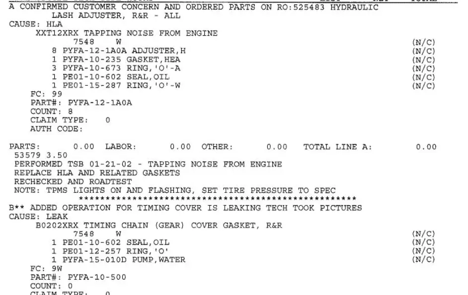

Work is completed. Hydraulic lash adjusters (8) replaced, timing cover gasket replaced and water pump replaced. Engine sounds nice and quiet again. We'll see after it sits overnight. Some oil burning off now from the repairs. Was told it may linger for a day or two depending on how much the car is driven. I'll be keeping a close eye on that...
Here's a snip from the work order showing work done. Got a chuckle when I saw the notation about the TPMS indicator flashing.....I don't have TPMS on my snow rims/tires.
