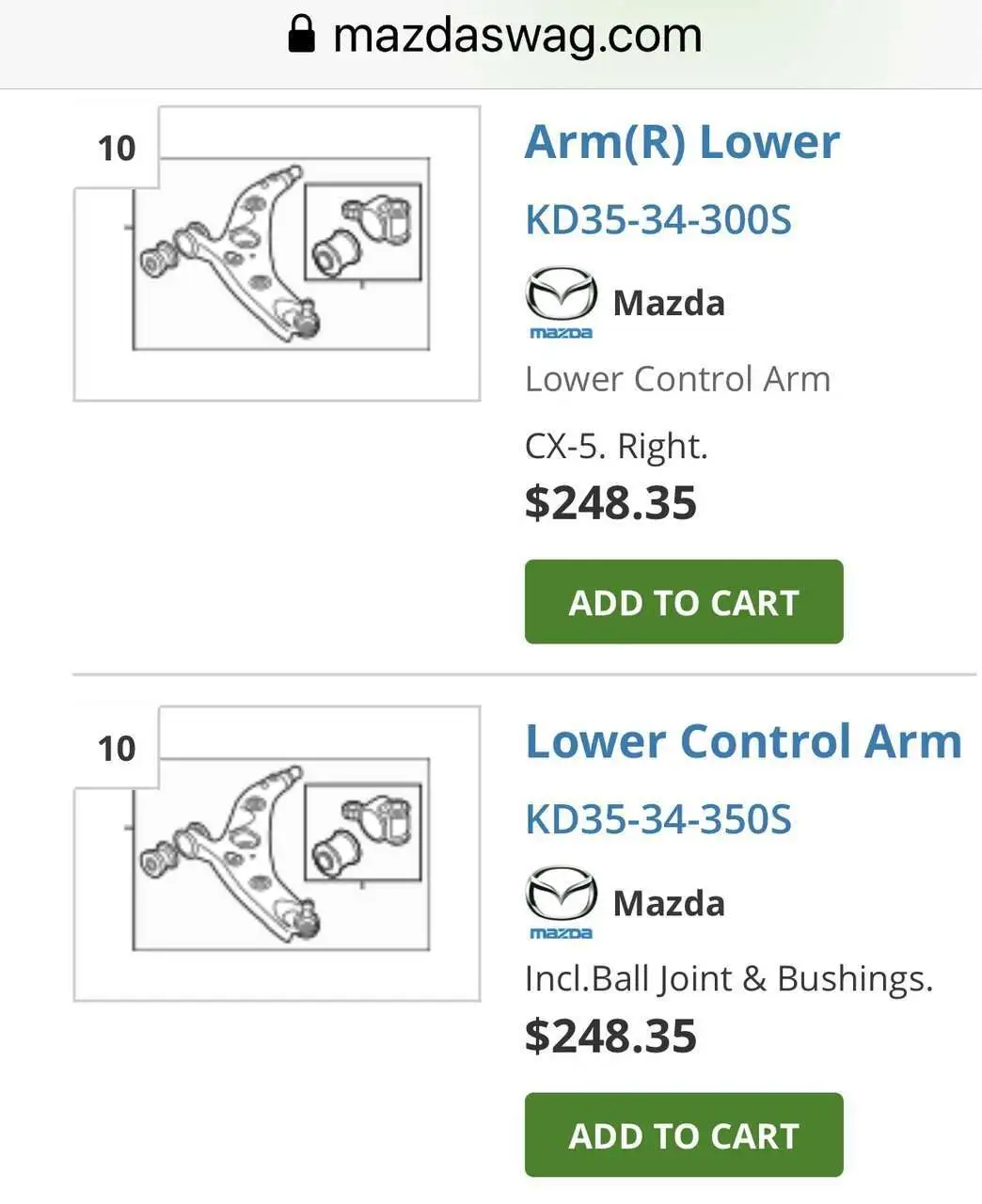

I’m kind of agree with your point. Front lower control arm bushing has been a weak point and had been “redesigned” many times by Mazda based on several related TSBs. Unfortunately the ball joint on it is also weak and problematic. So most DIYers especially in early days chose to replace the entire LCA with new bushings and ball joint pre-installed. The price usually was under $100 for a good new aftermarket LCA and it’s easier to replace.
Nowadays the cheap good LCAs are no longer available. With high labor cost, a LCA replacement job unfortunately now could be as high as $1,000+ like @ColoradoDriver just found out.

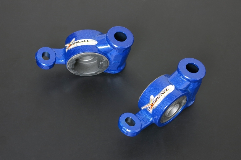

The lower arm bushing is trash construction. A user posted a video here where he had clunking coming from his as well. Mine is all wrinkled and ripped, I'm pretty sure some of my suspension clunk is coming from it. I ordered new shock absorbers and when I have it apart i'm going to remove that bushing and fill the holes with polyurethane. Hardrace actually sells a replacement bushing (hardened rubber) for that one bushing only (literlally, not including motor mounts, that is THE only bushing they sell for the car) for the CX-5/3/6. It also comes included if you buy the Hardrace lower control arm. They already figured out it was garbage lol. Luckily it's easy to remove as the LCA just has a projection that this slides over.

This’s an unbelievable price for the OEM LCAs! This just to tell how much the inflation has been in the US in recent years! I paid $285.23 for a right LCA which is 20% off from current MSRP $356.52 in March. The same OEM part is only $105.34 in Japan?

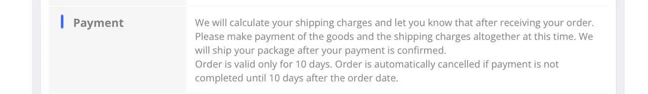

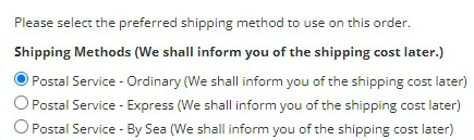

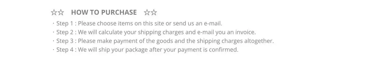

It can take a couple weeks but may be quicker if you pay more for shipping
So it sounds like you might have experience with this shop. Not sure how to interpret this. Seems like they want me to put in the order before they'll actually tell me what shipping costs.
