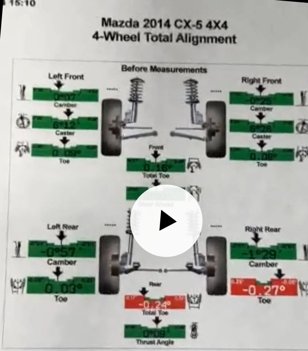

Hey all, so been driving a bit and gotta say, feels nice having a firmed up suspension again. That said, I definitely feel a difference in the front and rear when say going over a speed bump. They aren't leaking, but I think at some point in the near future, I'll go ahead and replace the rear shocks too.
Also, I never felt like my CX-5 was out of alignment too badly, but after the most recent alignment, it's definitely tracking nice and straight. I've never gotten an alignment since new until I had it done this month and everything was still green except for a couple spots. I forgot to get the printed our report, so will have to double-check the video they sent me that had a picture of it.
Sorry, best pic I could get from video. Rear toe was off, but now corrected. Oddly enough, front alignment was pretty good after replacing all those parts lol.
