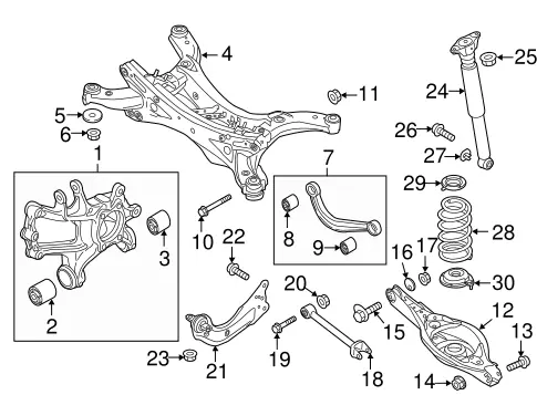

For OEM rear shock absorbers #24 in the diagram here are part numbers for gen-1 CX-5:
KDY5-28-910C Shock absorber for 2013 ~ 2014 Mazda CX-5 to 5/13/13.
KR27-28-910H Shock absorber for 2014 ~ 2016.5 Mazda CX-5 from 5/13/13, Type 2, without AWD.
KD35-28-910K Shock absorber for 2014 ~ 2015 Mazda CX-5 from 5/13/13, Type 1, with AWD.
KA0G-28-910G Shock absorber for 2015 ~ 2016.5 CX-5 from 11/03/2014, with AWD.

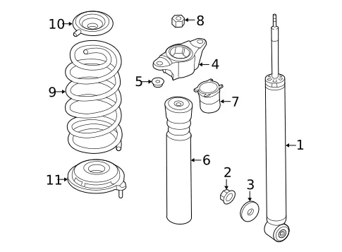

For OEM rear shock absorbers #1 and shock top mount #4 in the diagram here are part numbers for gen-2 CX-5:
KB7W-28-700B Damper rear for 2017 CX-5 to 06/22/2017, with FWD.
KL2F-28-700A Damper rear for 2017 ~ current CX-5 from 06/22/2017.
KL2G-28-700A Damper rear for 2017 ~ current CX-5 from 06/22/2017.
TK48-28-380C Shock mount for 2017 CX-5 to 10/01/2017.
TK52-28-380C Shock mount for 2017 ~ current CX-5 from 10/01/2017.
It’s not likely you can use front struts, but It’s likely to use the rear shock absorbers from gen-2 CX-5 for gen-1 CX-5. See here:

No, the rear shock absorbers and the upper shock mounts on gen-2 CX-5 won’t fit the gen-1 CX-5.

$60.92 CAD / $49.39 USD a piece for a rear shock top mount? Might as well get a pair of OEM rear shocks (KDY5-28-910C $106.64 / $151.08 USD MSRP) which come with the top mount when your shocks are more than 10 years old. The labor cost will be the same.
Or you can get CX-3 top mount DA6A-28-380 which will work to your CX-5 although it’s thicker. You can find one between $17~ $40 CAD but the labor to replace them could be high.

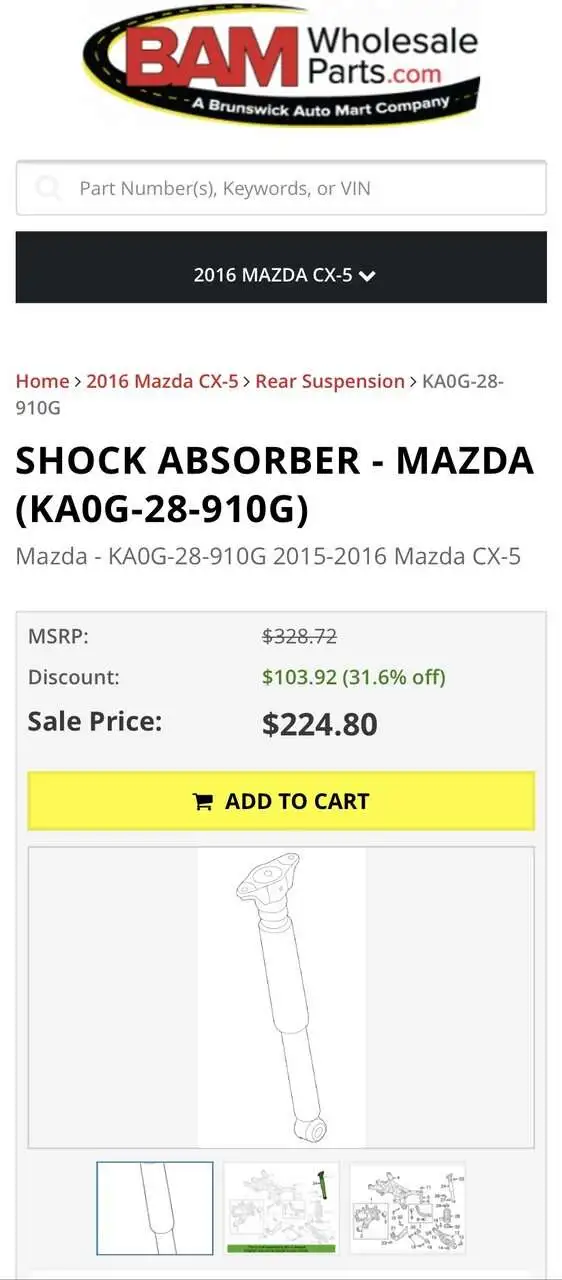

I just checked the price and I was shocked to see how much the price has increased for those OEM shocks! My KA0G-28-910G rear shock used to be around $80 each, now is $224.80!!! 🤪
