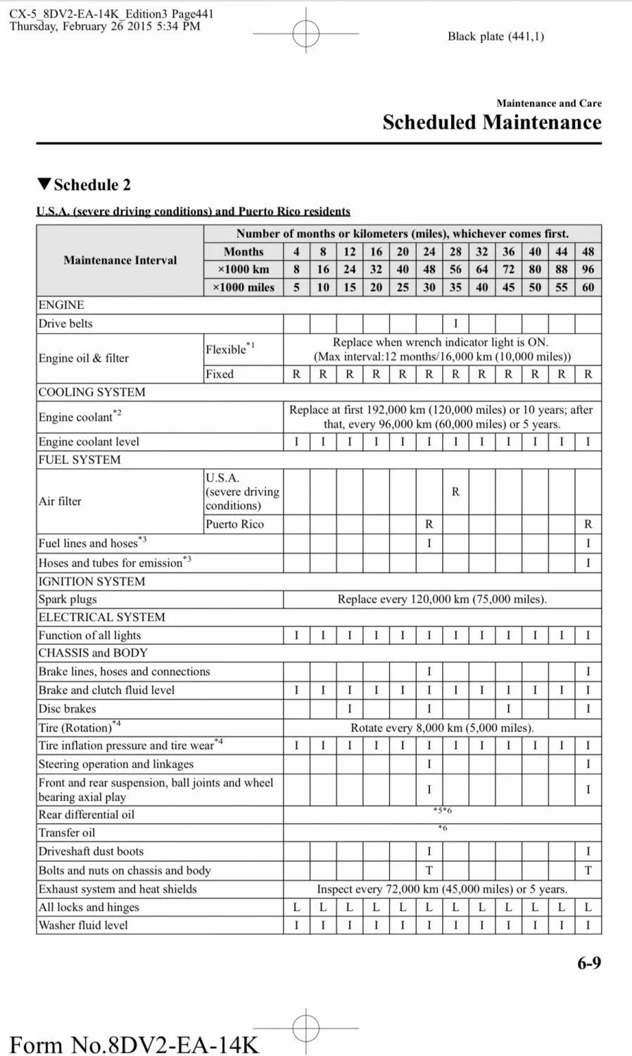

I live in Texas and follow the Schedule 2 of the Scheduled Maintenance in the user manual. In the user manual, this schedule stops at 60,000 miles. Since I am at 75,000 miles, I am wondering how you all handle the maintenance at this mileage. Is there anything I should do apart from oil change and tire rotation going forward? Apart from brake fluid flush and ATF exchange, are there any other maintenance items I should do at this time? I don't trust or care about what the dealer wants me to do.

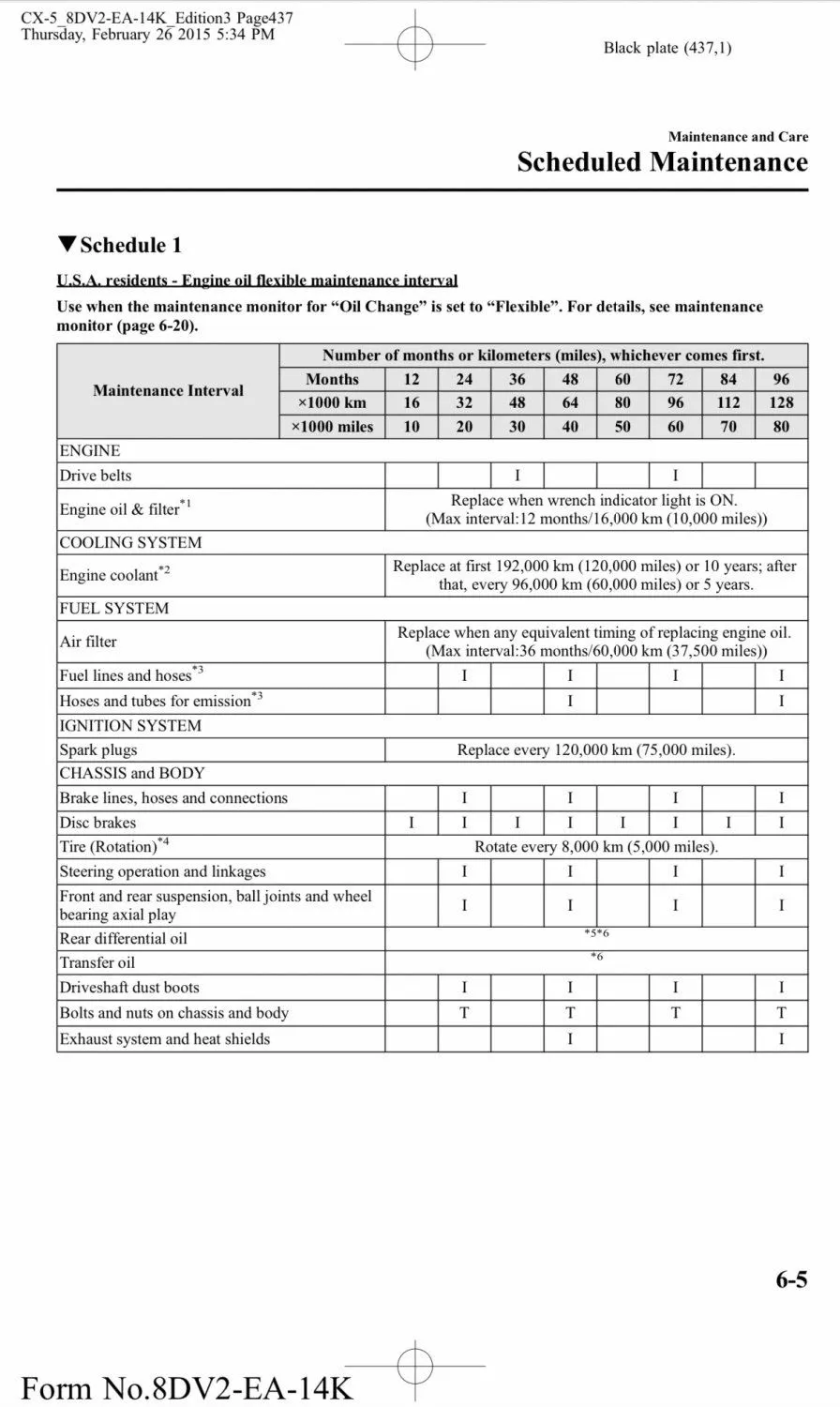

At 75k miles, you're due for spark plugs. They're easily accessible and only require a couple tools if you feel like doing it yourself. Next service item (I think) per the manual will be coolant drain/fill @ 10yrs/120k miles

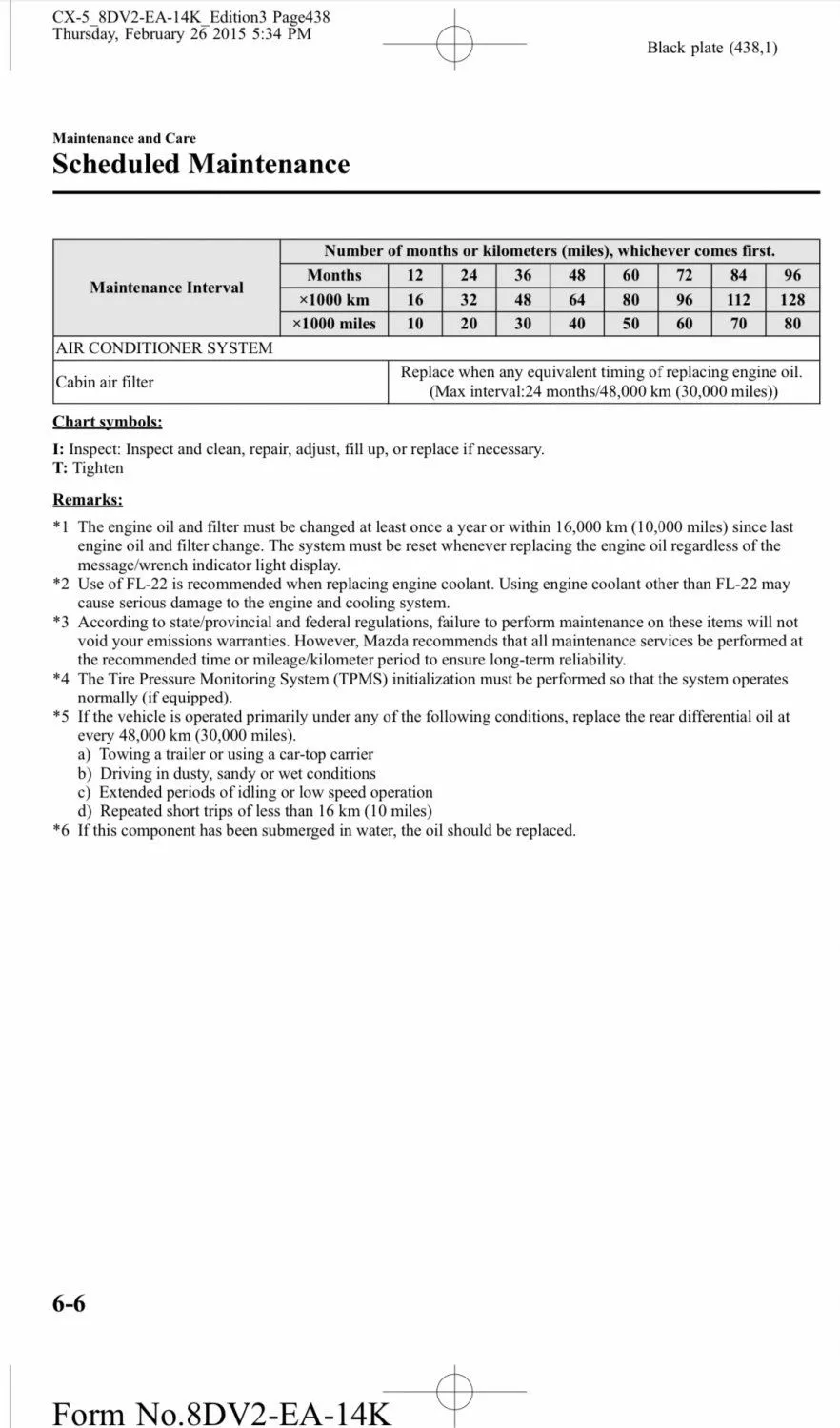

Thanks. Do you mean spark plugs replacement? Where’re you seeing that in the manual? The maintenance schedule in my manual stops at 60k miles.
Yes, spark plug replacement @ 75,000 miles. In The Owner's Manual section for "Scheduled Maintenance" it has:
IGNITION SYSTEM:
Spark plugs Replace every 120,000 km (75,000 miles).
and
COOLING SYSTEM
Engine coolant*2​
Replace at first 192,000 km (120,000 miles) or 10 years; after that, every 96,000 km (60,000 miles) or 5 years.​

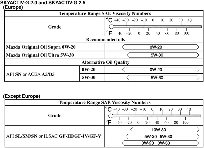

I read an article on the difference between Gf-5 and Gf-6 oil and the new gf-6 oil is much better for eliminating timing chain wear. So I make sure the oil I use is rated gf-6.

I have a 2016 CX-5 GT AWD with Tech Package. In Dallas Texas area I use Schedule 1 Flexible Oil Change Interval. It usually notifies me to change oil around ~7K miles or 12 months whichever comes first. But I change the oil early with 30% oil life remaining which is at 5,200 ~ 6,000 miles. The 12 month interval is handy during this pandemic as people drive less. Last time when I changed the oil in December with wrench indicator displayed and “Oil changs due” message as the oil life remaining went down to 0%, the oil had been used for only 2,728 miles.
Even if you use Schedule 2, the maintenance intervals are simply repetitive to previous intervals after 60K miles on the schedule. For example, you keep doing 5K-mile / 4-month oil change whichever comes first after 60K miles. . IMO Schedule 2 with Fixed OCI is an over-kill for you in Houston area, especially the 4-month part. Just use Schedule 2 Flexible OCI to let the on-board computer figure out when you need to change the oil. Some maintenance intervals longer than 60K miles, such as spark plug and engine coolant replacements, will be specified separately as you can see.

For engine noise you may try a good name brand 5W-30 “full synthetic” oil which could reduce some oil related noise. Newer GF-6 oil is a good choice too.
In addition to 0W-20, Mazda recommends 5W-30 oil worldwide on SkyActiv-G 2.0L / 2.5L. So use 5W-30 oil on your 2.5L with confidence.
