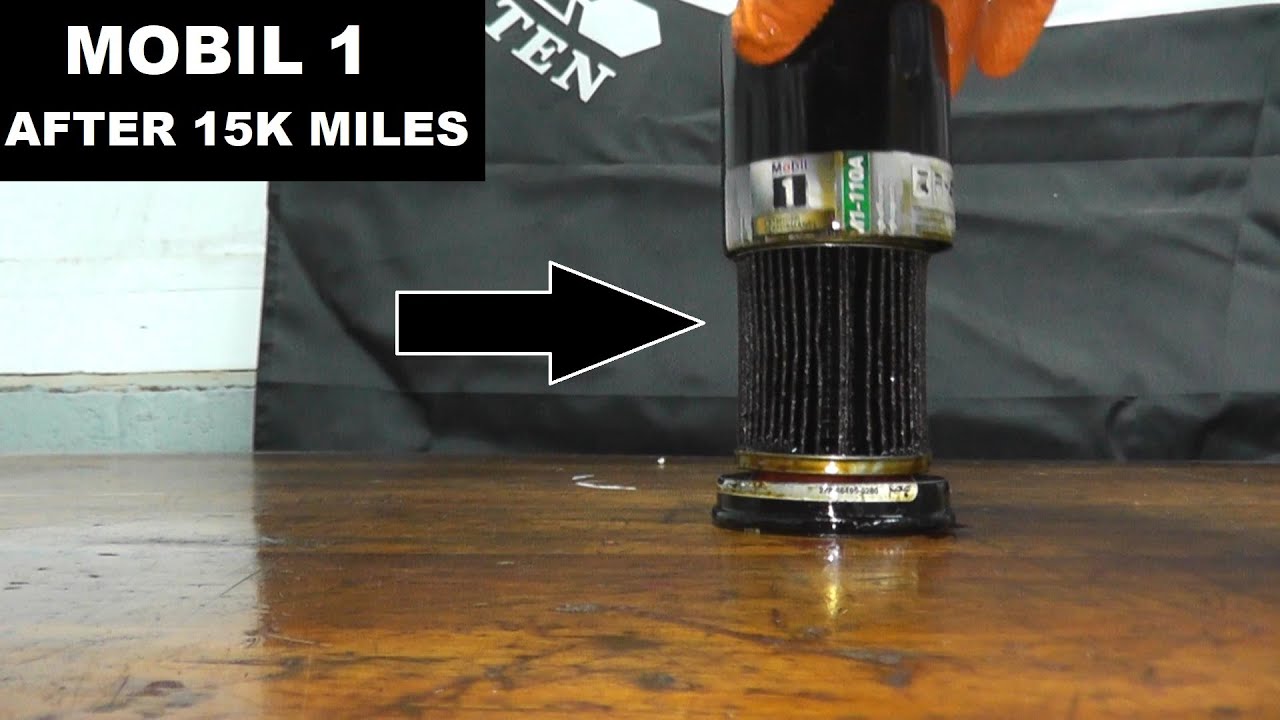

Has anyone seen the Mazda OEM filter cut open? It does not have a top or bottom plate. Not sure that this is good. Also, cellulose as the media is not the best you can get. I would say too that the Micron level is high and would cause wear on the engine.
Compare that to:
Which do you think is better?
