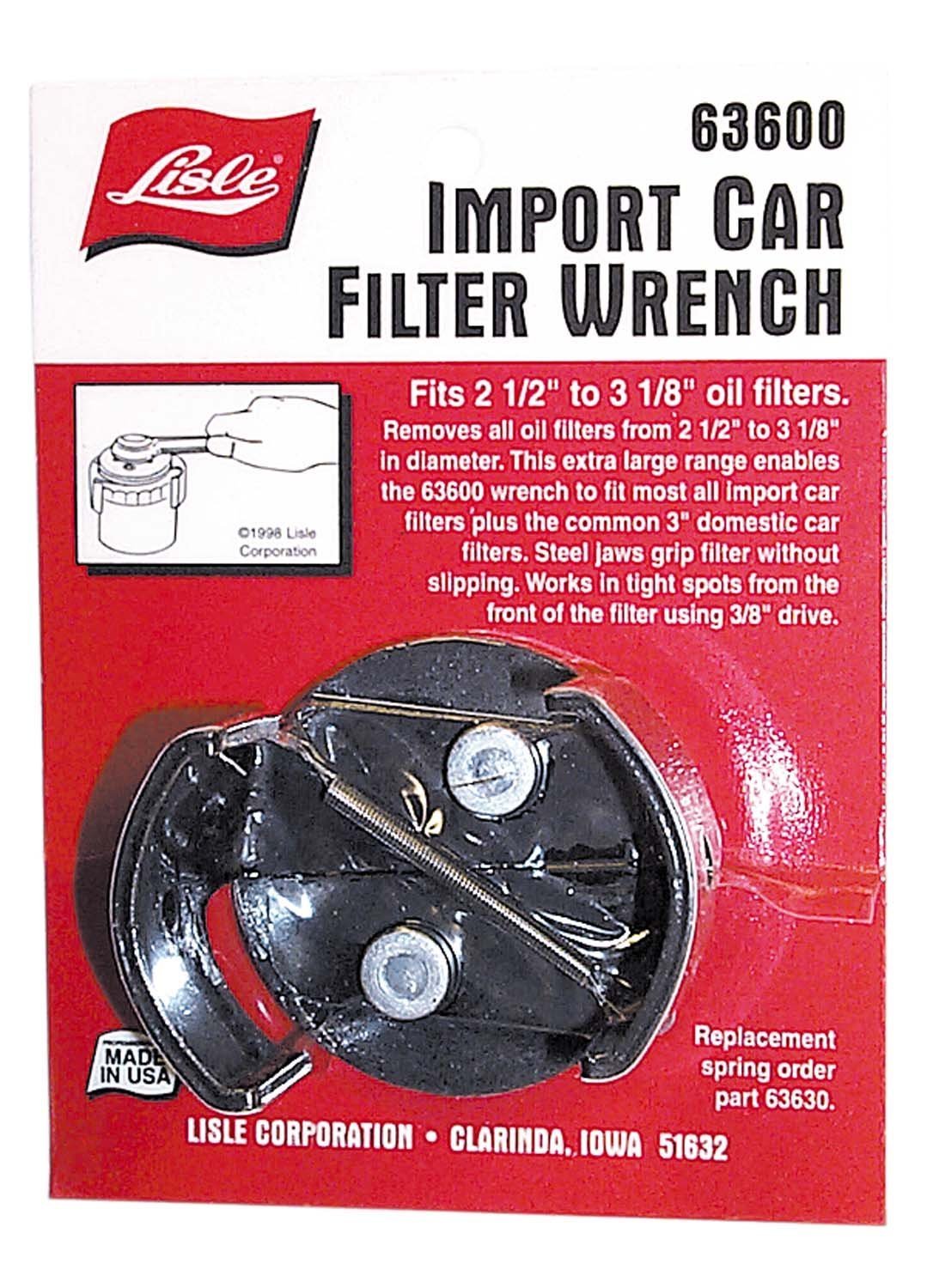

What always worked best for me on small filters was a pair of pliers they sell for removing radiator hoses. If that didn't work then I would bust out my giant size channel-locks. Sometimes I would use a blue-point oil 3 jaw oil filter wrench.
This is one of the best filter tools I've owned. It works on my CX-5, truck, and tractors.
Thanks for the tip! The reviews on it are great and it will be on my next Amazon order.
