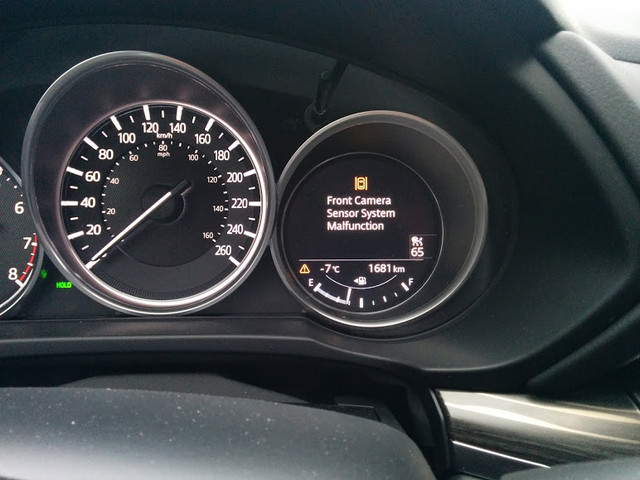

Well, I am just going to revive this thread due to mine started showing up for the front camera sensor system malfunction just at 1650 km while sitting on the traffic at the highway. It is not even sunny, however it was cloudy and temperature of -15c outside. I did turn off the car for 2 minutes hoping it would reset but still shows up. For some reason though, the traffic sign detector, the cruise control works and lane keep control. Pretty much what this camera should do but I wonder why the warning started showing up. Thinking could be moist from inside the cabin since I don't have the window down and the vent are usually closed at all times so its gets foggy inside.
Now I will wait until the end of the day, after work, to see if it goes away when it gets a little bit warmer later on. Leaving it under the sun to see if perhaps the moist is the culprit.
What exactly is the message?
Front Camera Sensor System Malfunction
I had that same error with the front camera - I had hoped for a "My vision is impaired. I can not see!" audio warning. In any case, it resolved itself after sitting in the sun for an afternoon. Someone had mentioned that it may have been fixed itself by using the AC to reduce humidity.

I had the same warning early on as well. A good cleaning of the windshield and the logo up front solved it. Even small amounts of dirt or buildup affect these cameras and sensors.

I think so too. There is an airgap between the windshield and the camera lens that will allow condensation to form on the lens even if the windshield appears clear. It will not work or at least it will advise you that it may not work until it clears. Mine does it but it clears after a while and all settles down.
