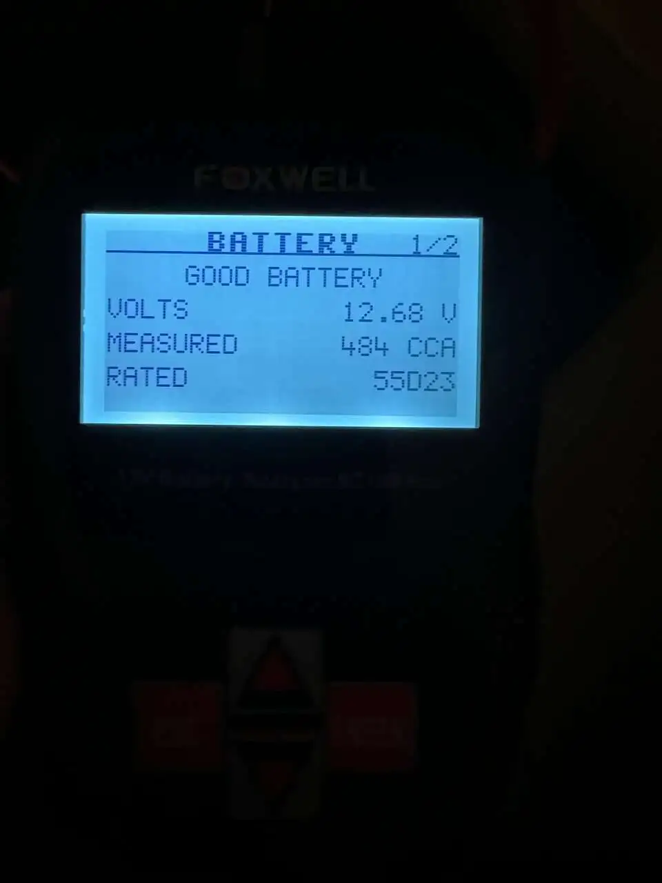

The oem battery has small capacity out of the box. Around 480 CCA as new. The problem usually is they loose electrolyte liquid over time and then sulfation starts which degrades the battery plates further if not taken care on time.
The good part is the oem battery is serviceable and with proper maintenance the oem can go 5-6 yrs but one has to monitor and add distilled water to each of the 6 cells before the level drops, etc. There is level mark (high low) on the side of the battery and Mazda conveniently put an opening on the side cover for checking. Still its a bit of effort so rarely anybody does it. Not even the dealer shops.
In comparison new battery (group35 for the CX5) even non agm have larger capacity CCA. They start usually at 600 and higher.
here is the oem on a new car just for info.

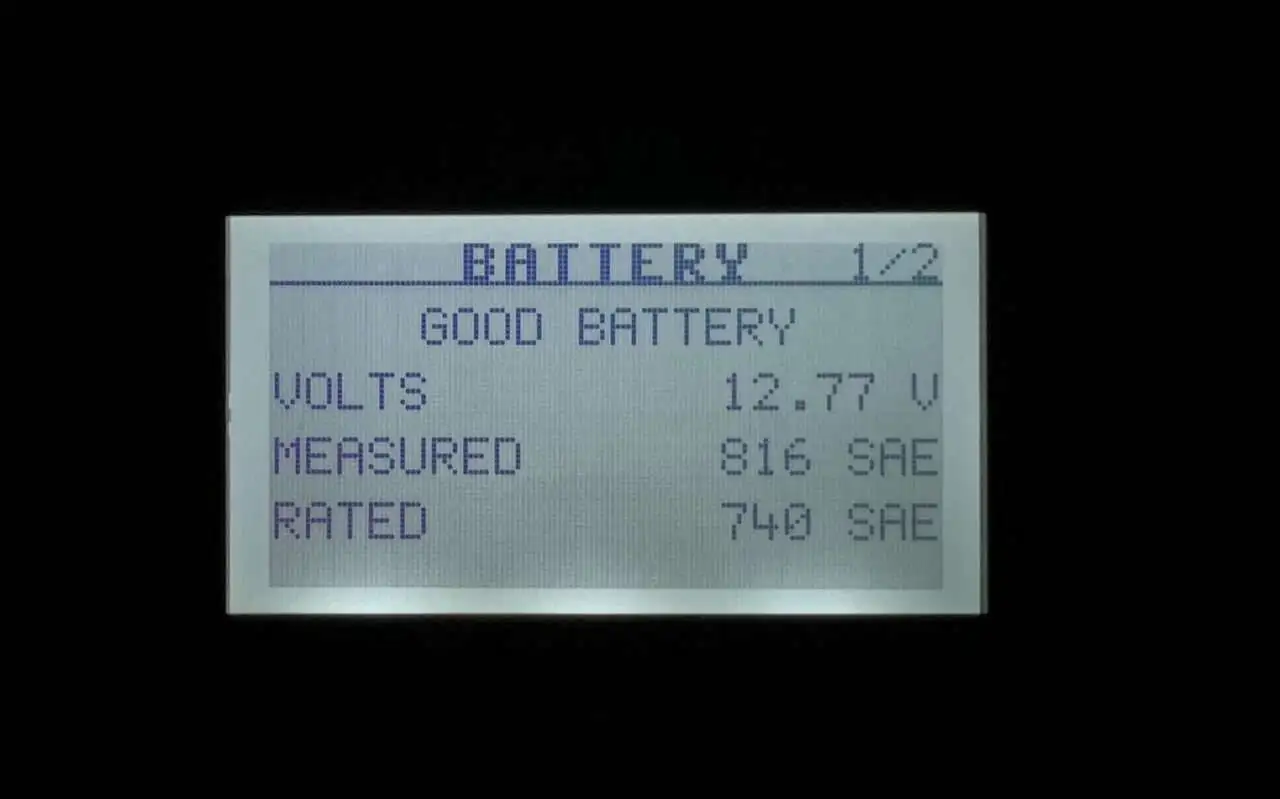

Just a heads up that if you want to move up to a larger battery size the 24F fits into the tray perfectly if you just nip off the front two stays (essentially making it about a half inch longer). Having 840 CCAs now makes cold starting a breeze.
