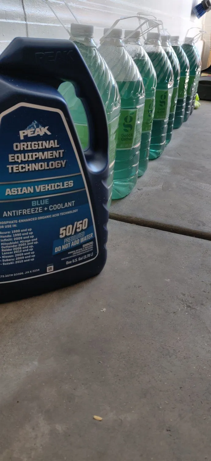

On CX-5 I did 9 drain/fills to dilute old coolant. I poured 1 gallon fresh new coolant and did 10th drain/fill. 11th drain/fill with fresh new coolant coming up soon. FYI, I converted to PEAK Blue OET coolant.
