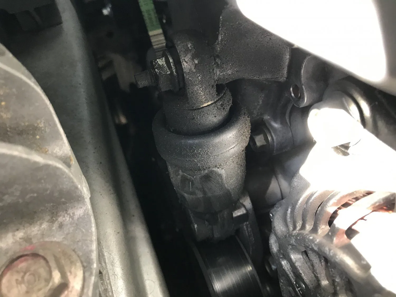

2013~2016 CX-5 Belt Tensioner - Shouldn't this be a warranty item?
Boy, this tensioner thing is getting interesting! Like you said, just a month ago Mazda parts list had PET2-15-980 for $147.86 MSRP, now another new-and-improved tensioner PE03-15-980C is listed selling for $207.71 MSRP!!! :rolleyes:
Now the latest PE03-15-980C replaces: PE01-15-980A, PE01-15-980B, PE03-15-980A, PE03-15-980B, PET2-15-980!
I guess I’m lucky not to jump in too soon getting a new old-version tensioner last month when I noticed the leaky tensioner, although the price has jumped 40%!!!
The TSB says to use PET2-15-980 tensioner and “new modified drive belt auto tensioner can be identified by serial number F569897.13.”. My theory is the latest PE03-15-980C is equivalent to modified PET2-15-980 with serial number F569897.13., but added some expensive super sealing which caused the 40% higher price!

funny thing, I was checking two more cx5 with the same and exact Ina part no. as mine (that was leaking) and they dont leak. So its hit and miss.
The description of the TSB 01-019/19 says:
“Some vehicles may exhibit oil leakage from the drive belt auto tensioner and rattling noises from the engine compartment. This may be caused by insufficient sealing at the drive belt auto tensioner damper when the auto tensioner fully operates under both high ambient temperature and high load conditions. To eliminate this concern, the shape of the drive belt auto tensioner damper has been changed.“
So for those living in hot states such as Arizona (CX-5um) and Texas (me), the damper may leak easier (and both of us did). If we can make sure the serial number on INA tensioner is F569897.13 or higher, that should be the revised version with better sealing on damper.

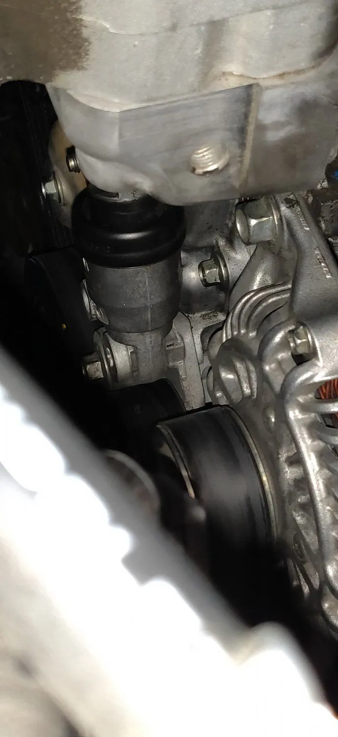

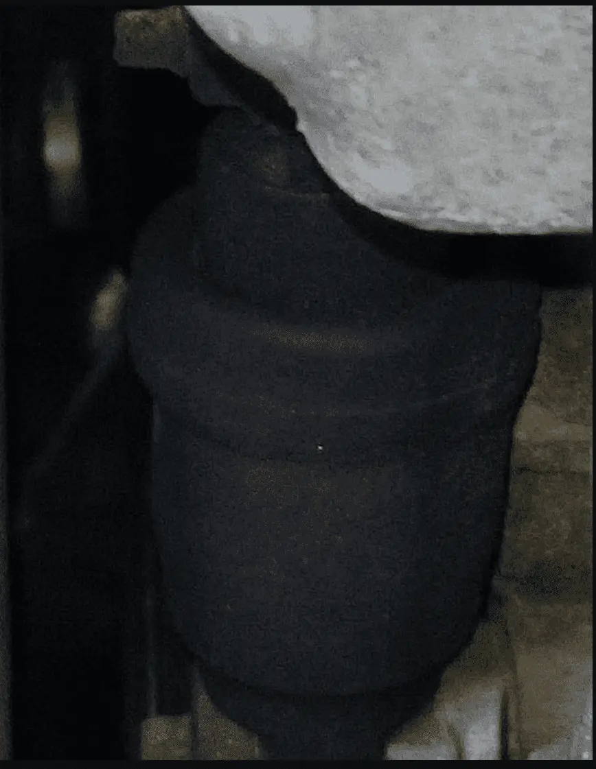

The belt tensioner on your 2013 CX-5 has amazingly lasted 120K miles. I wonder if you can see or take a picture of that long-lasting tensioner showing the part number and / or the serial number? What are the part number and serial number of that spare tensioner lying on the tool box? :unsure: See post #26.

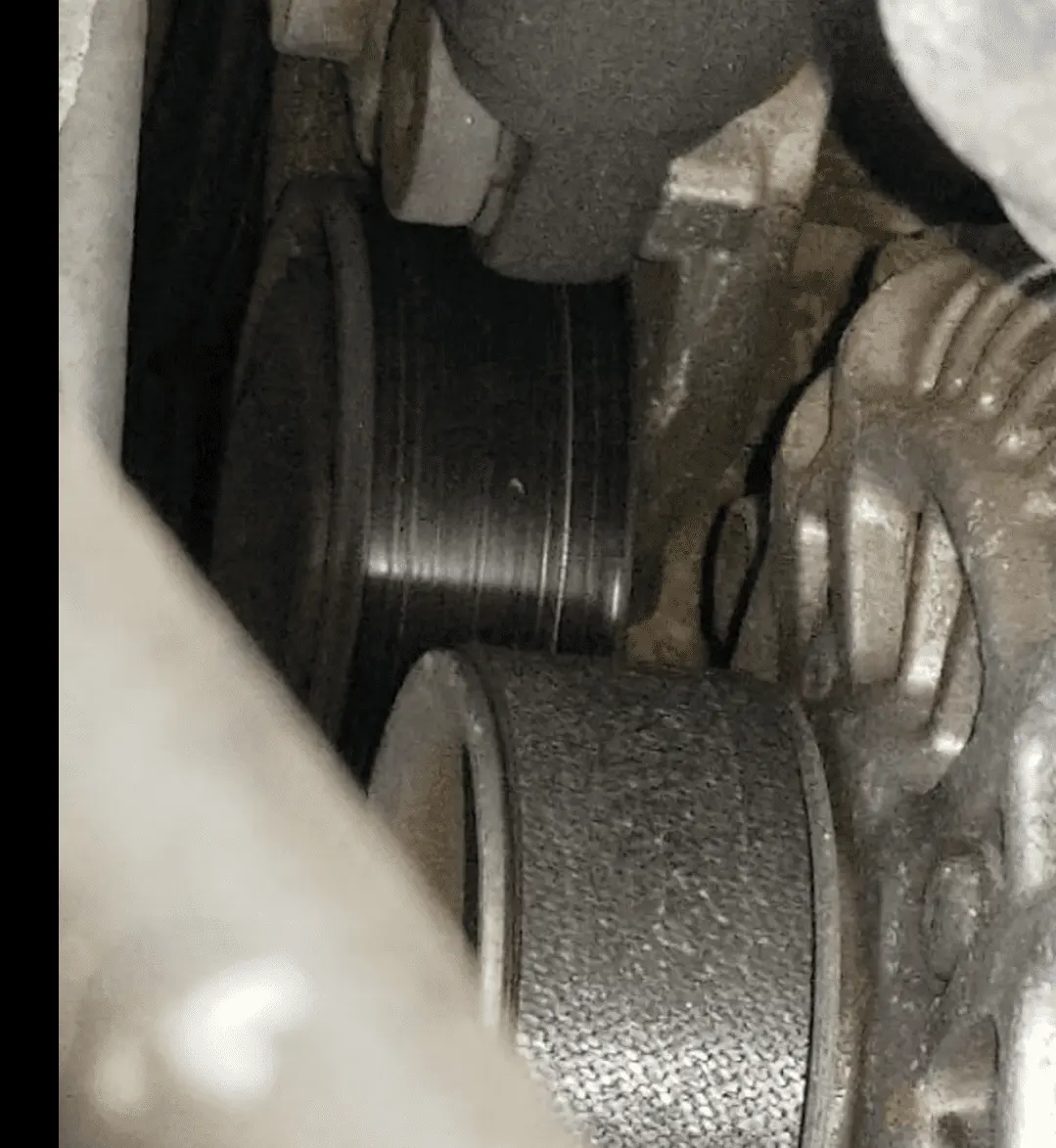

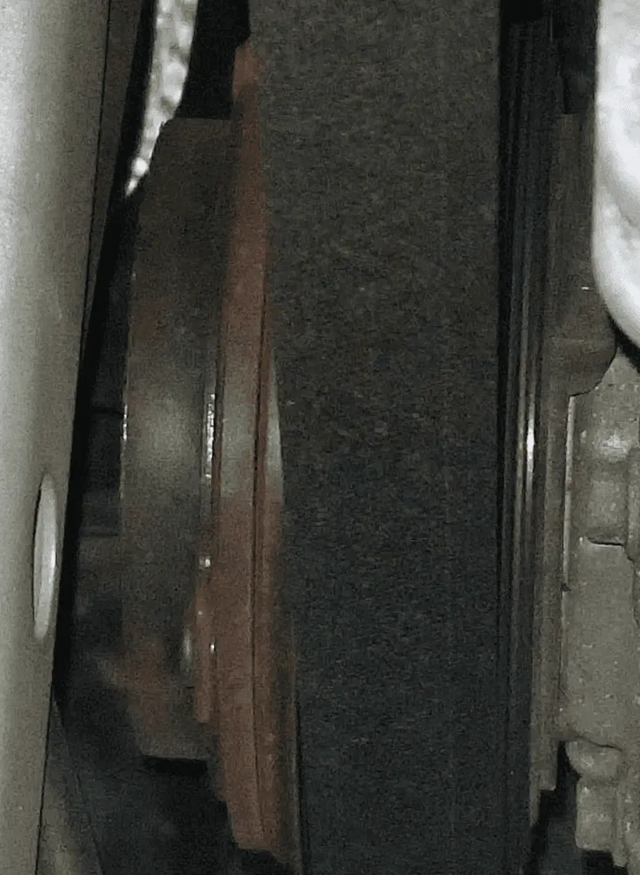

Here are some photos of my timing belt, not sure if it needs replacing. Can anyone else take a look?
I did notice some liquid on the wheel in the first photo though but I'm not sure if the tensioner would be the cause.

There’s no timing belt for your CX-5 2.5L. There’s a serpentine belt for AC compressor and alternator. A second stretch belt is for water pump. A belt tensioner on the topic is for long serpentine belt. A leaky belt tensioner looks like this on my 2016 CX-5 at 41,150 miles:

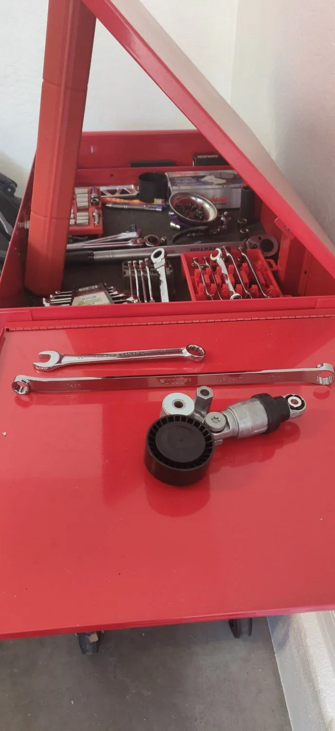

yrwei52, I kept the original tensioner in the 2013 there. I'm going for the record lol!!! It's in excellent shape. Aside from general dust it looks new. Is the original version too. I could not access to take a pic of the part number but pretty sure its the very first version. Perhaps its because its the 2.0 engine and there's less stress on it? So my backup spare New Tensioner is still waiting patiently in my tool cart:). I'm keeping a close eye on the revised tensioner in the 2.5l Mazda6. It too is still good.......for now. I highly recommend anyone to invest in a long reach 12mm and 17mm boxed wrench with slight offeset. You can also do a search for aviation wrenches as well. Sockets won't do good let alone fit down there.

I think I'm blind but I don't see any leaks in your photo unless you're referring to all the debris and grit that's stuck onto your belt tensioner. Otherwise, for someone that has never seen it before, it's hard to tell lol
My car has about 64k miles so I don't know if it's worthy of replacing it yet.
