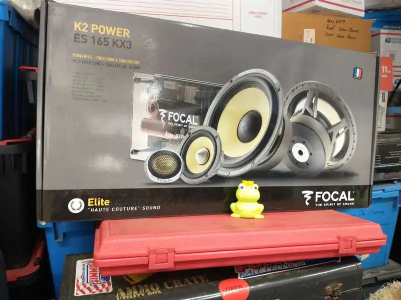

GoFrogs I guess I shouldn't mention I have a full sets front rear of Focal Elite ES 165 KX3 in my MAZDA doors and while the sub frequency below 250Hz was not the goal the Lower mid-range is extremely complex and I like to think competition worthy. 😄

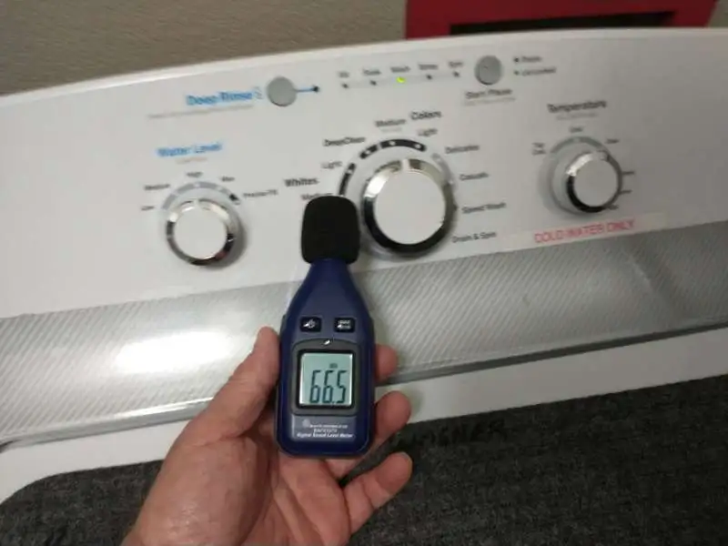

I don't guess at this information but use a simple hand held DB Digital Meter.
