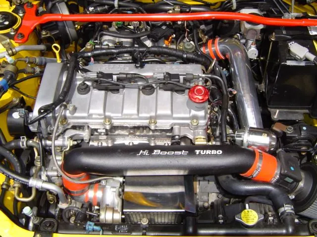

We have the starter kit. Cast manifold, Ball bearing turbo, downpipe, J pipe and intake system for USD$1,320.00. All parts are brand new and the turbo is capable of 330 WHP. This turbo will out flow the GT25R, GT28R and GT28RS.

Well, this is the starter kit. We also offer the Haltech EMS, Either the F10X for fuel only or the E6X for fuel and timing control.
The turbo is an IHI VF22 ball bearing turbo, which is very well know in the Subaru WRXs. It is a very compact unit and its performance is unbeatible.
We also have a complete turbo kit wilth everything ready to boost to 220 WHP. USD$3,800.00
