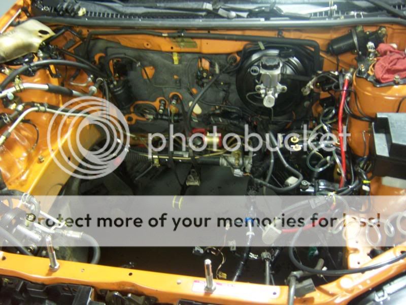

Current Engine bay pics everyone

current engine bay pic:
(LOLOMGWTF???)
