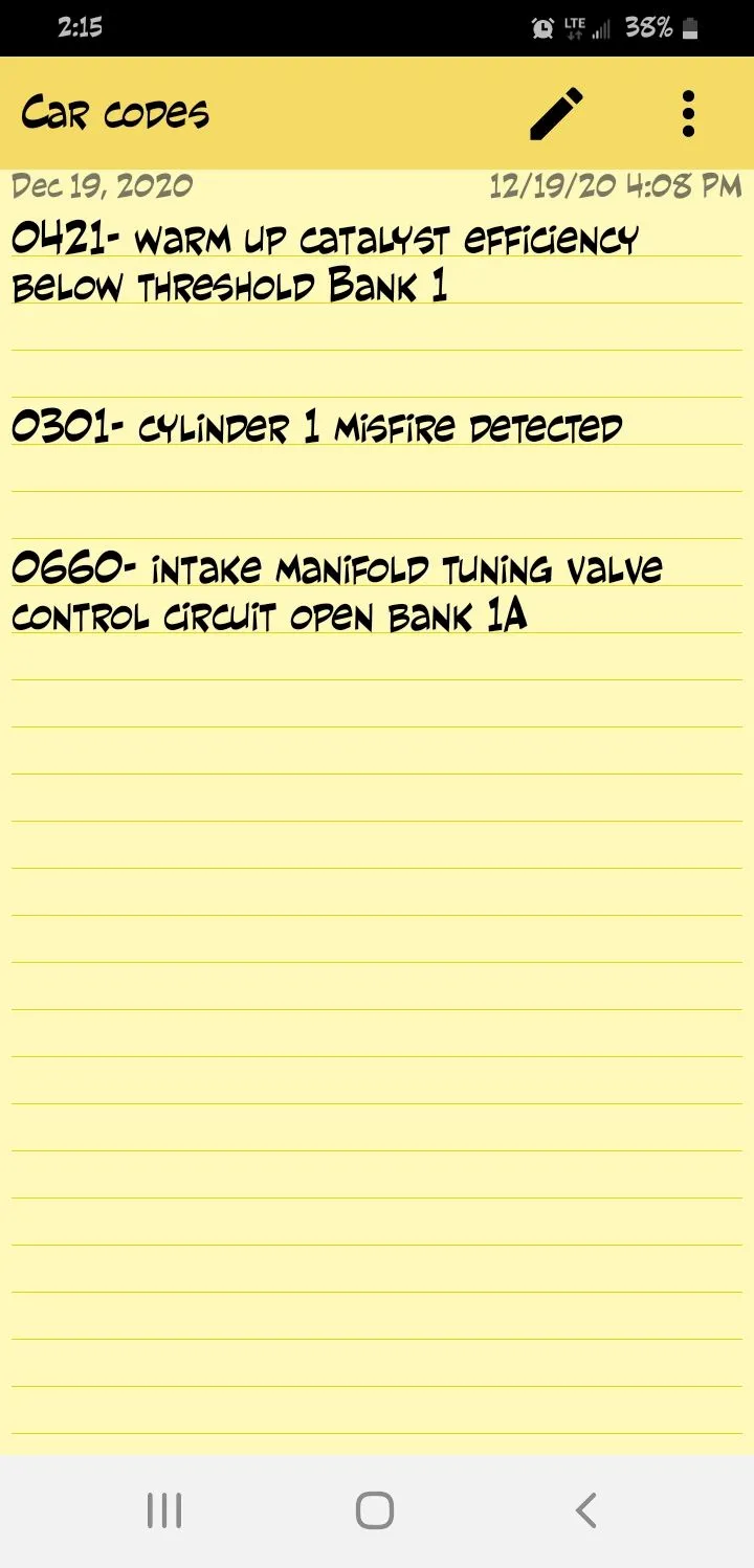

Do you have any codes, or does your car have any driveability issues?
(Other than the recent idle issue.)
Start with your codes and work from there.
Upvote 0
I've done that also. It throws a bank low code, misfire code, and o2/catalyst code. All sensors been changed, new plugs and packs, exhaust good. It was a thread on here that helped me test things like my exhaust, and watch listen and feel for the fluctuation in my rpms, finally realize it was a vacuum leak.

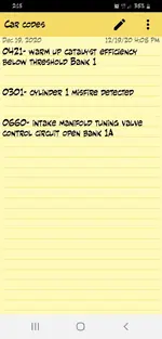

These are the codes it first gave me, 660 is gone now. And another one took its place. I'll run it again this evening. Got alot going on it's my day off today
