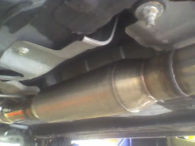

This 12" Oval helped a ton, drone is way down, and as is shows above DBs are down very close to stock. Under hard accel and spirited driving the exhaust note is still there, albeit less noise. I am very pleased with the results and plan to still do Dynamat/Shield to make the cabin very quiet, that will also be followed with DB levels.
I am attaching pictures of the system, this will show others the quality I always speak of when it comes to CPE... I mean, look at the welds, those alone are beautiful. Josh, Jordan, and Anthony... thank you guys for all your help and always taking the time to talk with me.

One other thing I forgot to mention. To make the 12" Oval fit better and with no rubbing, the heat shield must be bent in a touch. The is plenty of room behind the heat shield, and all we are talking is a couple taps with a hammer to bring it in about 1/4"
Jim
