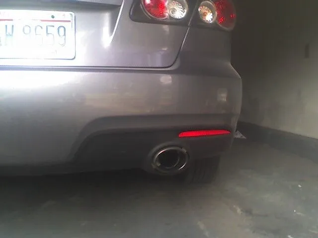

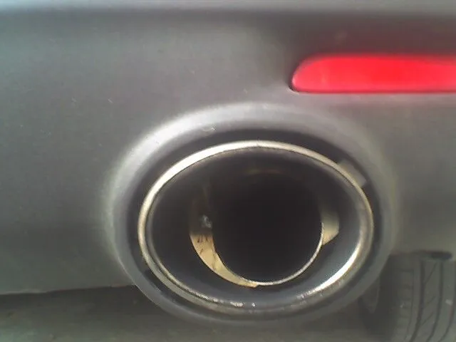

Mdogg, what do you mean "square ends"? The oval muffler is, oval in shape, and straight through design. (Jordan, maybe you could post a picture or two of this muffler. I didn't think to do it before installation.) You could mean that the 12" muffler isn't flush and is mounted sideways... I don't see how this would increase any power loss.
Anyway, I had the system for 1 week before the 12" install, and I drive for a living so I spent quite a bit of time in the car in that one week. At max, I'd say.... MAX 5 hp loss.
If this was a chambered muffler I could understand your thoughts, but with a straight through design, power loss isn't coming from adding this muffler. It only helps the sound, because it acts like a resonator (bouncing the sound off the muffler packing to minimize noise.) but in larger form. (12" oval vs. 14" long x 6" wide resonator) Here are two pictures also to show it from ground level, and inside the opening. I hope this helps Mdogg. If not, Jordan is watching this post, he may be able to help as well.
Lastly, imo, if you want pure power and don't care about how loud it is, go with the regular system. But if you want power and want it a bit quieter, this is one way to go. I just want to help anyway I can. Thanks again though for the great question and I hope I answered them.

LOL, Jordan, are you reading my mind now? As soon as I clicked "submit" asking for pics, the are already there.... (thumb)
