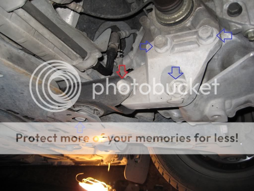

Yep, that's probably the case. My photos of the first gen are of a 3, not a MS3. The 2010 3 does have a cast aluminum bracket. I was probably inferring incorrectly. You mind taking a photo of yours before you take it apart? Just something of the bracket/mount combo.

No problem at all. I'll snap a few pics and post or email to you.

The mount on a gen 1 2007 speed 3 is a cast aluminum piece as shown in my photo below. I followed the Corksport instructions for a 2010. The only thing I would change on those directions is that you dont need to remove the bolt holding the mount to the transmission bracket (red arrow). You only need to remove 3 transmission bracket bolts and the 1 motor mount bolt (blue arrows). Bolts came of easy with an 18" breaker bar. Guys complaining that they are hard to get off must be WEAK-SAUCE. Lol, jk.
