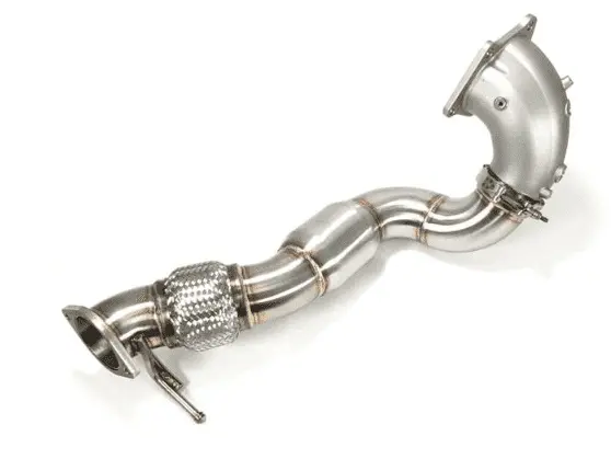

๐‘‚๐‘ข๐‘Ÿ ๐‘‘๐‘œ๐‘ค๐‘›๐‘๐‘–๐‘๐‘’ ๐‘ข๐‘ ๐‘’๐‘  ๐‘Ž ๐‘ก๐‘ค๐‘œ-๐‘๐‘–๐‘’๐‘๐‘’ ๐‘‘๐‘’๐‘ ๐‘–๐‘”๐‘›, ๐‘š๐‘Ž๐‘˜๐‘–๐‘›๐‘” ๐‘–๐‘›๐‘ ๐‘ก๐‘Ž๐‘™๐‘™๐‘Ž๐‘ก๐‘–๐‘œ๐‘› ๐‘’๐‘Ž๐‘ ๐‘ฆ ๐‘ค๐‘–๐‘กโ„Ž๐‘œ๐‘ข๐‘ก ๐‘กโ„Ž๐‘’ ๐‘›๐‘’๐‘’๐‘‘ ๐‘ก๐‘œ ๐‘ค๐‘Ÿ๐‘’๐‘ ๐‘ก๐‘™๐‘’ ๐‘ค๐‘–๐‘กโ„Ž ๐‘Ž ๐‘ ๐‘–๐‘›๐‘”๐‘™๐‘’ ๐‘™๐‘Ž๐‘Ÿ๐‘”๐‘’, ๐‘๐‘ข๐‘š๐‘๐‘’๐‘Ÿ๐‘ ๐‘œ๐‘š๐‘’ ๐‘๐‘–๐‘๐‘’. ๐‘‡โ„Ž๐‘’ ๐ท๐‘œ๐‘ค๐‘›๐‘๐‘–๐‘๐‘’ ๐‘ ๐‘ก๐‘Ž๐‘Ÿ๐‘ก๐‘  ๐‘ค๐‘–๐‘กโ„Ž ๐‘Ž โ„Ž๐‘–๐‘”โ„Ž-๐‘“๐‘™๐‘œ๐‘ค๐‘–๐‘›๐‘” ๐‘๐‘Ž๐‘ ๐‘ก 304 ๐‘†๐‘ก๐‘Ž๐‘–๐‘›๐‘™๐‘’๐‘ ๐‘  ๐‘†๐‘ก๐‘’๐‘’๐‘™ ๐ต๐‘’๐‘™๐‘™๐‘š๐‘œ๐‘ข๐‘กโ„Ž, ๐‘กโ„Ž๐‘’๐‘› ๐‘—๐‘œ๐‘–๐‘›๐‘ ...

Nice piece of hardware. Looks like you guys spent a great deal of time developing this kit.

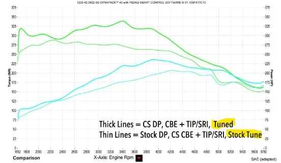

Question: why do you show your down pipe with a TUNED ECU vs and stock down pipe on a STOCK tune ECU? For a fair comparison, run a stock downpipe with a tuned ECU...
Looks like apples and oranges and misleading. Makes me guess it didn't help much.....??
I hope that I'm wrong.

More power on an apples to apples test?
