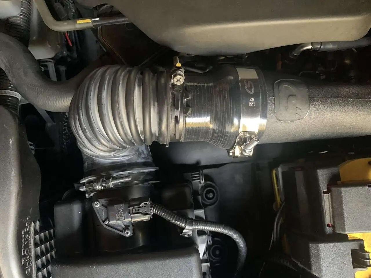

2019 Cx-5 Turbo:
Can confirm, the factory airbox and CS TIP are compatible!
Additional items needed:

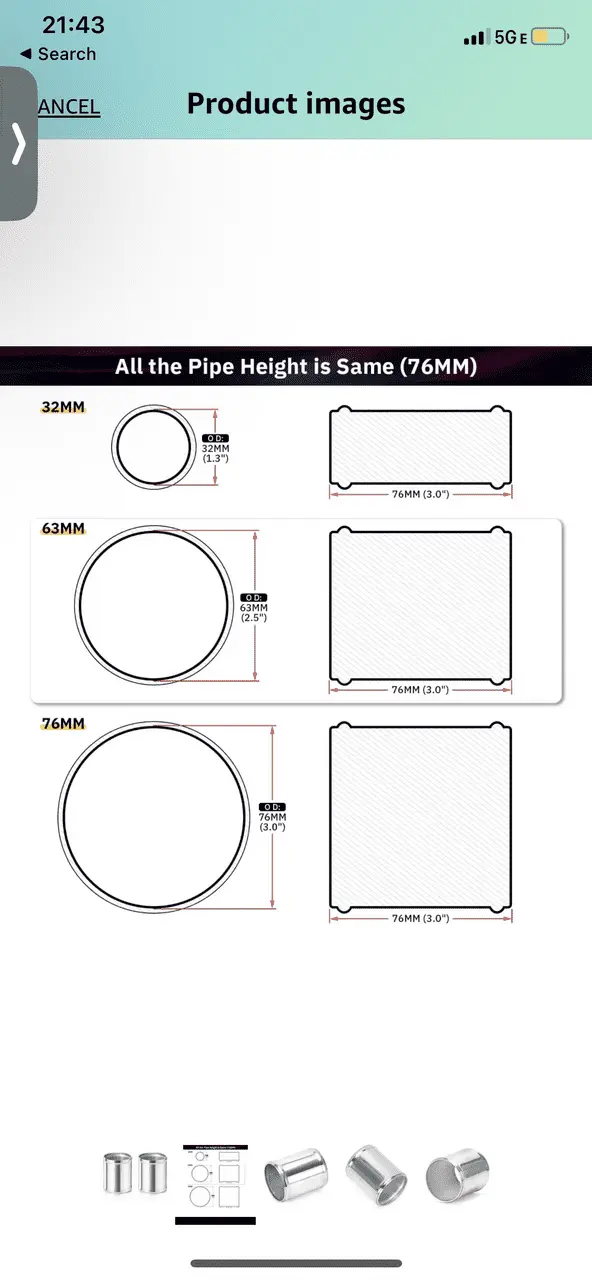

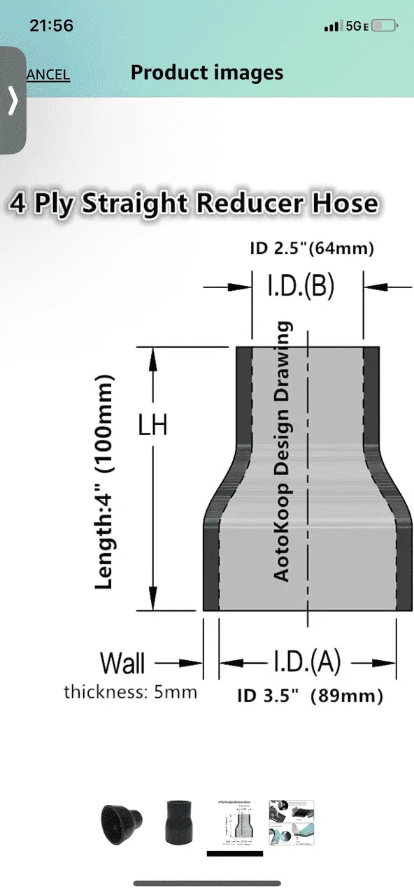

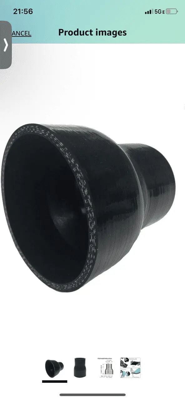

- 1x joiner pipe with 2.5" OD, 3" length.
- 1x silicone coupler 2.5" ID to 3.5" ID, 4" length
- 1x t bolt hose clamp for 2.5" hose
- 1x t bolt hose clamp for 3.5" hose (used the corksport t bolt clamp provided by the CS TIP kit)
I test drove for about 10 miles: the Ultragauge Long and Short Fuel Trims were normal, Intake Air Temperature was as expected and remained cooler than SRI, and no CELs. Subjectively, the Cx-5 was driving great!
Other information learned:
- the factory airbox requires a 3.25" silicone hose
- the CS TIP requires a 3.5" silicone hose

when connecting the OEM airbox to the CS TIP, instead of the OEM 90 degree 3"-2.5" accordion connected to the 2.5"-3.5" silicone, could you have just used a single 90 degree 3"-3.5" silicone between the airbox outlet and CS TIP inlet, w/appropriate clamps? i feel it would be much more clean and streamlined if this were possible.
i'm contemplating getting this with the stock airbox, if i can clean it up a bit
I experimented with so many 90 degree elbow joints but they were all too short. And with joiners and silicone adapters it would be too long.
The benefit of the OEM hose is that it is way more flexible then the ply'd silicone hoses I tried.

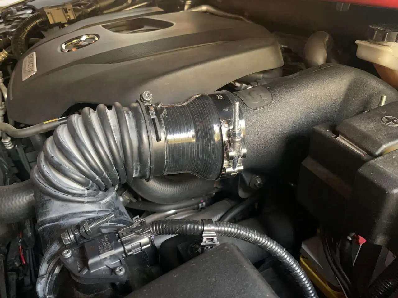

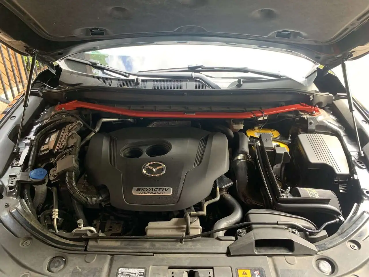

For reference, this is my attempt at using the CS TIP hose to connect the CS TIP to the OE airbox. Not alot of wiggle room nor flexibility of the hose. Also, there is a step in the TIP end of the hose that limits how far you can push the hose up the TIP.
If you are able to find a more streamlined solution please share!

darn...from the pic, it looks like you could cut off from the TIP end of the silicone hose by the same amount it is beyond the airbox outlet and get it to fit? i know it's not always as easy as it seems, though.
Unfortunately no because there's a step in the inside surface of the TIP end of the hose that 1) immediately decreases the hose's diameter and 2) stops the TIP from being pushed into the hose further

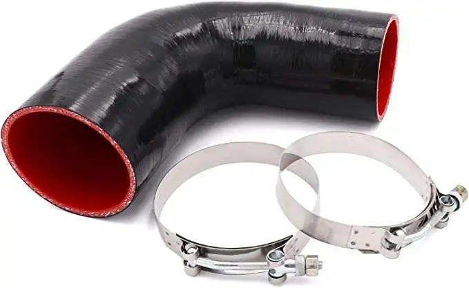

i'll think about it. i was thinking maybe something like this
I’ve tried with something like that but it was too long - however, looking back it may work if you trim/shorten it, which I honestly did not think to do.

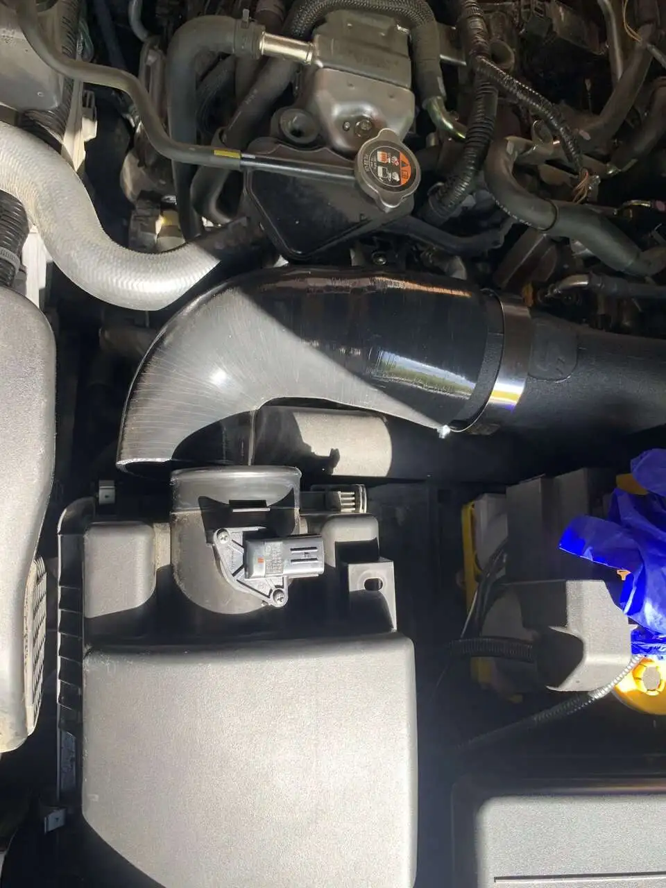

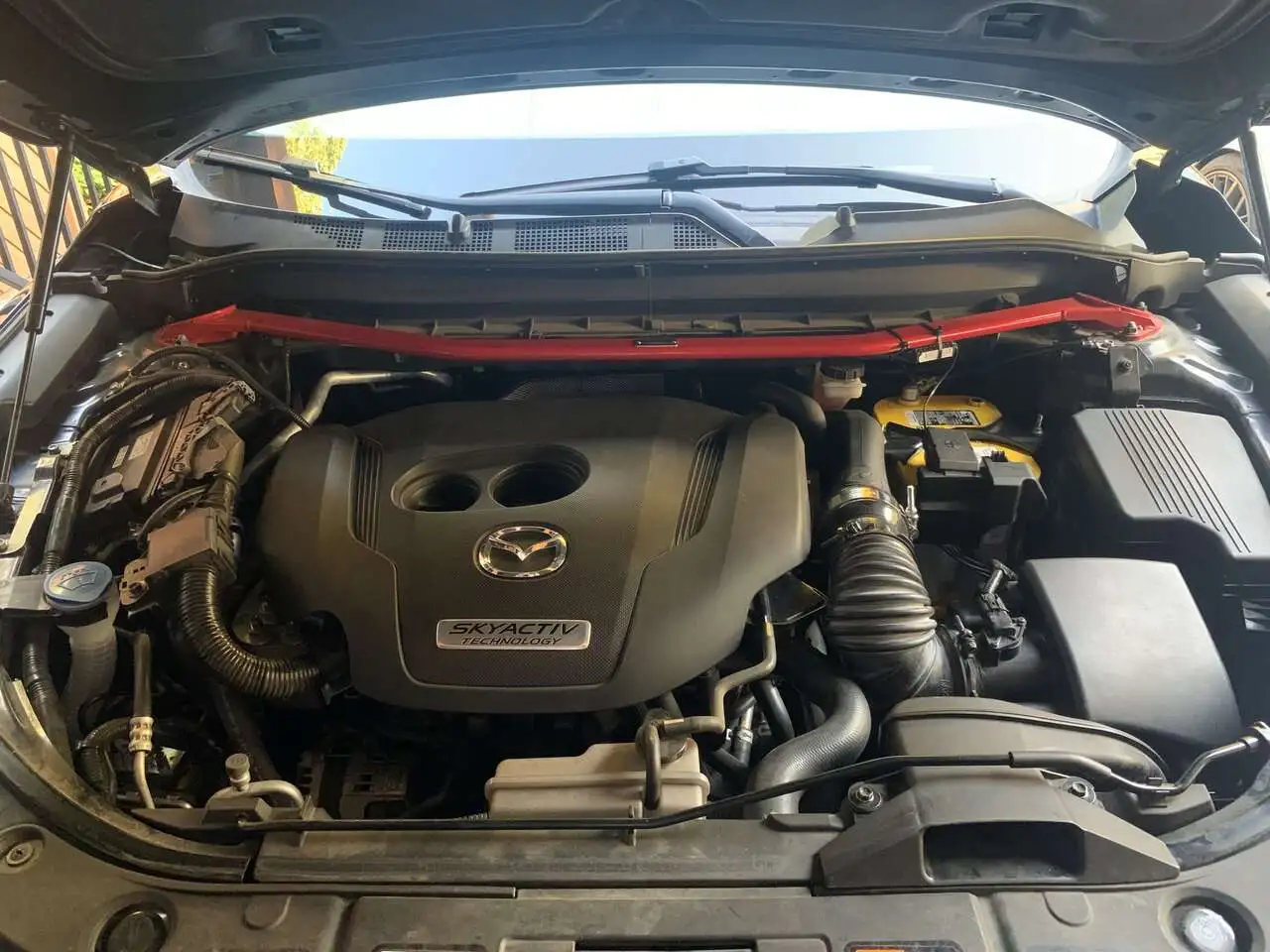

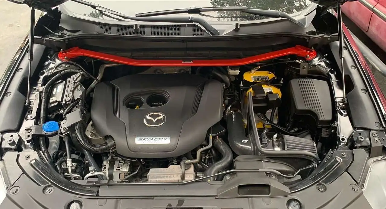

After studying your photos closely, compared to the OEM TIP, it seems the CS TIP inlet is elevated a bit higher. it is difficult to find or create 90 degree bend with elevation change that go from 3.25" to 3.5". idk...5h!t
maybe a 3.25" 90deg mated to a 3.5" 45deg
Just some photos to compare:

I want to replace the oem accordian with a 3.25" 90 deg. mated to a 3.5" 45 deg. OR a 3.25-3.5(90) butted up to a 3.5(45).
