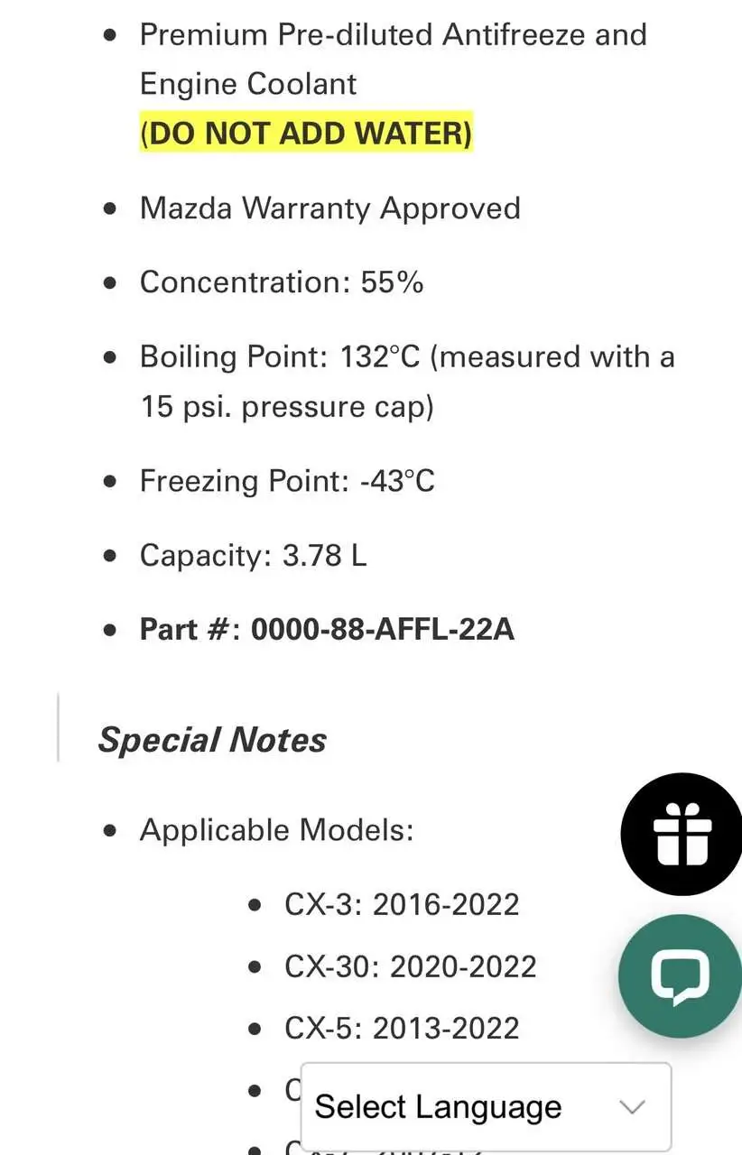

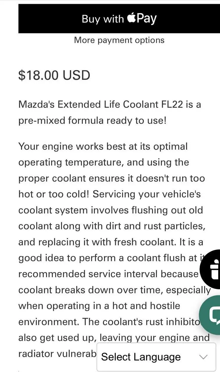

Not sure if the price is legit and how much for the shipping? But this Mazda dealer in Canada is a legit online Mazda OEM parts seller and has been used by many members here quite often especially for the Mazda Canada-only Premium floor liners. And they do ship to the US address.

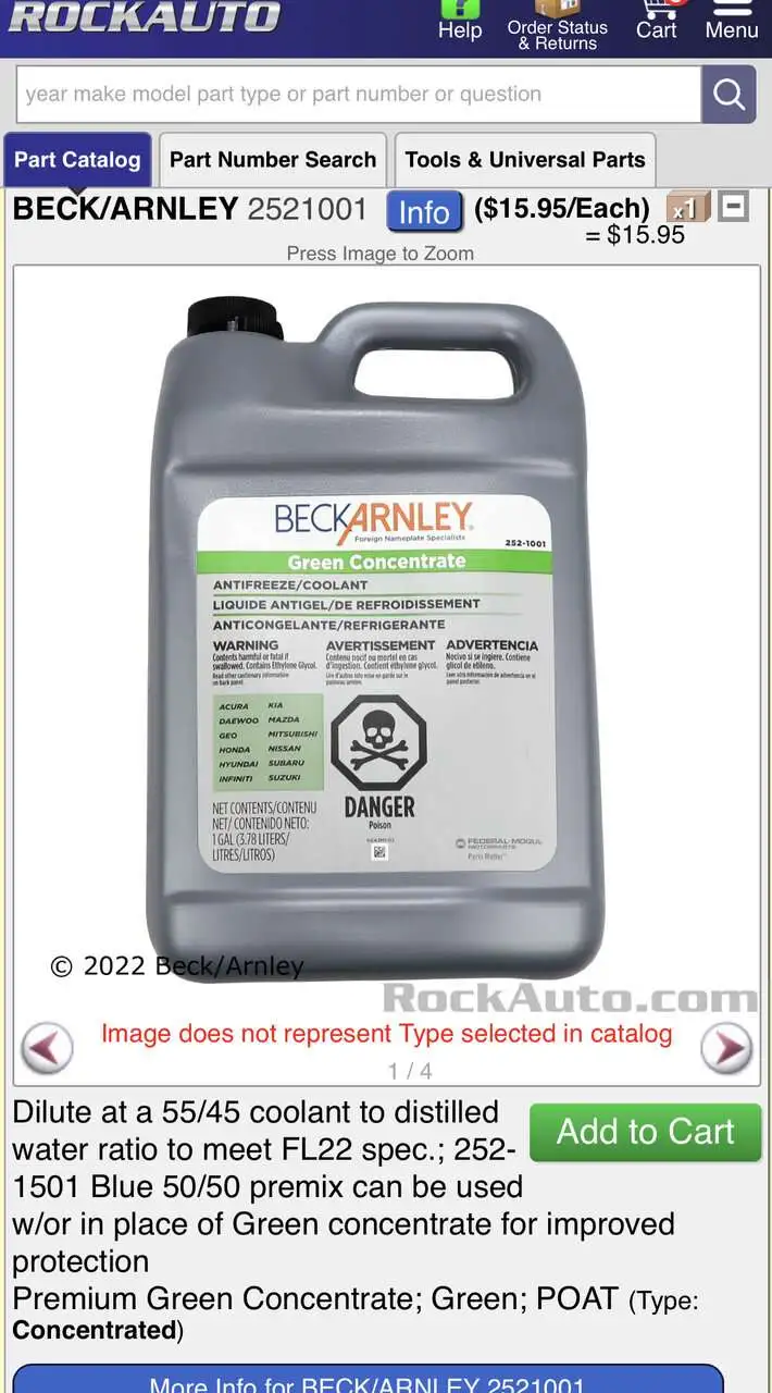

Hello, found this product.
Thanks for the tip. I don't know anything about that manufacturer but a good price on hard to find concentrate.
I'll have to see how it compares to zerex asian green concentrate (I know it's different than FL22) available locally .
Hello, found this product. View attachment 319618
The label claims the coolant is compatible with many brands of vehicles including Mazda. But Mazda has been using a couple of different types of coolant. I wouldn’t use this coolant to top off and mix with existing factory FL-22 coolant in the system. You can certainly try this hard-to-find concentrate on your Mazda CX-5 if you plan to flush the coolant system thoroughly. I personally will stick with FL-22 coolant specified by Mazda for the CX-5.
