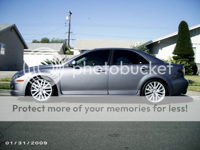

This is stretched:

im on 225/40s
m4tic:
Looks good. Are you satisfied with them? What brand/model did you go go with?
I am leaning towards the BS RE760. I am a huge BS fan. Pulled Dunlops off of my 4Runner and put BFG A/T on. Hated them. Sold them and and put on (and should have put on in the first place) BS Dueller A/T REVOs. Put BS on my Monte Carlo (when I had it) after the GY Eagles. So much better. Made the mistake of putting GY F1 GSD3s on my Miata.
One more thing: did you lower the car after putting the 225s on? Or how did it look with the stock height? Probably not too much difference, I would assume.
i have kumho ecsta ast's, they're a hit with me so far. i dropped the car after the tires, i dont have pics at stock height ( i cant stand looking at the pics i do have at stock height, ugh) also i went with a lower profile because im planning to swap in some 18x8.5 wheels, and stretch just a tad.
