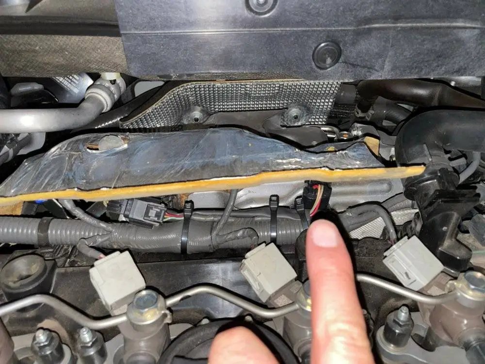

This is the sensor that was replaced.. Yes this one has a steel stem going down to the exhaust manifold over the plastic one it replaced. Must be pretty hostile for electronics there. (Note that they added a adapter cable to match this sensor to the existing loom also.
Upvote 0
Thanks thi8ght so . C9de came up other week garagecreopaved 2 rear ones said they had carbon in them but this 1 in question not been changed . I to want to use compressed air to blow down the steel tube that the rubber hose connects to to be sure it's clear as they can also get blocked so I'm hoping to get ut today at some point and do it later ir better tomorrow at latest . Shouod be free as it's a common issue but it's not here in UK
