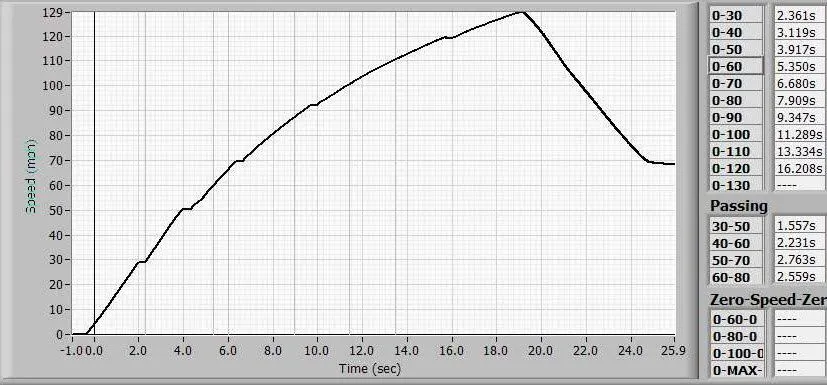

5.9-6.1 with current mods. Depends on ambient temp and conditions, such as the presence of wind and which way it may be blowing. I usually just say 6.1, as that is typical even under less than ideal conditions. There are both a pdf and a jpg attached to one of my posts on the previous page of this thread, #11, with an accelometer data log showning a 6.0. That was a good run. I try to use the same level and mostly untraveled location and average the runs in both directions to try to eliminate any variables. Usually works out in the above range. The data logging accelerometer is more accurate in measuring time and speed than a hand held stopwatch and looking at your speedo, but a stopwatch and practice can get you within a tenth.

My G-Tech Pro RR accelerometer produces identical numbers to that technique, but does require a full launch from first gear to data log and produce the chart. BTW: The better car mags who have automotive engineers doing the testing typically use digital accelerometers to gather the metrics rather than drag strip timers, which could not give you all of those intermediate time, speed, distance intervals. The accelerometers they use are a bit more advanced (and more expensive) than the current generation G-Tech i use, but the results are very close (usually within one tenth of a second). A good acceleometer is an excellent tuning tool, iMHO.

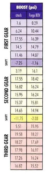

Grassroots Motorsports objectively tested the stock MS3 bpv against a 1st gen Forge. In third gear and higher (you probably dynoed in 4th?) the stock bpv consistently held about 1.5 to 2 psi higher boost than the forge.

What say ye about Grassroots Motor Sports chart attached here? It compares stock gen 1 MS3 bpv with Forge bpv. In third gear and higher, they found the stock valve held boost higher and longer. That is consistent with my experience that I just can't make the stock valve leak. And with a tune that allow full power in first and second, a quicker release or rise in boost is meaningless in first or second, because the tires just go up in smoke anyway! That's why I stayed with the stock valve. I can't make it leak.
I don't dispute your chart at all, but the Forge appears to work better in my application. (drive2) Your insight and knowledge are tops in my book!
Understood. No two of these little cars respond exactly the same way to mods. At the end of the day the person you have to make happy is yourself. The Forge bpv is a very high quality product and is highly respected.
