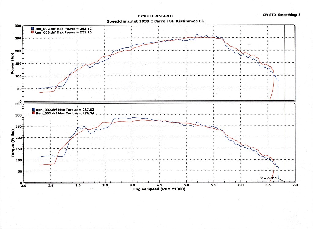

Here's the dyno, I actually made more power with the hood CLOSED. So nhluhr you're not completely correct.
Run 2 was a 5th gear pull.
Run 3 was in 4th with the hood closed, My first run isn't on here but it was lower than both with the hood open.
There were 3 other MS3's that day, in various stages of mods. I was right in the middle on whp and wtq
Interesting. Where's the dyno of the car with stock intake and identical atmospheric conditions?
