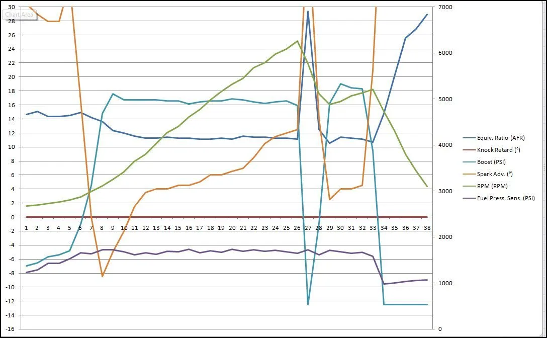

Well. Running the Economy map and the stage 1+ 91 map my LTFT's were perfect. Meaning the highest I would see was +5 and the lowest -2. Idle at 0. On the other hand the stage 1+ 93 map I was about +7 at idle and +11 accellerating. Wierd thing is I am seeing a steady 3.8 KR on the 91 map and the 93 map I would see very little. Maybe a spike of 1.8. Im changing back to the 93 map to reset the fuel trims.

yeah it looks damn near perfect. no problems that i can see. instead of equivalent ratio i always log actual afr. i dont know if there is a difference between the 2 just what i log.
i put it in a graph for ya.
just grab the data and insert into graph. i would search creating a graph in excel on google or something
