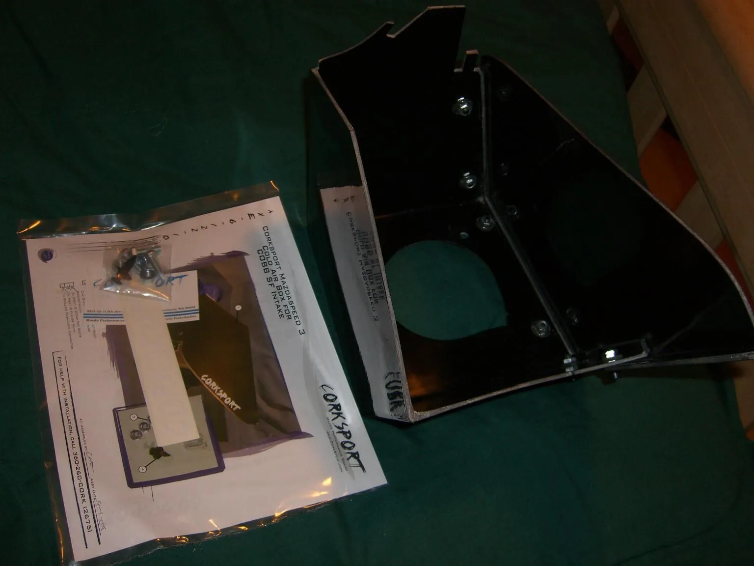

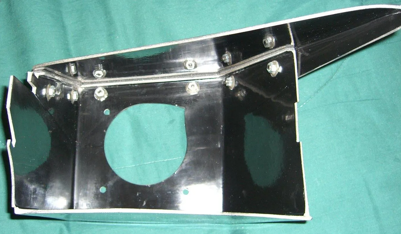

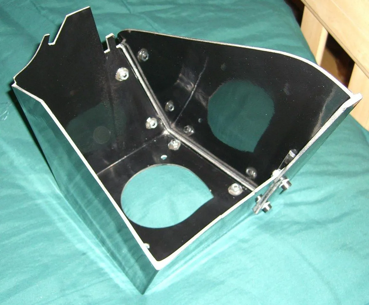

I want to see one disassembled to its component pieces, with each identified.
There are any number of us that would consider buying one and modifying it for whatever intake we have if we could see the pieces and judge if it might be possible.

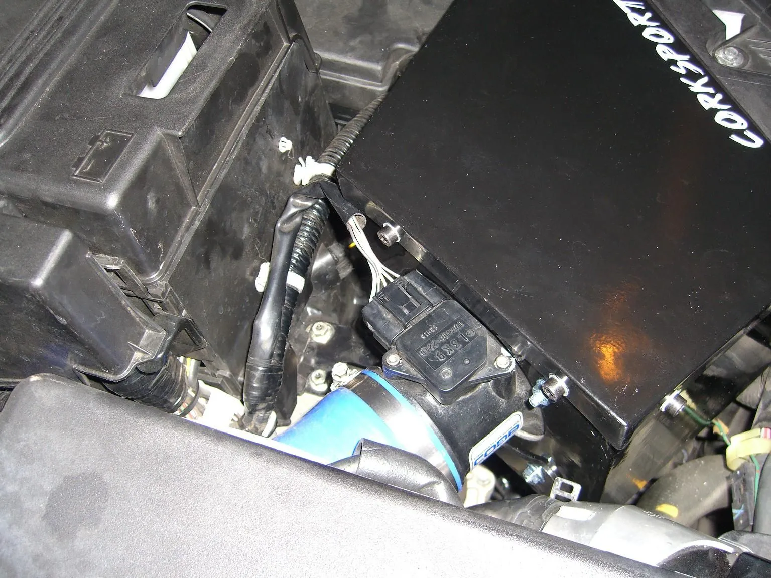

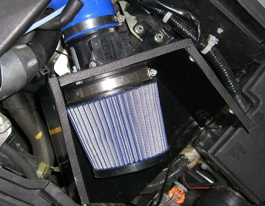

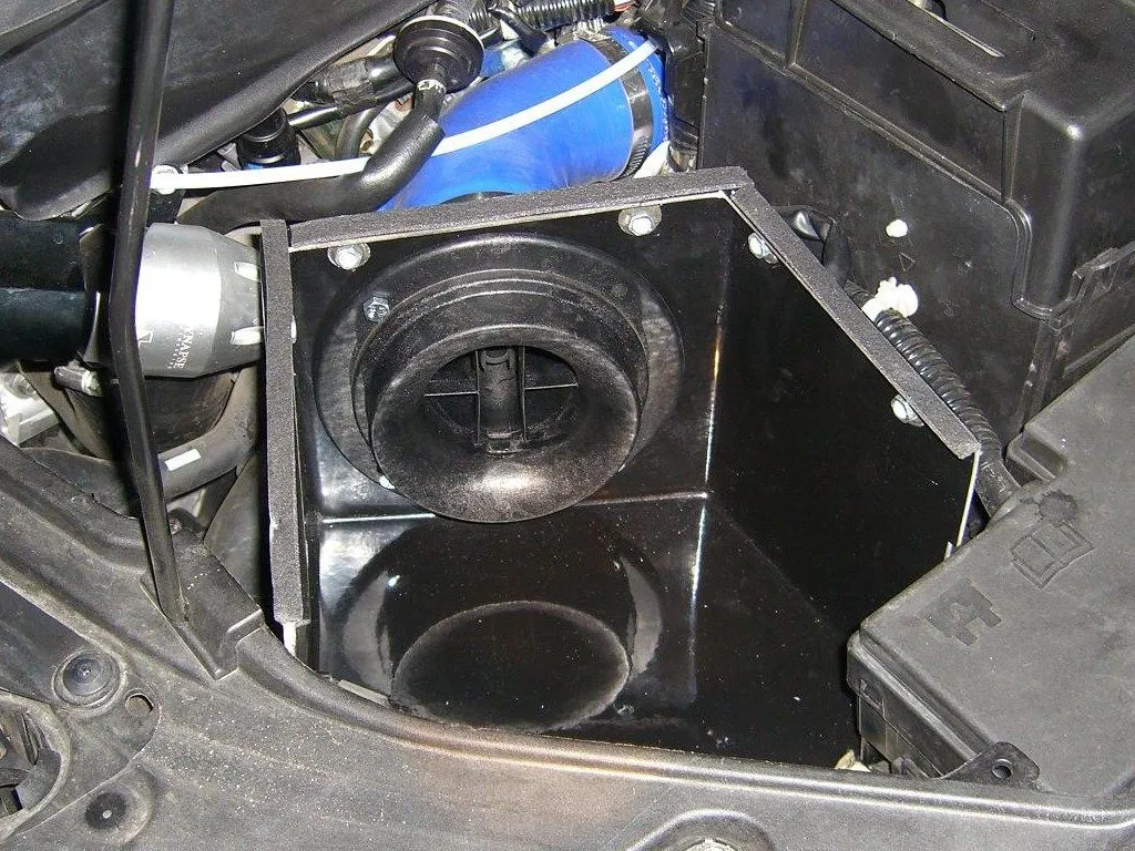

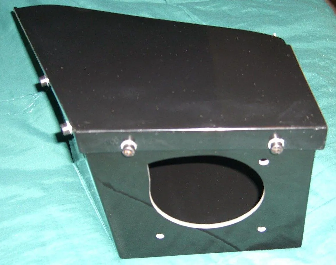

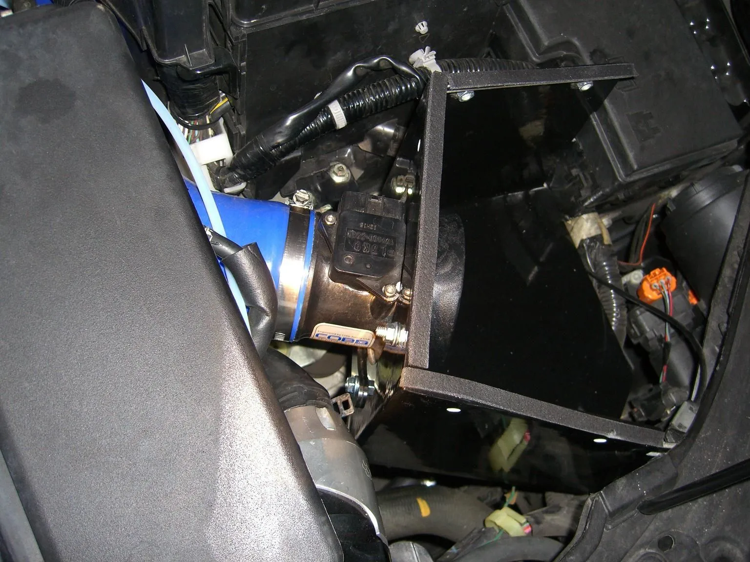

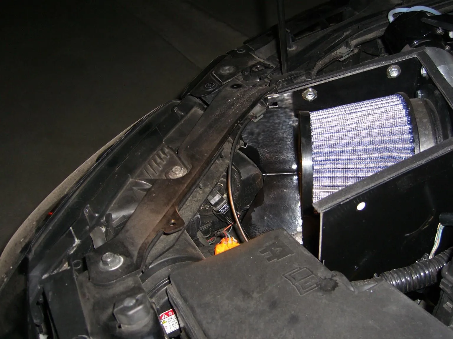

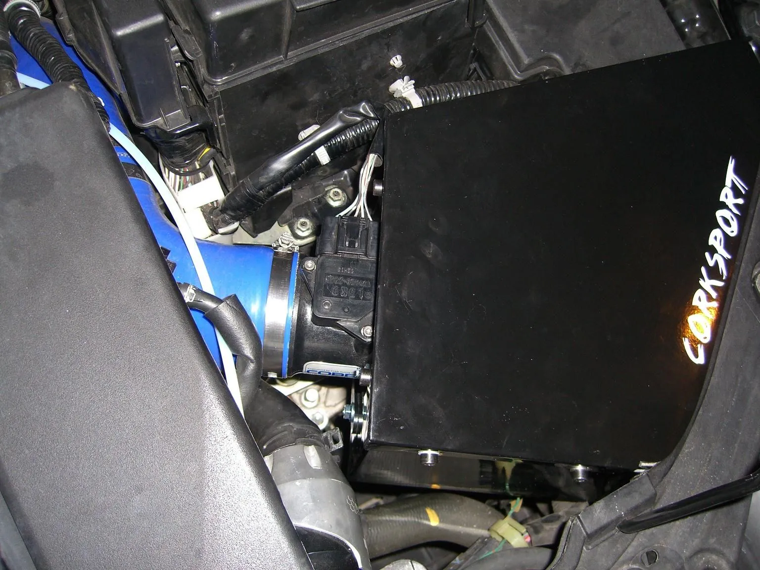

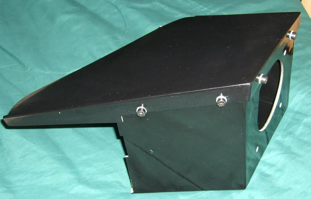

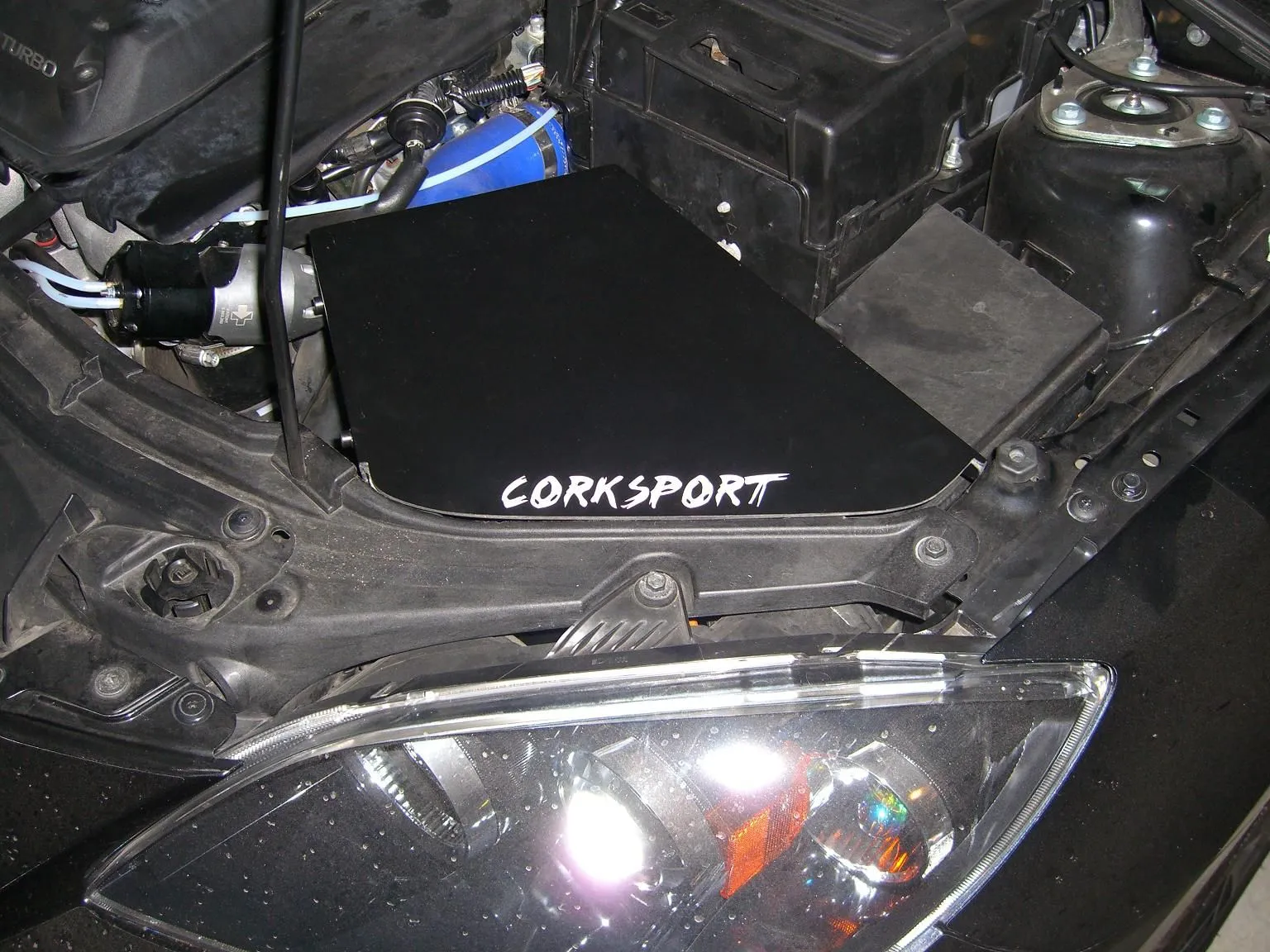

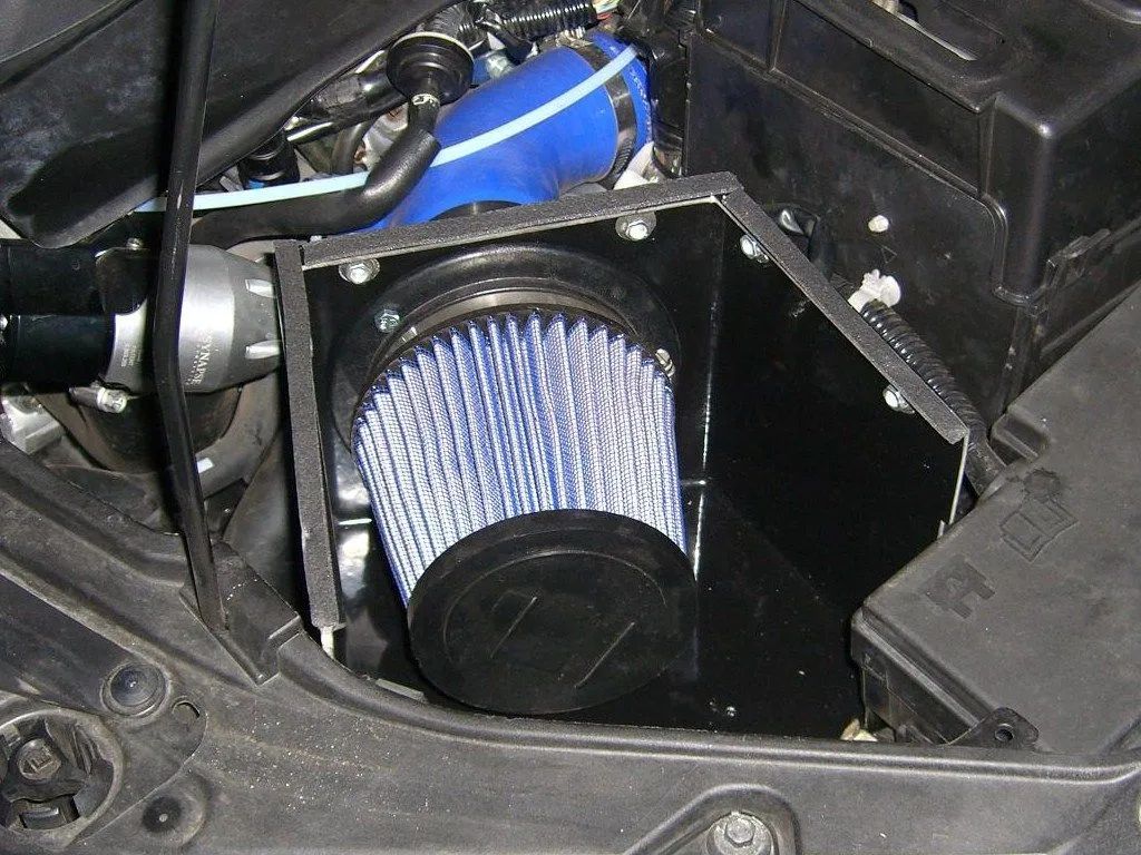

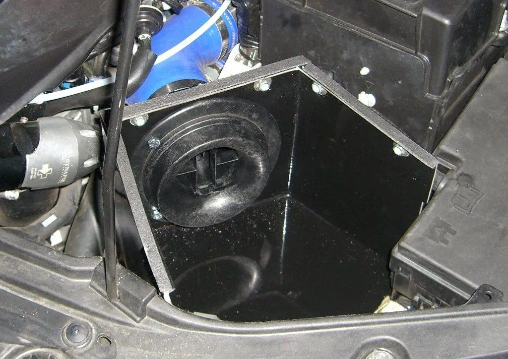

Installed mine tonight... took about 30 minutes using flashlight and security light on house lol... Seems to be made out of some type of plexiglass, or as CS says, "high temperature resistant fiber reinforced plastic". Great fit. Only suggestion to CS is to use lock washers on the 6 hex bolts holding the lid on, instead of just flat washers.
More...

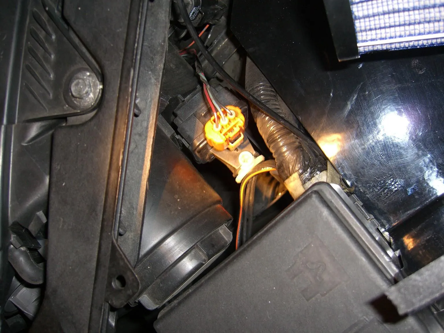

Pic 2 is hard to see, but beneath the lamp plug is probably where most of the cool air will come from... looks like it's between the fender liner and bumper cover...

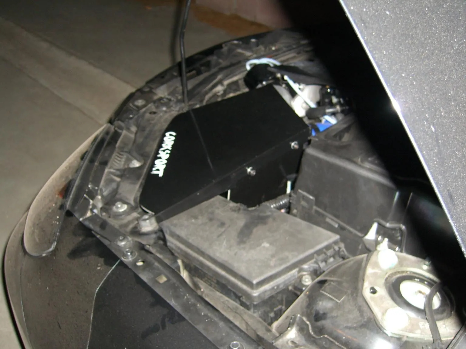

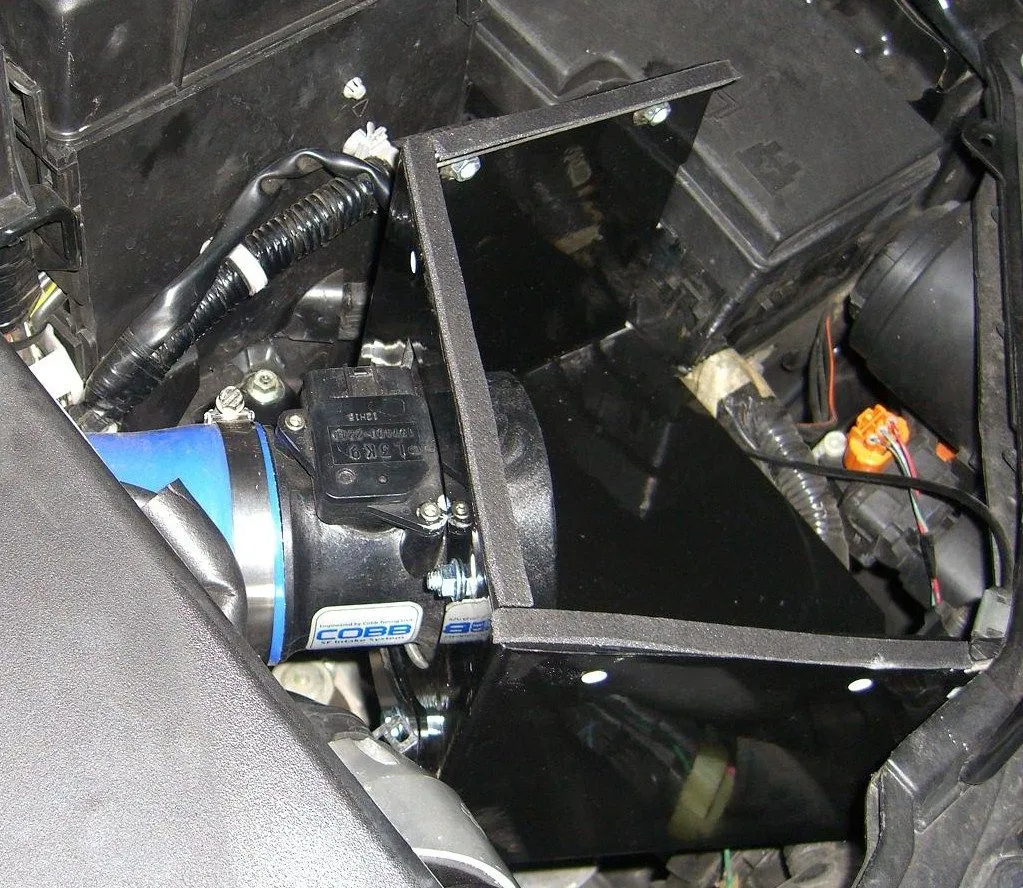

Instructions were kind of ok... left out the page about drilling a hole to use the nylon push screw if i wanted to attach the lid to the car frame... I didn't do that part though.. it's plenty secure as it is...
Also, don't forget to reattach the MAF sensor, like I did, <-- Fail... lol...

So it appears that the air source is the vents in the high pressure area of the inner fenderwell. Much like the CAI, but with a bit of a shield around the filter. I like the looks, which I suspect will be the primary gain from this if used as is.
I personally have other things to purchase first (both for the car and in other areas) so for now I will not be indulging myself with this piece, but I have ideas for which this could be very useful down the road. I just hope it is still available when I`m ready. I picture a completely heat tape wrapped intake (this isn`t about looks for me) with this thing ducted to the outside via large diameter insulated tubing. No place for underhood heat to penetrate the system. I`m not convinced that the so called CAIs sold right now are different enough from an SRI to have much of an effect. A sealed, insulated system might be enough to make a real difference.
