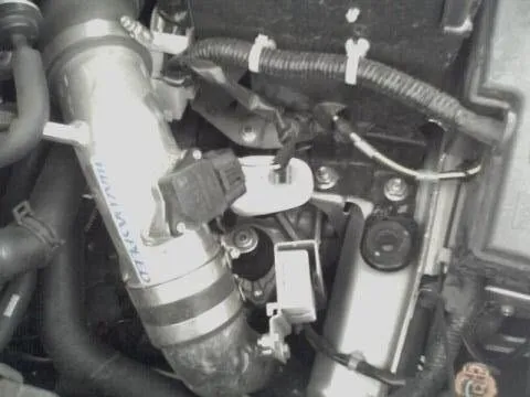

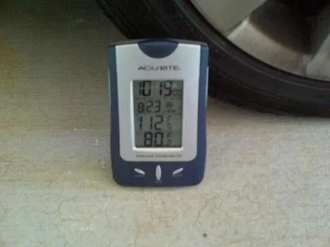

Here's what happens to underhood temps when the car sits at idle for 5 minutes from a cold start. The temp gauge has two probes. One is sitting under the hood on the rubber mount that formerly held the stock air box, the mount about 3-4 inches away from the MAF sensor. The other sensor is in the gauge and is on the floor next to the left front tire a few inches away from the CAI intake. 32 degree difference in five minutes and climbing. Hopefully the box might slow that down some.
