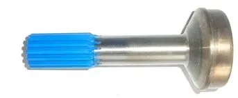

Im gettin tired of this, nobody helps in here, what are the splines exactly, any diagram or info,
Spline.
Attached is a picture of what a splined shaft looks like - the blue part is the splined portion.
I got it off the Internet with a simple search and about 2 minutes time. You could have too, if you'd have bothered to try.
I've found that people here are generally more than willing to share information and answer questions, if they know the answer. In the case of this clicking nobody is absolutely sure of the cause, or a definitive cure, yet. What they're conveying is what their dealers have done and the results they got.
