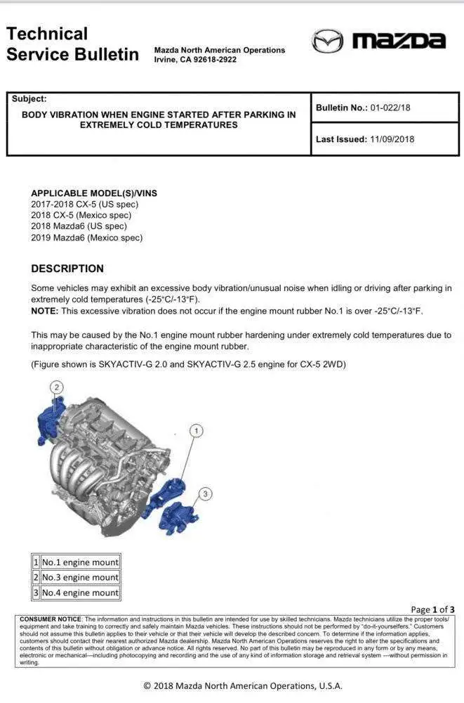

The newer engine and transmission mounts were introduced for gen-2 CX-5 since 2017. There’s at least one TSB on engine mounts which caused severe vibration in cold weather and Mazda had revised one of the engine mounts since then.
The failing engine or transmission mounts isn’t uncommon even in this community.
Does anyone know how many engine mounts a 2021 CX-5 Signature has? In doing some research online it seems like there are 3. The dealer is telling me they are going to replace 2 so I'm wondering why they wouldn't replace the 3rd?

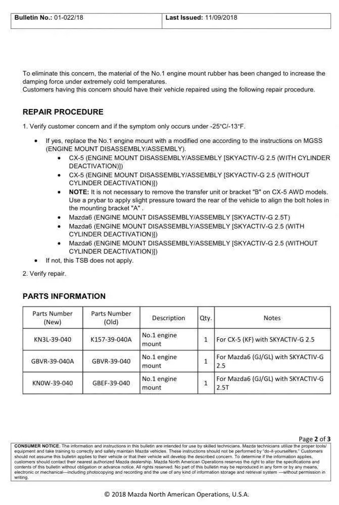

Yes, there’re 3 engine mounts for the 2.5L. This TSB shows 3 but only the No. 1 engine mount is having issues and needs to be replaced with a revised one. You have a 2.5T and the mounts may be different. Not all 3 would fail at the same time. You can ask your dealer to find out which one doesn’t get replaced and why.
TSB No.: 01-022/18 BODY VIBRATION WHEN ENGINE STARTED AFTER PARKING IN EXTREMELY COLD TEMPERATURES

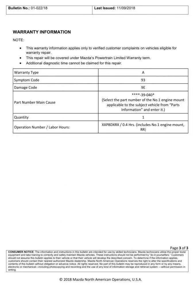

Are motor mounts covered under powertrains warranty? Or only under B2B ?
