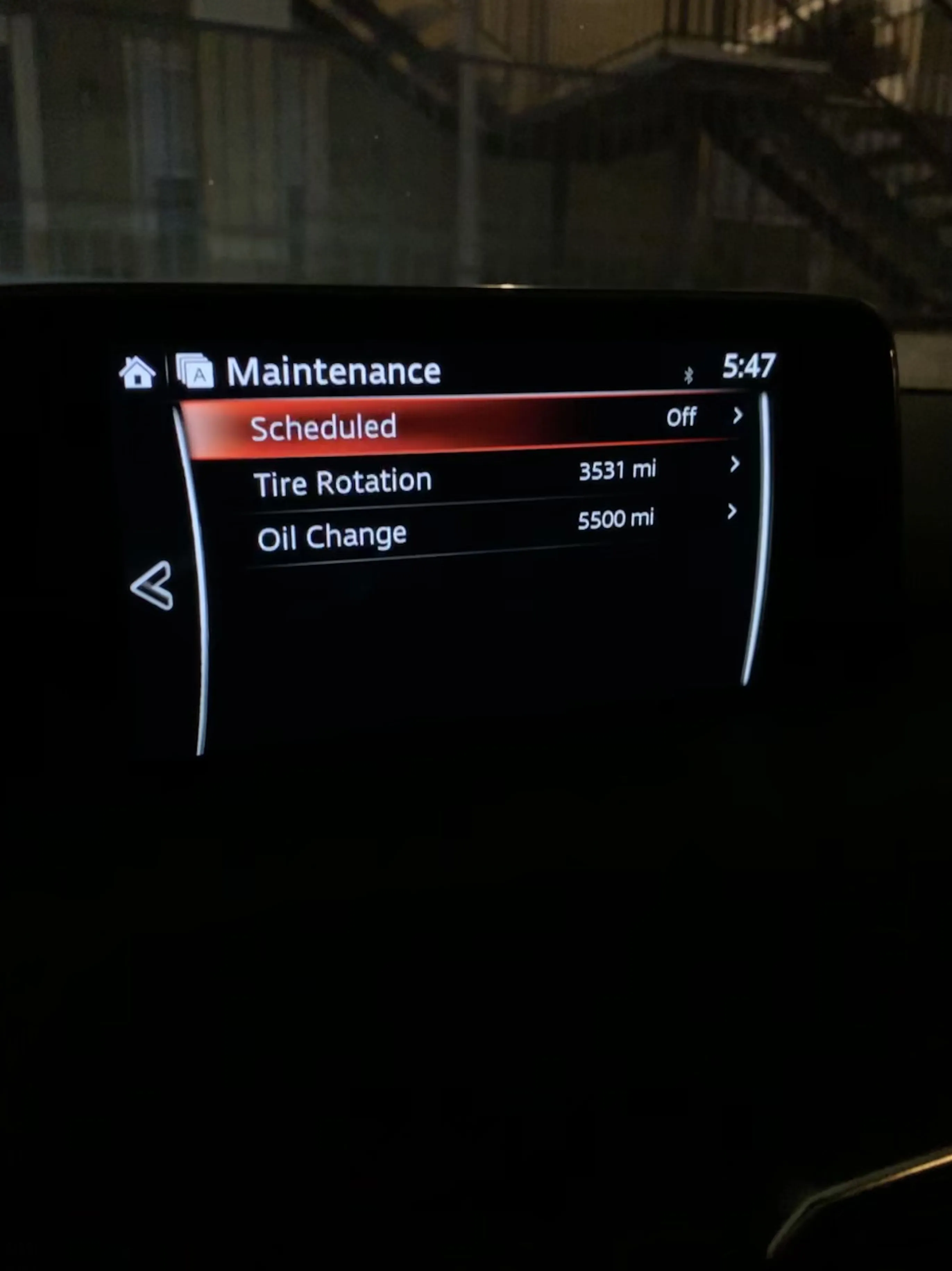

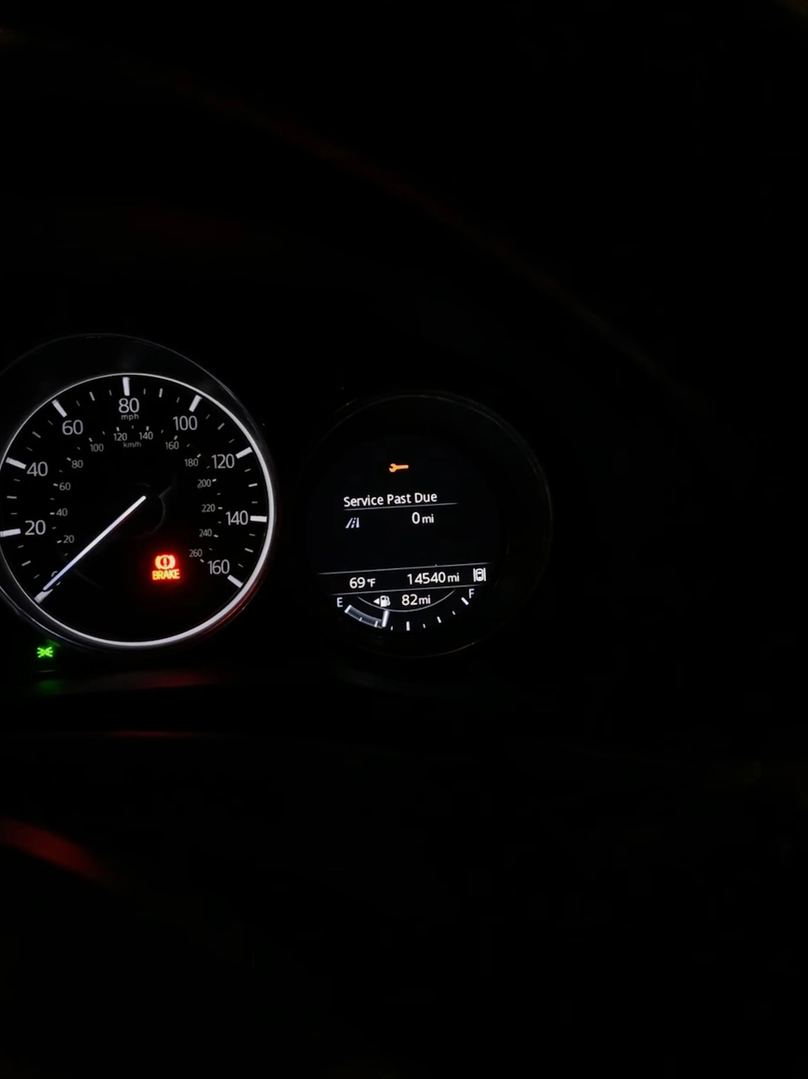

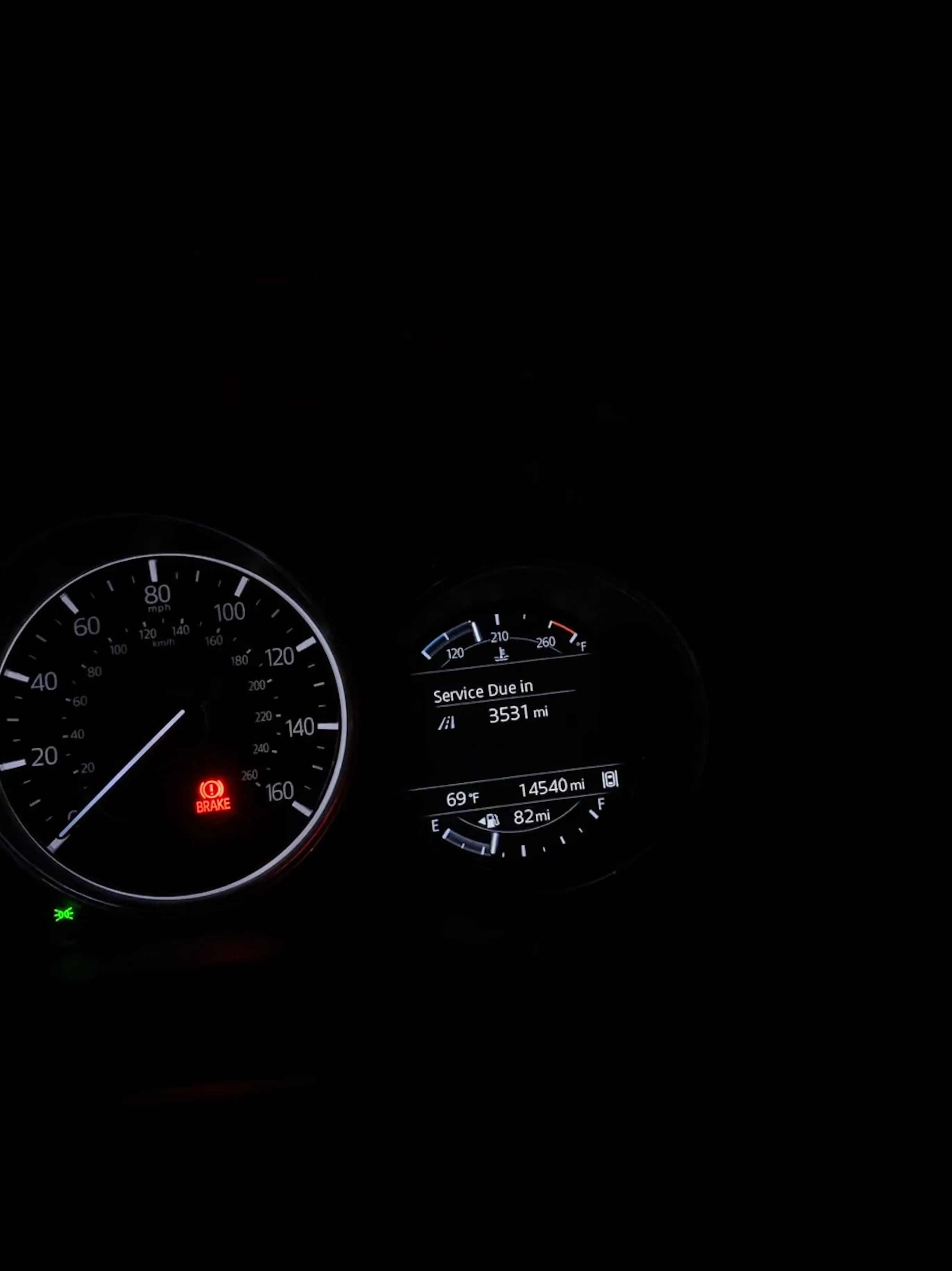

IMG_8924.webpIMG_1802.webpIMG_0660.webpI am having the same issue, I did my own oil change and reset the oil and rotation via the infotainment system. Everything was fine for about 2000 miles and now I'm getting "service past due 0 miles" Is the service being tracked via infotainment system and via dashboard computers separately? I never reset via the instrument cluster, I reset mine via the infotainment. When I turn on the car, it gives me the "service past due 0 miles" for about 20 seconds then changes to match was the infotainment system says. Is the computer just slow to read the info?
