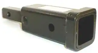

Are there II/I adapter plates for the bike rack? Not sure.
What are you all talking about? The only difference between a class I and II is towing capacity. Receiver attachment size and shape (receivers are not required) can vary, though they're nearly-always 1-1/4" square from a mass producer. If you have a name-brand hitch with a 2" receiver, you most likely have a class III hitch, though you may have a fairly unique class II.
In any event, if all you want is to use a 2" receiver mounted carrier on a 1-1/4" hitch, get the adapter from your local U-Haul or the etrailer one above or the same thing from any of a wide variety of similar sources. Just watch total tongue weight (class I is 200 lbs limit, class II is 350).
