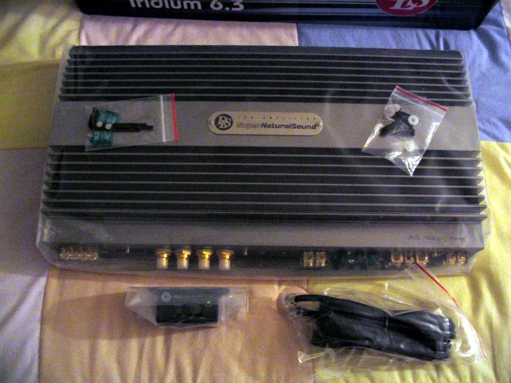

Here's what's going in:
DLS Iridium 6.3 components $700
DLS A5 3-channel amp (50x2 + 300x1) $500
2 Eclipse 87081.4 200 watt 8" subs $90 (ebay)
Clarion 9575rz Head unit $200 (refurbished, ebay)
Clarion DPH7500z DSP/EQ $42 (used, ebay)
Clarion CDC655z 6-disc changer $45 (used, ebay)
Total: $1577
I will post installation materials and cost when finished.

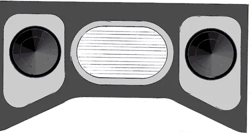

Obviously this is going to be a hardcore SQ setup. The DPH7500z, which is controlled by the head unit, has two modes. One gives you a 7-band graphic eq, the other gives you a 3-band parameteric eq (separate for front and rear). It also includes time alignment and some other goodies I probably won't use. Its not as flexible as a 30-band eq but it should give me enough to play with.
For installation, the midbass drivers will be installed in the doors. The tweeters will be installed in the stock mirror panel location. The dome midrange drivers will be installed in the kick panels. I am going to fabricate a new rear deck lid to hold the amp, subs, crossovers, and DSP/EQ. Attached is a rough draft of my design. The black will be vinyl, the grey will be painted to match the stock silver interior. The entire deck will be 3-5" thick and the subwoofer pods will be raised up and angled inward. The DSP/EQ and crossovers will be mounted on the bottom, probably behind plexy. The whole unit will be connected with minimal screws and quick disconnects. If I need more cargo space I should be able to easily remove it.
