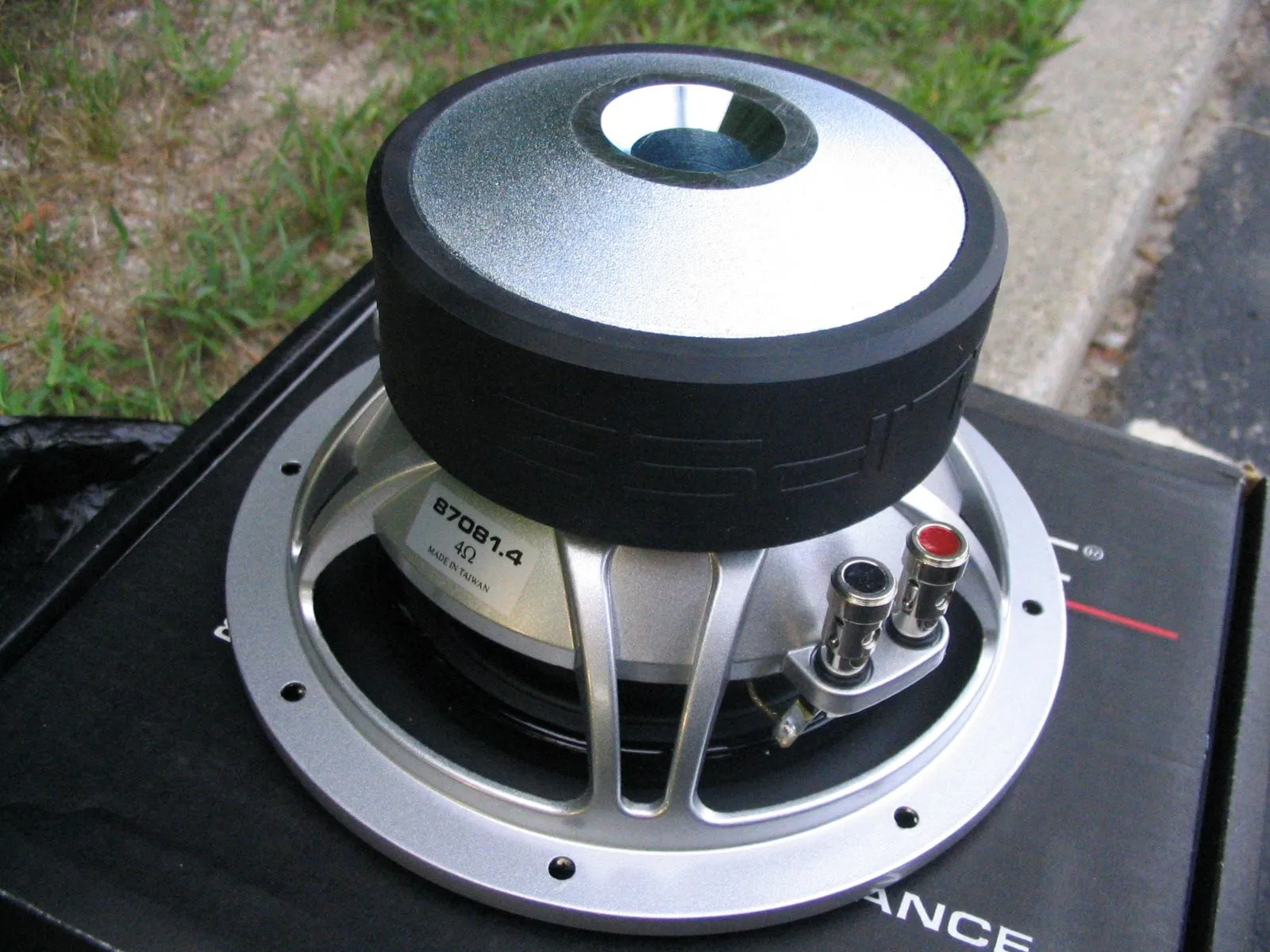

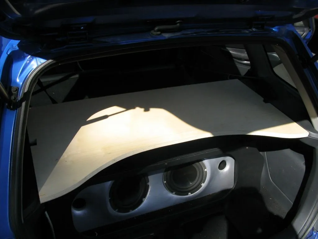

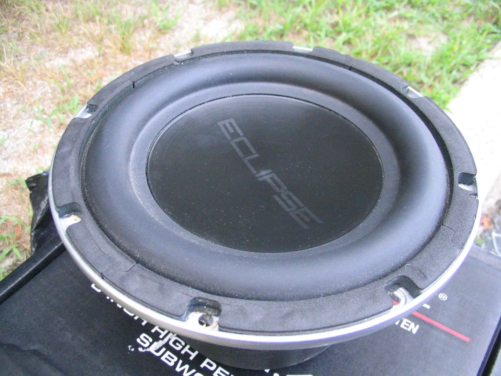

I forgot to post these pictures. Here are my 8" Eclipse Subs. 200W RMS.

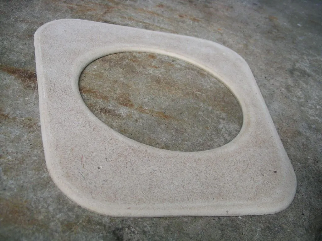

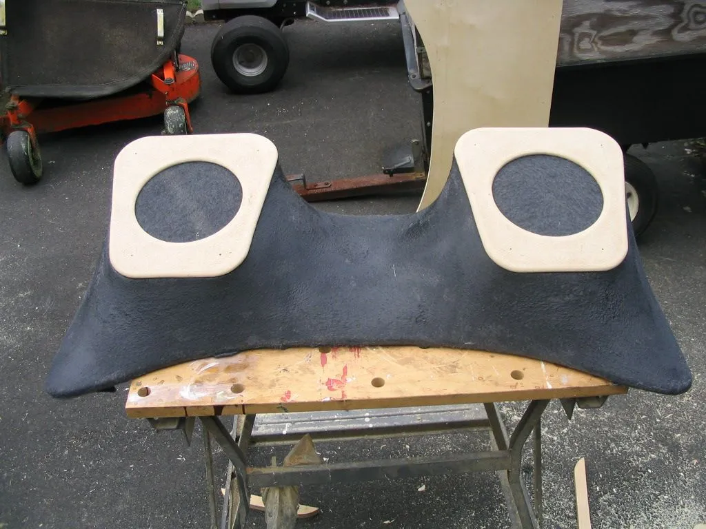

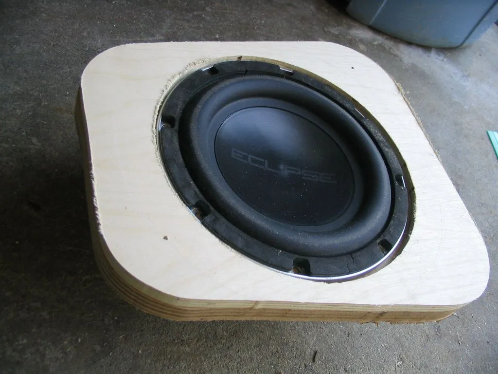

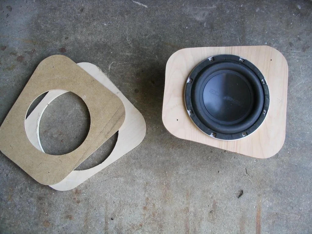

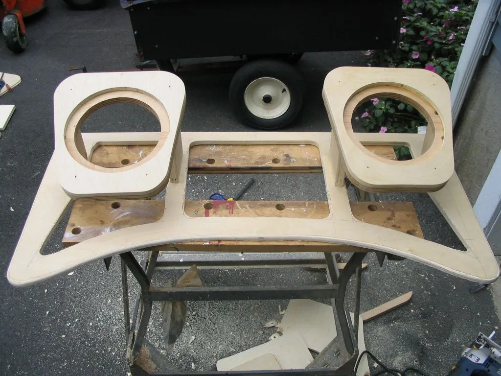

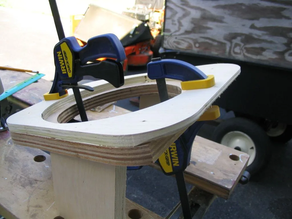

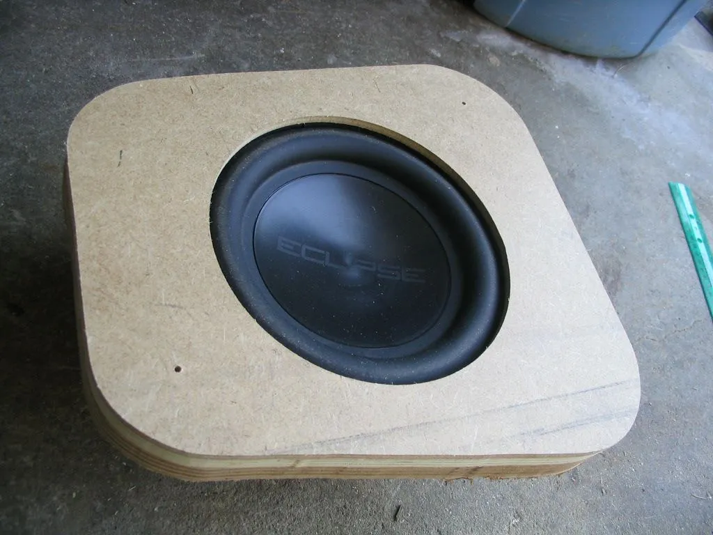

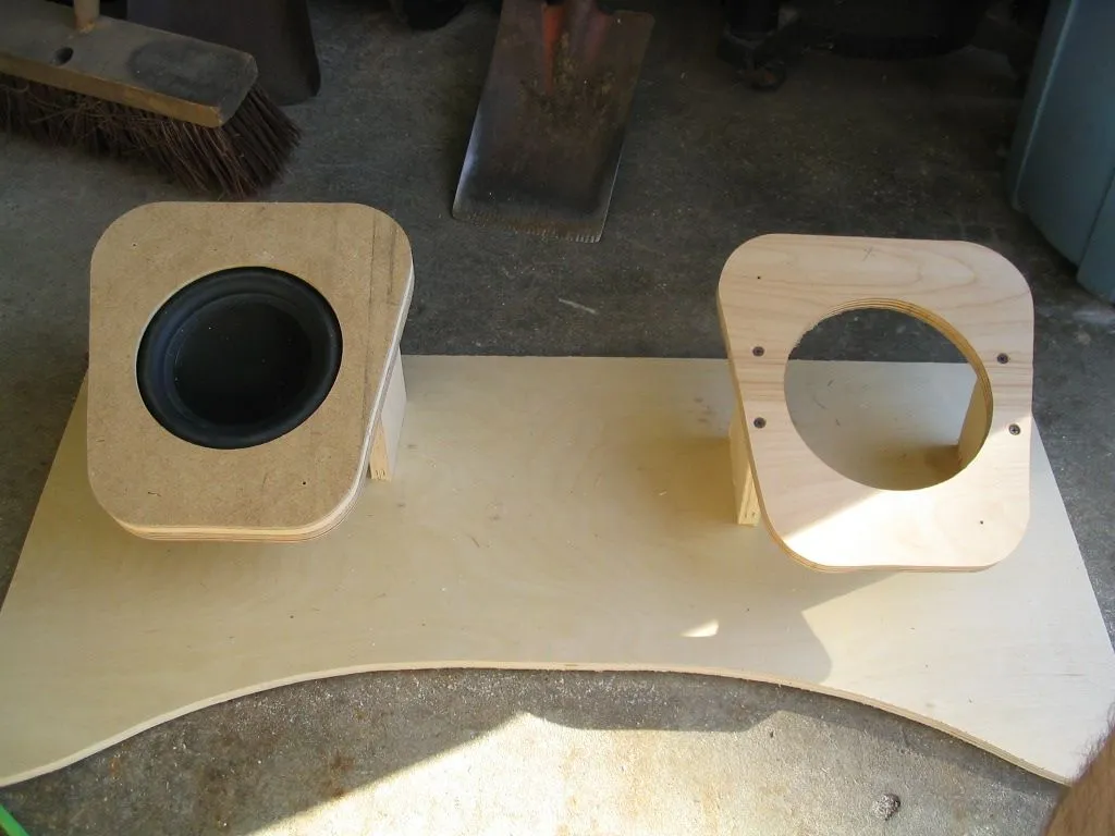

Fabrication of the new subwoofer box and amp rack began today. I completed the base and the intricate 3-piece baffles in about 6 hours. The plan is to have the subwoofers on one side and the amp and crossovers on the other. I'm not sure whether the subwoofers will fire down (hanging from the base piece) or up. I think firing down will sound best but it will cut into my cargo space more. I am constructing everything with the plan that it could go either way depending on my cargo space needs. The amp has a built in fan controller so there will be fans inside the amp rack allowing the amp to be mounted upside down if necessary.
Just so you know what you are looking at in the pictures, the base is 3/4" birch ply. The subwoofer baffle is also 3/4". The second panel is 1/2" birch ply to give a flush look. These two layers will be glued together and fleece will be stretched over them and onto a 1/2" piece that is 1" smaller all around than the base piece to form the enclosure. (It is 1" smaller so the base piece can rest on the cargo tray lip no matter which side is up. It will be covered in black vinyl. The final piece in the baffle is a 1/4" MDF trim panel that will be screwed ontol the fiberglass box to hide the subwoofer trim and mounting screws.
Man...I just had a thought. If I face the subs up, I could put the amp on a sliding drawer that comes out from the bottom. Hmm, I'll have to ponder this for a while.

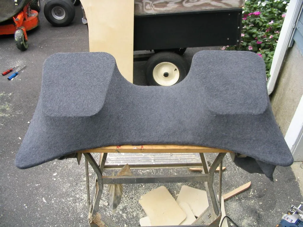

Another 6 hrs this weekend and 1 hr this evening...
Finished the woodworking. Beveled edges to create smooth lines for the fleece. Cut holes in the base board (so I could fiberglass the inside instead of the outside), and mounted the baffles.

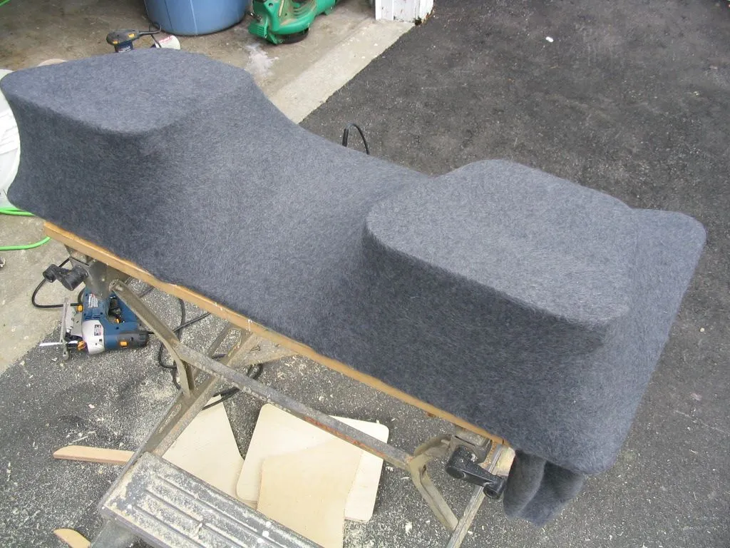

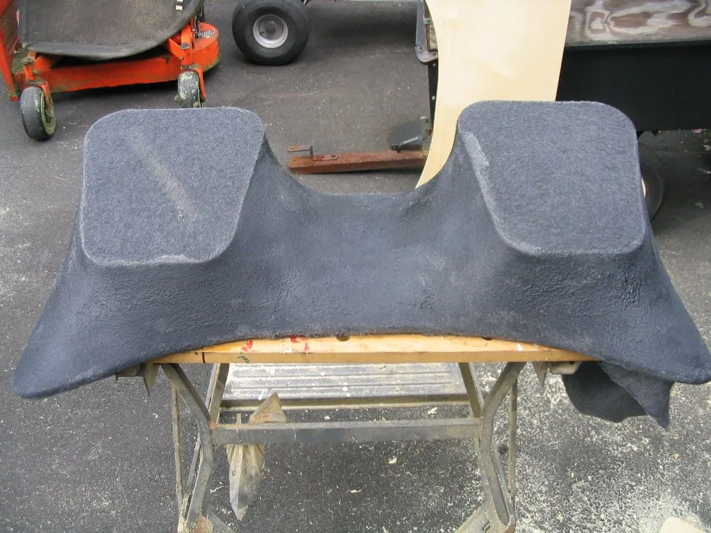

Then I got to work on the fiberglassing. Stretched the fleece using a staple gun to hold everything. Several passes were made to ensure everything was tight and there were no wrinkles. Added a thick layer of resin to the outside and let it dry. Then I repeated on the inside and used small pieces of matte to strengthen the flat sections. Today I added another generous layer of resin to the inside making sure all the nooks and crannies were filled so when I cut off the excess fleece it won't fall apart.

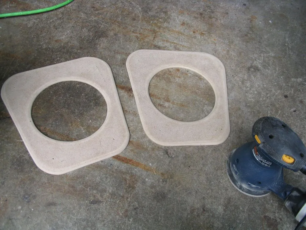

While I was waiting for the fiberglass to cure I started cleaning up the trim panels. I started with a 1/4" rounded bevel router bit. Then I used a 100 grit sanding disc to clean it up a bit. It still needs more work but I think it will turn out nice.

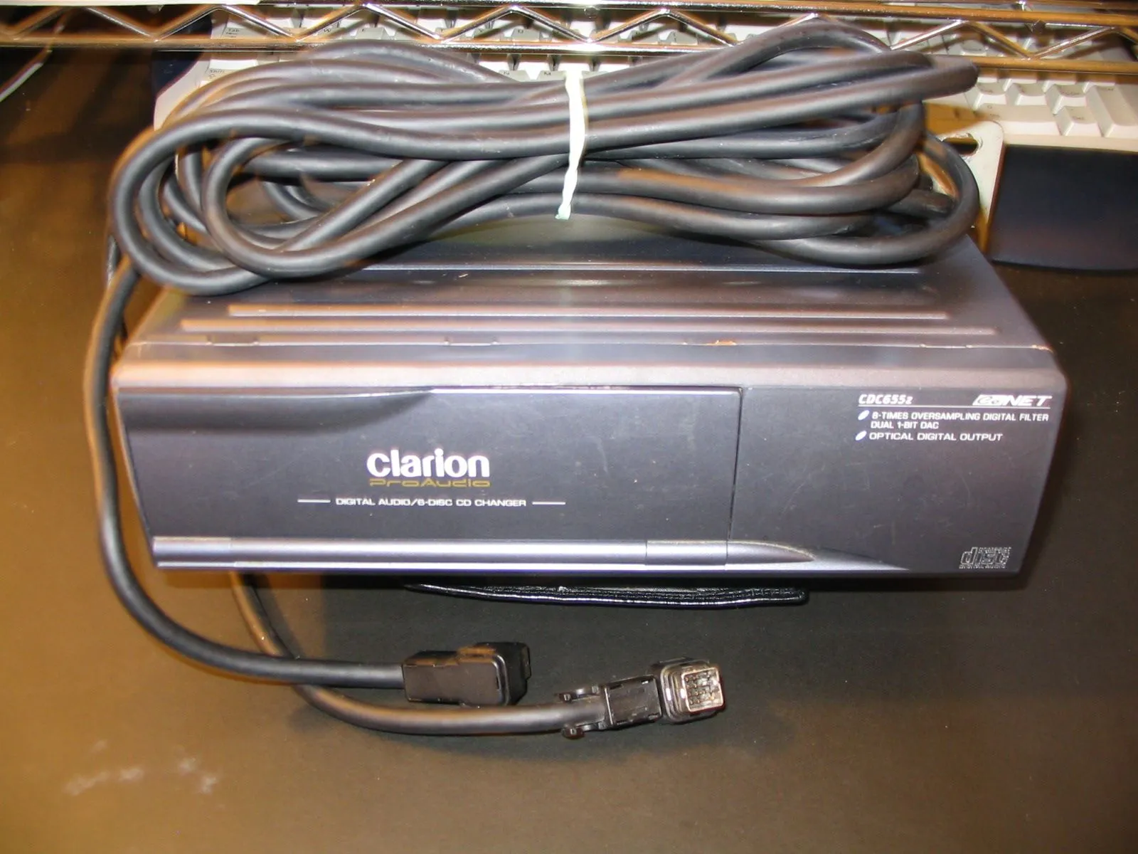

A new addition to the system came in today. An impulse ebay purchase.
Clarion CDC655z 6-disc CD changer, $45.00.
Now I won't be without my 6-disc changer. Granted I will prolly install it in the trunk but at least I can bounce between 7 CDs without shuffling through my CD wallet.
****...it doesn't work...well I can't get it to eject. It makes lots of noises. I'm going to give it a little help this evening. If I can't the cartridge out I'm sending it back.
