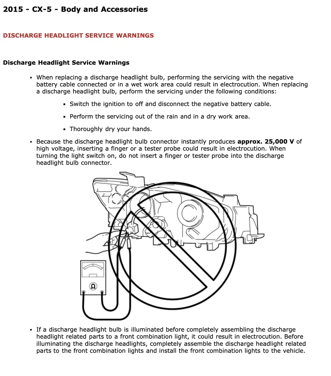

I've done it. You need to remove, or partially unhinge the bumper to access a covered bolt that secures the light at each rear corner of the housing. The rest of the bolts are unobstructed. Once removed there is a u type clip that you squeeze in and pull down, and then you can remove the bulb. You can try to remove it with the headlight still on, but you risk bending the clip and the light won't secure properly.
Thanks Chris. How did you remove the plug attached to the back of the bulb? I'm alittle apprehensive about twisting it too much I can feel it move the headlight. When I've done things like this in the past the headlights are fairly stable because they don't turn. I just don't want to damage The adapter system.

That connection normally pulls straight off. I think passenger side one I could without removing the headlight assembly. Driver side I might go through the fender liner area. I don’t like removing bumpers if I can help it. A few bad experiences with loose fit on other vehicles after reinstall.

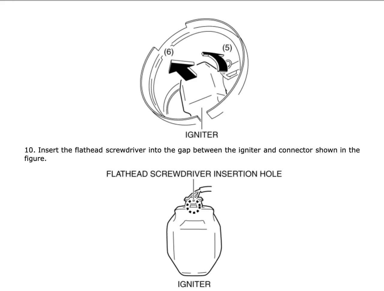

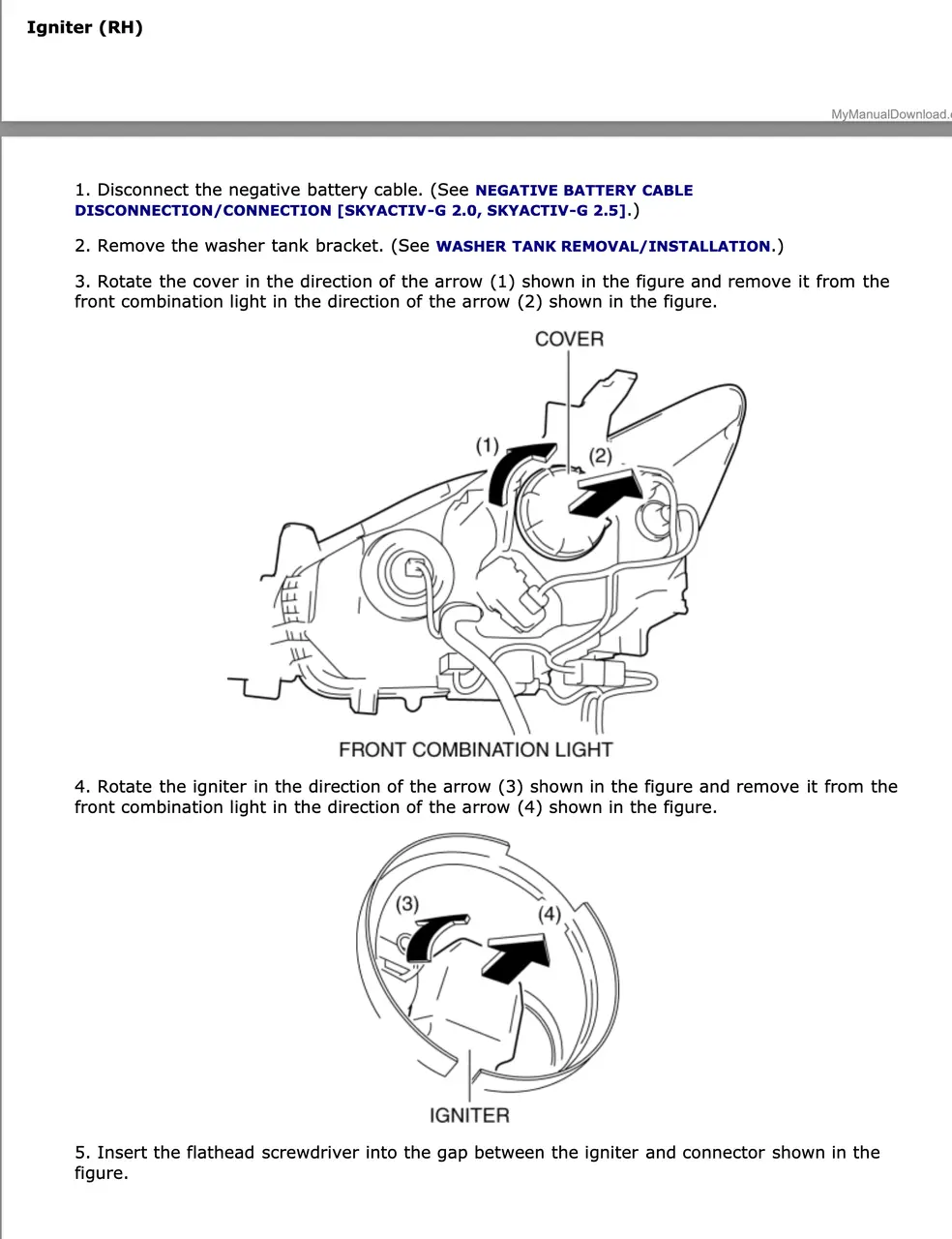

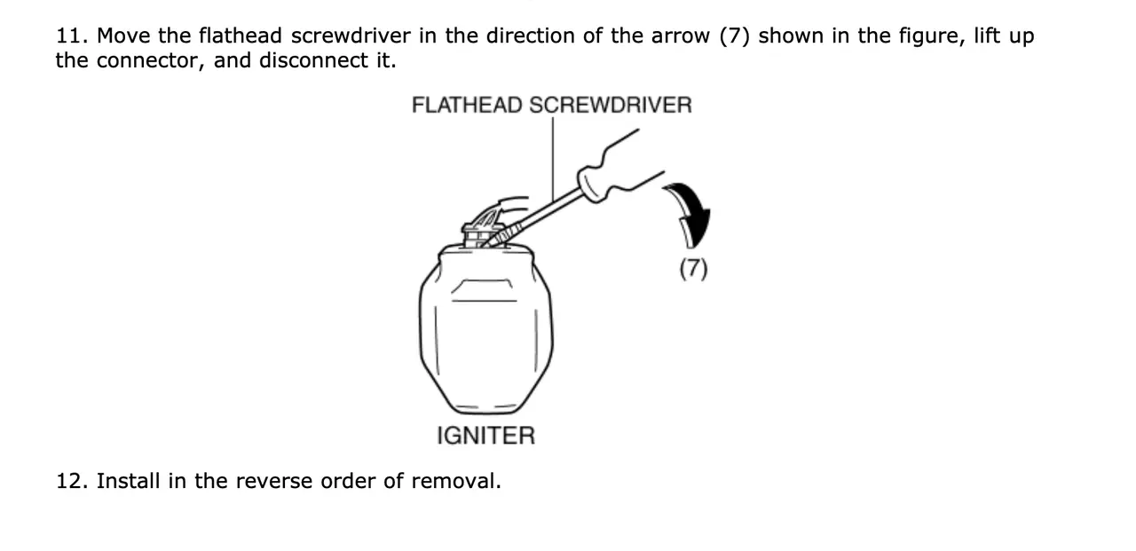

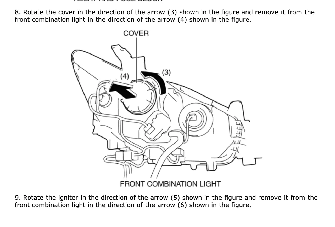

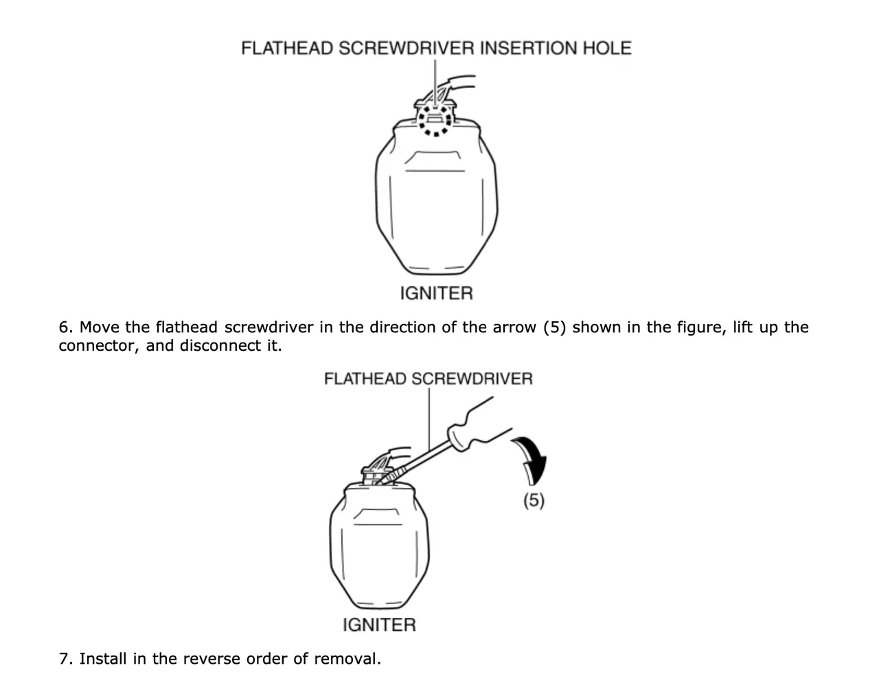

The silver "connector" is the HID igniter. To remove it from the bulb, twist firmly to the left and it will pop off. There are two tabs on the bulb that hold it on. The igniter has spring clips that hold it to the bulb.
If you try to just pull it off, you'll break something.
@njaremka Thanks! It's been a few years since I changed in another vehicle. All of my vehicles have HIDs too. I just remember it not being a big deal to get that off the bulb.

I just completed the replacement of both headlights on my 2016 Mazda CX-5 with adaptiveheadlights. I strongly recommend removing the plastic wheel well liner for the replacement of the driver side headlights as it is hard to reach and the liner is only heald in by a few bolts and tabs that can easily be removed as opposed to the awkward arm angle achieved from removing the fuse box. Other then that I followed the manual shared by Kedis82ZE8.

Yes, I just used a flat head. You don't need to take it all the way off just enough to get your hand in I took off all tabs and bolts but not the other layers holding it on
