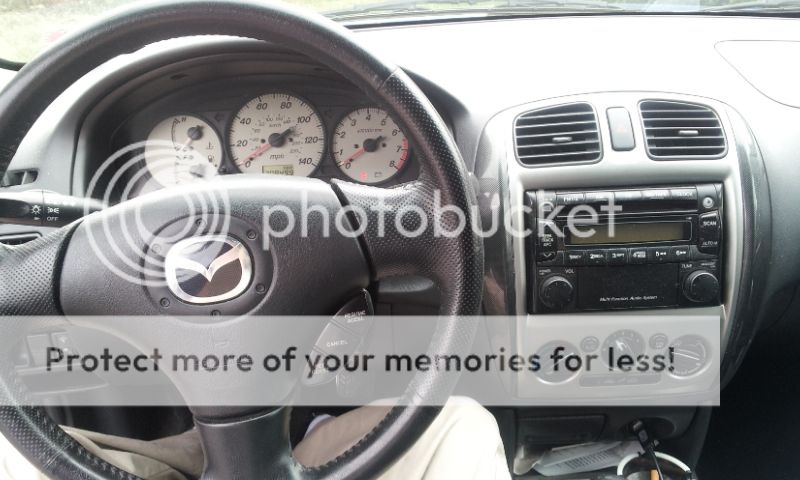

Some day time pics. Do you guys have the radio controls on the steering column?
No we have Cruise Control buttons there, and we never got the climate control as an option either. The buttons on the right side of the stereo are different than the USDM Protege.
Oh yeah I see now... I miss cruise control though!!! Would rather that than the stereo controls!!
