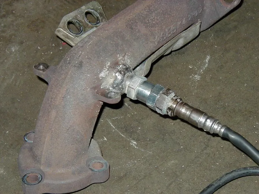

This is what the non-fouler set up looks like. I had to weld one non fouler in cuz I stripped out my 02 bung threads. Don't ask. But this was 5.99 at Checker and took very little time. The only extensive process was drilling out the fouler that the o2 sensor goes into with a 1/2 inch drill bit. I also have the corksport exhaust and I love it.

u buy 2 from autozone. part number 42002 (i think) red package by the company "help"
drill one of them out so the o2 will screw in all the way.
put the drilled one on the 02 sensor, then the other one screws onto that fouler, then they both screw onto the downpipe and you will have no cel light.
I tired it with one and the cel light came on. I put 2 on and the cel light went off after 1 day.

i will try that first. The o2 sensor should just unscrew and i'll plug the new drilled out non fouler into it and the plug it back into the o2 bung. is it that simple?
well i tried the spark plug non fouler method and had no luck. Then i tried the mil eliminator method and had no luch. After i reset the the car with the negative terminal removal the light stays off for about an hour of driving. After that it comes on. Do ya think i need the new o2 sensor? thanks
yeah used them both. I guess my o2 sensor is broken for sure because i used both non foulers and the mil eliminator. so i guess i'll have to get a new o2 sensor
