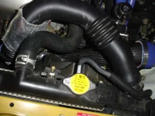

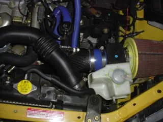

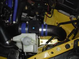

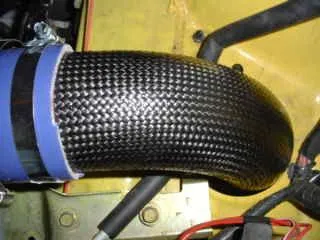

(attn) (attn) SUCCESS!!! (attn) (attn)​
I installed the tube into the BPV tube, and there is ZERO stalling/stuttering, and no performance loss. On top of that, I'm not sure how Perrin does it, but the way I do it, the portion of the flow director that is outside the intake is larger than the inside, so it can't be sucked into the intake.
Here are pics of it installed! One of the pics shows the intake as an SRI, and the other shows it as a full CAI. Do you guys think it is short enough to be an SRI? If its not, I can trim a whole bunch off, it would just take extra development time to figure out how to hook up the BPV to an even further away fitting.
Anyway, enough of my talking- here are the pics (excuse the grungy air filter, you guys will obviously get a new one)

Oh, and a quick note about the coolant overflow tank- there was no drilling required to move it there. There was a bolt that was aparrently holding nothing sitting right where the tank needed to be, and it was the same threads as one of the holes. So, I made the love connection between the two and it holds very strong.
