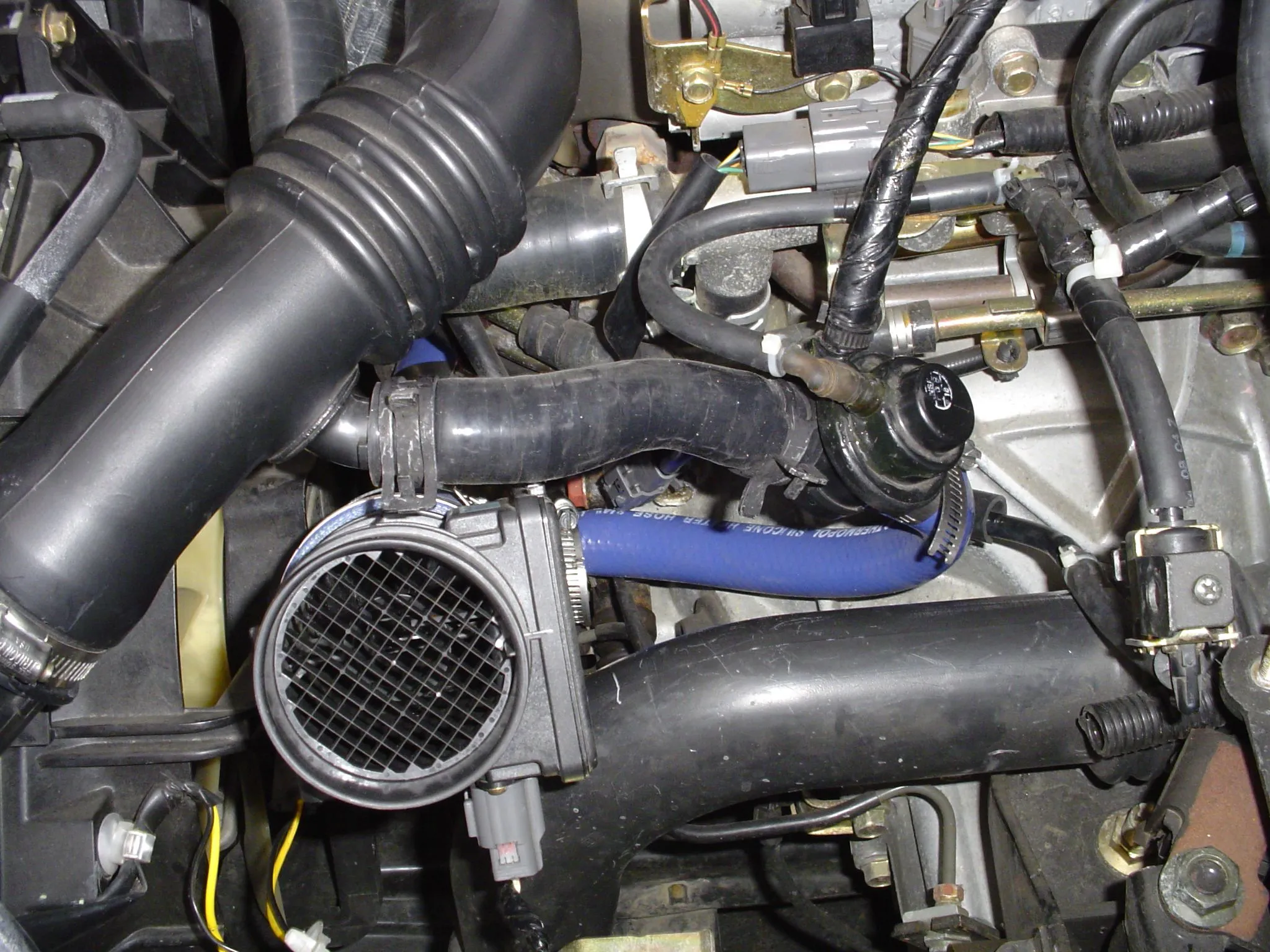

Sorry guys that I have been so hard to get a hold of- I was taking finals. The intake is designed to be used with the stock longer bpv hose, because I know that the vacuum source line isnt long enough to use the short hose. I didnt mean for my pics to be the ones that the installs are based off of, because I broke my bpv before.
The long rubber hose is supposed to bend 180 degrees from the BPV outlet to connect to the nipple. Its supposed to kink a little bit, but it isnt supposed to restrict airflow at all. There are two possible reasons for this- 1. I installed the BPV recirc nipple too low (or high) on the SRI. This is entirely possible because each nipple is placed by hand, and I could have made a mistake. 2. The hose I sent is for some reason not as high of a quality as it is supposed to be, causing it to either not bend enough or kink too easily.
I think the best thing to do is for me to send you another SRI, with my actual BPV hose (don't worry, it will work with the longer hose on the stock IC pipe). PM me with your adress again, since I don't have your mazda forums name tied with your adress.
If it turns out that the nipple is in the wrong location, then I will also send a corrected SRI to the others who purchased an SRI at the same time, since I usually make them in batches.

Alrighty guys, sorry that I have been impossible to get to this week- its like the worst week of my life, thanks to Notre Dame's idea of a tough final. Here is a pic of what the BPV install should look like. I realize that I probably messed up a few intakes as far as nipple placement is concerned, and have already started making replacements for everybody that I think was affected. Those people will be PM'ed in a few days and everything will be taken care of.
An important tip- the BPV hose will fool you. If it seems like it won't bend, or like it is touching things, you actually need to trim like an inch off of it. This lets it bend easier and picks it up off of anything it touches.
I appreciate everybody's patience in this matter- it wouldn't be a new business if there weren't any bugs to work out, right?
** Warning: its a big pic, so 56K, sorry! I wanted everybody to be able to zoom in and whatnot.
