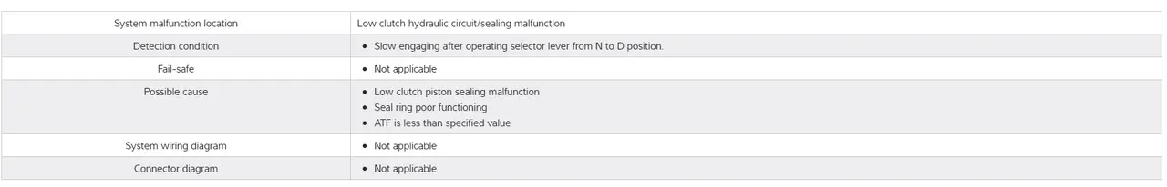

Hi all, time to update this old thread!
It's been a year, and my problems mostly went away for a long period of time, and have continued to be nothing more than a pretty minor annoyance and the car operates just fine 98% of the time.. So I've just let it ride.
Two days ago I suddenly started having a new issue where there is a hesitation sometimes occurring after stopping at traffic lights or Stop signs. Again, still just a minor annoyance at this point but I decided to get it checked out again.
Took it to the transmission ship this morning, and the car is now displaying two codes that it was not before:
P2855 Low Clutch Hydraulic Circuit Failure
P2855 Low Clutch Piston Sealing Rings
They're saying the transmission should be replaced.
Just posting here because I don't know a lot and so I'm just asking if this sounds reasonable.
Thanks again.

That is a very specific code. The TCM can detect through knowing how long the Low Clutch drum takes to fill vs the pressure switch tripping that the hydraulic circuit is leaking. Assuming the fluid is full, the ONLY way to repair that will be to start and disassemble the unit and begin testing the hydraulic circuit and see if it is leaking in the drum itself, if that is the case a new drum is needed because it is welded together and you can't replace the piston. Mazda has updated the drum design a few times since the units first came out and would be wise to install an updated one. There are sealing rings on the input shaft that can also leak. The Low Clutch is the input clutch for gears 1-4. If you were at a Mazda dealer the diag is very short, if the fluid is full then it needs a transmission.
