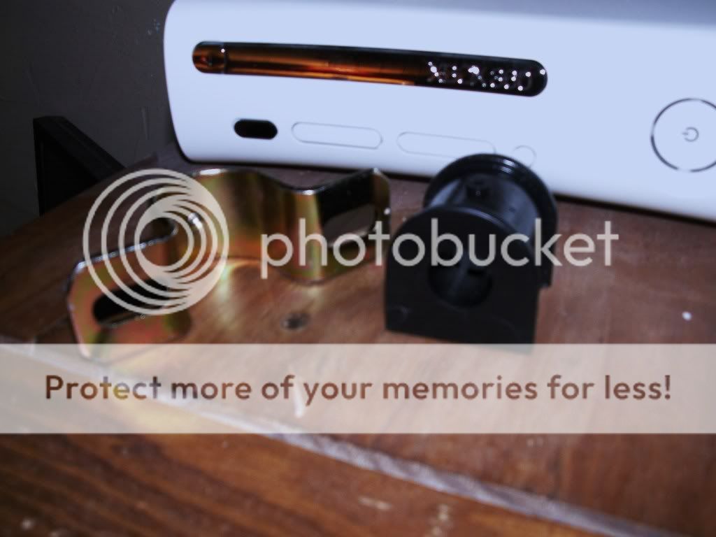

Okay I just found the slit in them!! Dude thank you. Here is a pic: ( dosent even look like it has a cut in it)

I haven't tried unscrewing from the sub frame to mount the brackets yet
