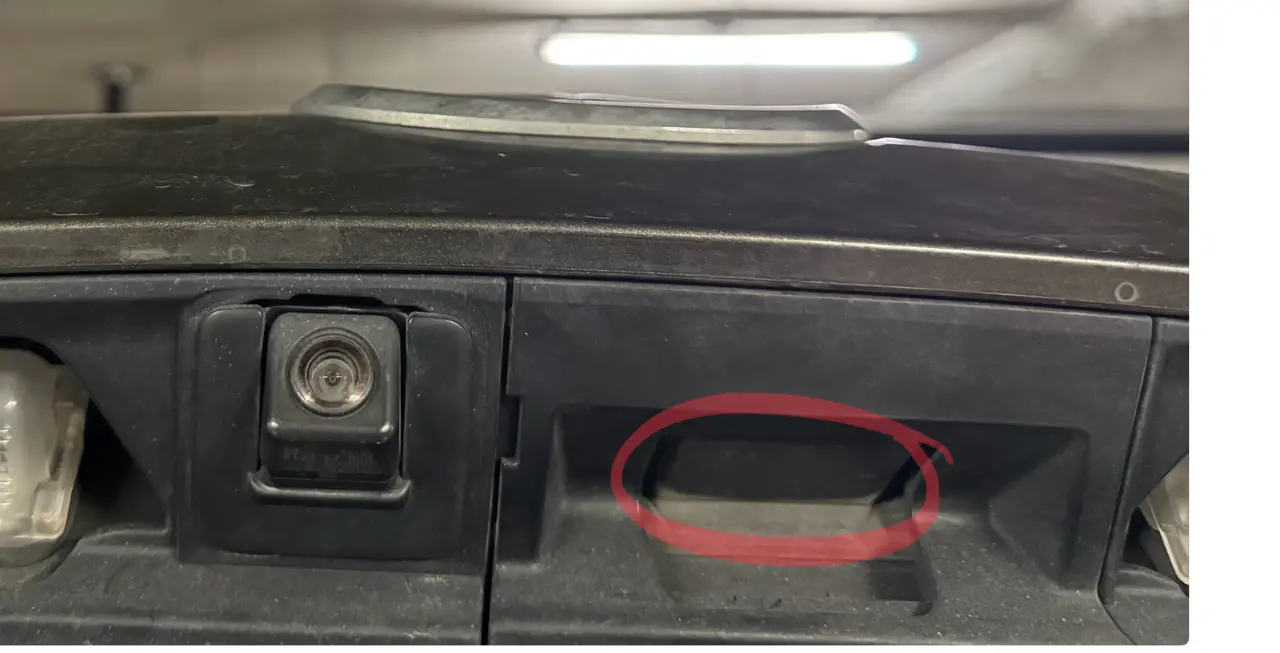

Help please. I’m going camping in my CX5 2018 which has a power lift back gate that I hope to leave open at night as I have an SUV tent. Any advice on how to protect my car battery from dying? There is a tiny light on the powerlifting button that could be a problem?
Once I did trigger the latch on the power lift gate with a carabiner, but then could not get the gate to re-close…. I finally did by playing around with the keys etc., but I cannot recall how.

there is a small button to unlock the latch on the liftgate. Look closely as its tough to see.
Also on the fob there should be one.
That should help if you lock the latch when the liftgate is open. Try it out see if it works how you need it to work.
Locking the latch mechanism is the easiest way to make the car think the liftgate is closed even if its open.

Thank you for all the ideas - I’ve got it! You trigger the latch closed with a screw driver…make sure the latch is fully closed. Check your dash. Then to open, push the button that opens the powergate, when it is normally closed (not the one you use to close it when it’s fully open), but the one on the outside as shown here. So makes sense…if the car thinks it’s locked…unlock it!!
Thought I would post this to help anyone else…or when I forget 😀
