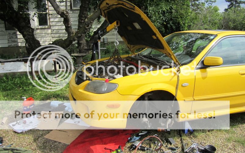

Will update with pics of progress tommorow, hopefully will have completed clutch and flywheel tomorrow. Exhaust will be Friday. PSYCHED!
Thanks for the "winner winner chicken dinner!" @Midnight
Mounts are done already haha its so stiff hahaha, clutch/flywheel should go quick because I've pulled another transmission already.
Havent got a chance to drive it yet, just finished with them today. I got a piece of shop towel stuck in one of the fuel lines in front of the rear mount while i was trying to keep sh*t out. Its the fuel rail line I'm hoping i can disconnect it higher up and start it up tomorrow to free up the paper towel :s (I hope it comes out clean)
That rear mount was such a b**** I spent 3 hours trying to get the harness shroud off. I ended up using a 36inch Dominator Pry Bar and a hammer beating on it through wheel well near tie-rod end and from above to break the plastic around the bottom nut. So now its re-attached but only with one 10mm nut (like it should have been done from the factory)

So I got caught with pants down with the mother of all thunderstorms, got I need a garage. The trans is out and very exposed :s

XD time to wrap up the tranny.

Are you pulling the whole motor to swap tranny's or just bracing the motor with the hoist?
Just bracing the motor from above with the engine hoist to hold it in the exact position it was in so that the tranny lines up nice, was that a +1 for my overkill stage 3 or coilovers should be next?
Ahhh Houston we have a problem. I disconnected my clutch slave when I pulled the trans, buttoned it up and I have no clutch pressure. I dont know how to bleed this system. ANYBODY please.
There is a little nipple near the o2 sensors clips are. You have to bleed it from there. I will try to find a pic to assist you.
Had to bleed the line 17 times lol to get clutch feel back. So 88 duros are alright might go for some 70 duros, but i think the exhaust is a bit much. I might sell the cat back down the road theres alot of percussion vibration when on the gas. The F1 stage 3 engages around 1500rpm with
minimal effort.
