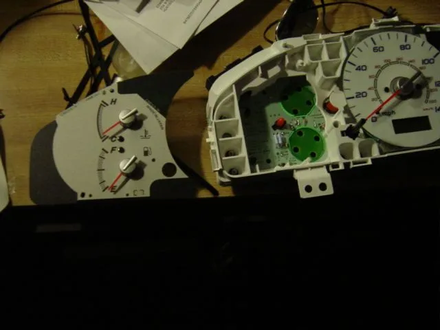

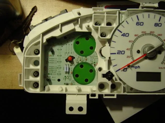

For those of you who have broken either the temp or fuel gauge needles, here is the remedy, get a protege gauge cluster from a junk yard and replace the whole side with the fuel and temp with the one from the junk yard.

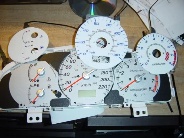

i just bought this one from the dealer for $540US and i put 44 miles on it before i figured out that i could switch it out, I want to sell it , its from a 2003.5 mazdaspeed , i switched the good temp and fuel gauge to mine in my car so this one has a broken temp needle. I am asking $350US SHIPPED AND I WILL ALSO THROW IN THE PROCARPARTS REVERSE INDIGLO GAUGE OVERLAYS(READ MPH)ALREADY CUT TO FIT ONLY HOOKED UP FOR ONE DAY. THIS ONE READS KM/H NOT MPH ANOTHER REASON IM SELLING IT, I DID NOT CHECK IT BEFORE I BROUGHT IT HOME FROM THE DEALER. IT CAN BE FIXED WITH ONE FROM JUNK YARD AND JUST CHANGING THE TEMP/FUEL OVERLAY TO THE MAZDASPEED ONE( THE OVERLAYS WILL HAVE TO BE CUT OUT ). PM ME FOR THOSE INTERESTED. THANX:)
