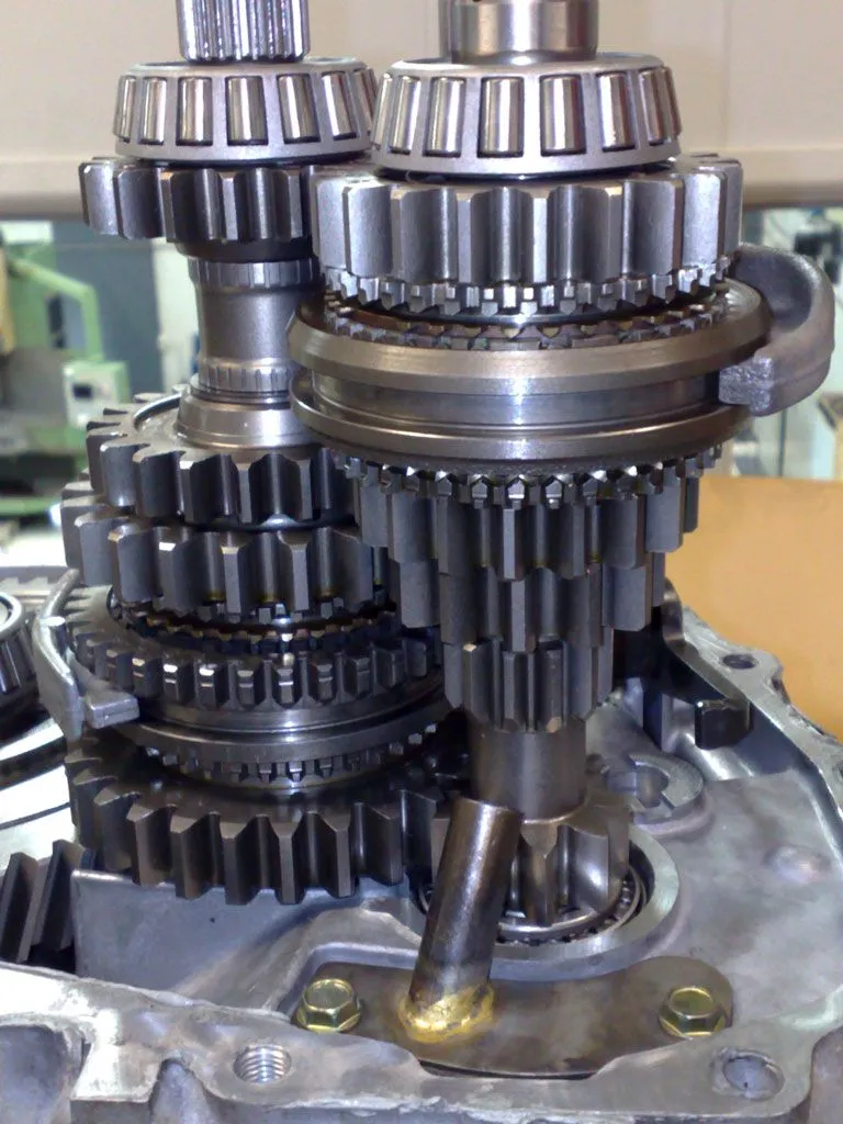

This is the PAR Gearset:
This picture is of the very first generation Mazda G-Series gear sets. They have since been updated with the very latest tooth profiles and many improvements upon the continuing feedback from many of our customers, from both the street and racing community.

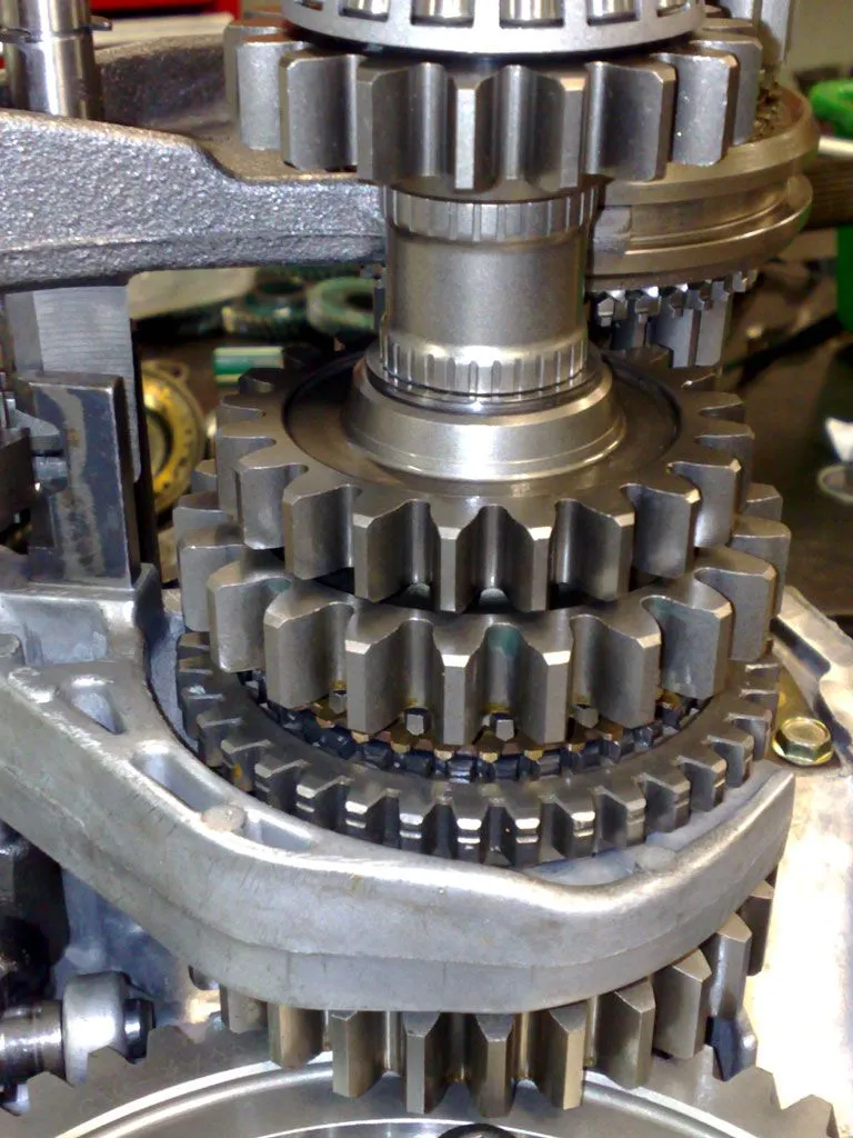

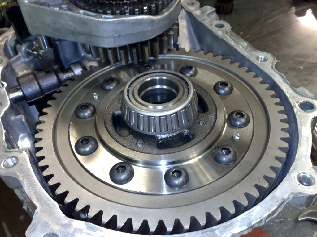

Here are photos of the very latest synchromesh engagement gear set version which was just assembled yesterday.
